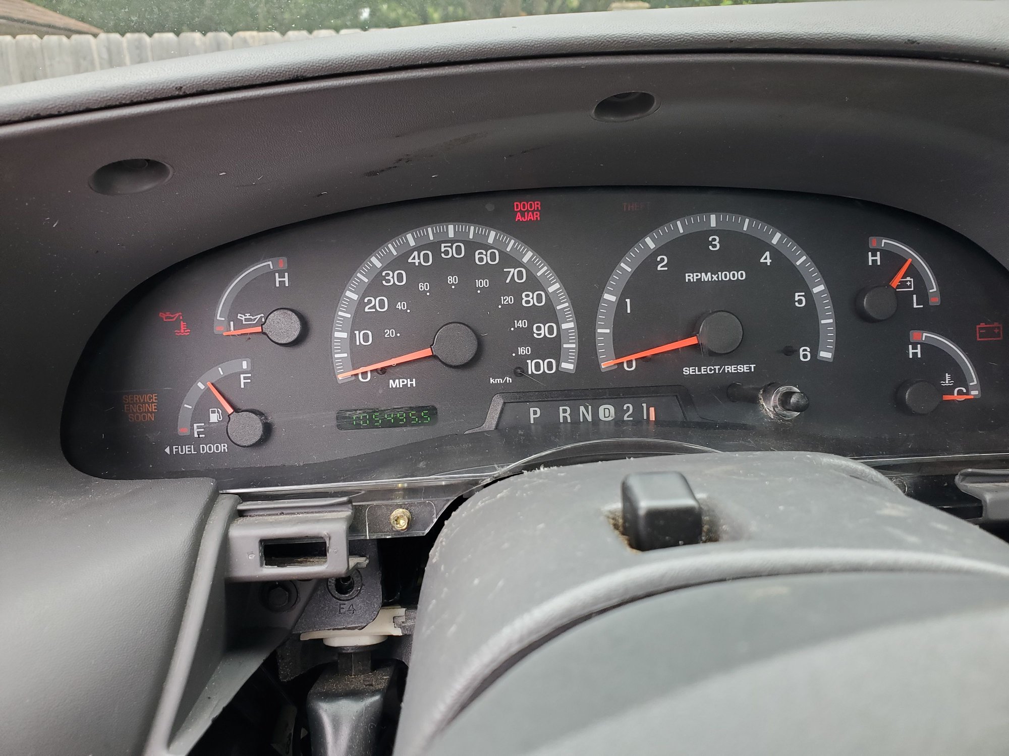

Everything was working fine, till I decided to 'fix' intermittent odometer [105000 miles], after reinstalling dashboard cluster.
it cranks, but no start - unless I use starter spray fluid.
  • removed cluster to fix cold solder, then all the problems occurred.
  • removed pos battery, waited 24 hrs, reconnected started but will not restart.
  • thinking I did something to dash cluster, installed a used replacement
  • all fuses check good
  • replaced fuel filter, while fuel filter was disconnected attempted to see if fuel pump was working. Key ON, no fuel.
  • PATS code = 15, replaced OEM key fob batteries on both original keys
Additional issues: No power windows; key fob door un/lock work; No emergency with red button
My thoughts: transceiver died; perhaps ignition switch: fuel pump went out with no warning;
This is dash presentation. Theft light gives a code of 15. Makes no sense as it's with oem key fob.

Success! Well partially. re-installed my 'repaired' cluster and voila - truck started!
But, while gauges gave the appearance of working, i.e., gas, battery, odometer, tach before I started the truck - they stopped once the truck started and was running.
I guess my next step is to attempt to drive the truck to a mechanic shop and have them install and program the replacement cluster
