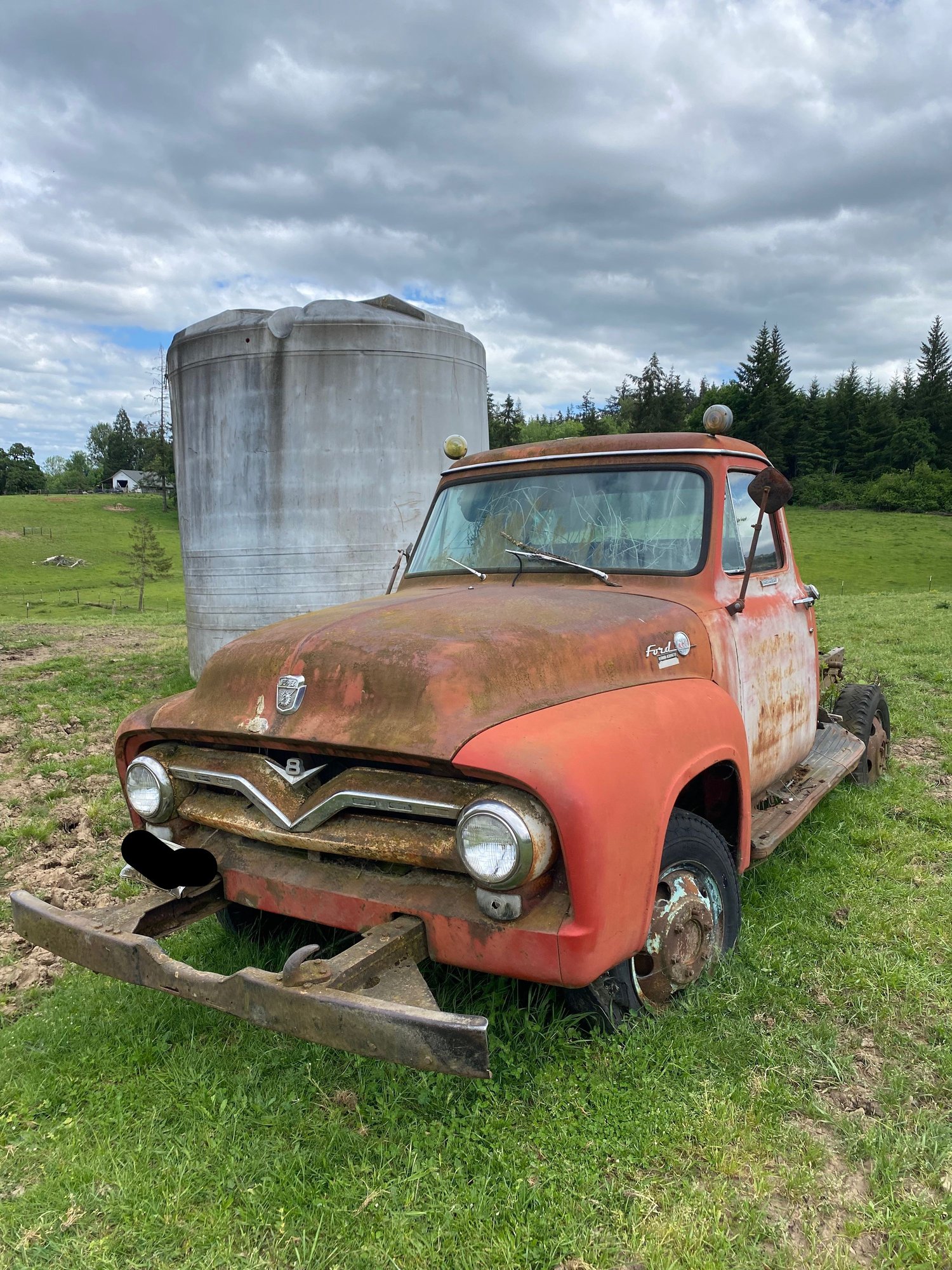

I first posted about this truck in May when I first found out it may become available. It likely has some problems, but I’ve reached a verbal agreement with the owner to buy it, if he can work out some of the title issues. Here she is:
Are the six lug axles uncommon? I thought they were standard on the F250?

The six lug (6 x 7.25”) pattern was standard on the F-350. This axle was substituted for the earlier 5 x 8” pattern axle during the latter part of 1953. We’ve had very few of these trucks emerge from their resting places over the years. Quite a few years ago Owen (1952henry) found one of these bare front axles in a yard and sent its good axle shafts to a prior member for his M354. I tried to buy a bare 1954 M354 chassis in 2017 but was not successful. So, at the moment, I think yours is the only one of its kind on the forum. Stu

I don't know much about M-H's but the sheet metal looks pretty good from here. This is Custom Cab. Was it a fire company brush truck at one time? The extended frame looks like it might have been for the pumper. The engine looks IK on the outside, carb with air cleaner in place. You can see the valve cover decals and the yellow engine paint. Someone got rid of the crossover exhaust pipe and bent the driver side pipe down for dual exhaust.
It even has the optional foot operated windshield washer complete with glass bottle.
Good luck in your purchase and your pursuit of safe wheels.
