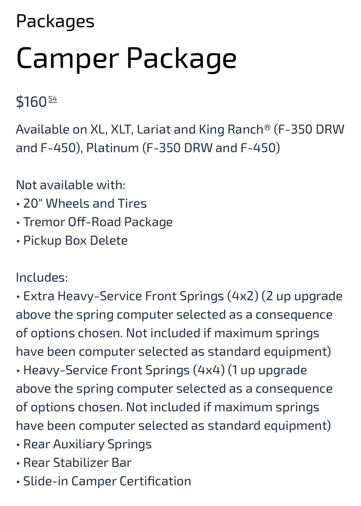

In the description above, the Camper Package is available in various models but not the Limited. I am looking at two 2024 F-350 DRW trucks for sale. One is a Platinum and includes the Camper Package option and the second is a Limited and does not.CAMPER PACKAGE
.HEAVY SERVICE FRONT SUSPENSION
If you look at the 2024 Limited build configuration, the Camper Package is not available. Does the Limited already have that included? Or is there anything about the Limited trim that makes it less capable for overall payload or towing capacity? I plan to be towing a fifth wheel at first, but maybe a truck camper later.
Thanks!

On the SRW trucks you couldn't get camper pkg with Limited because they have 20" wheels, but on a DRW, I can't think of any reason why it wouldn't be compatible. Limited pkg doesn't include anything that the camper pkg includes. Besides option weight, there really isn't anything about the DRW w/Limited that makes it any less capable.
