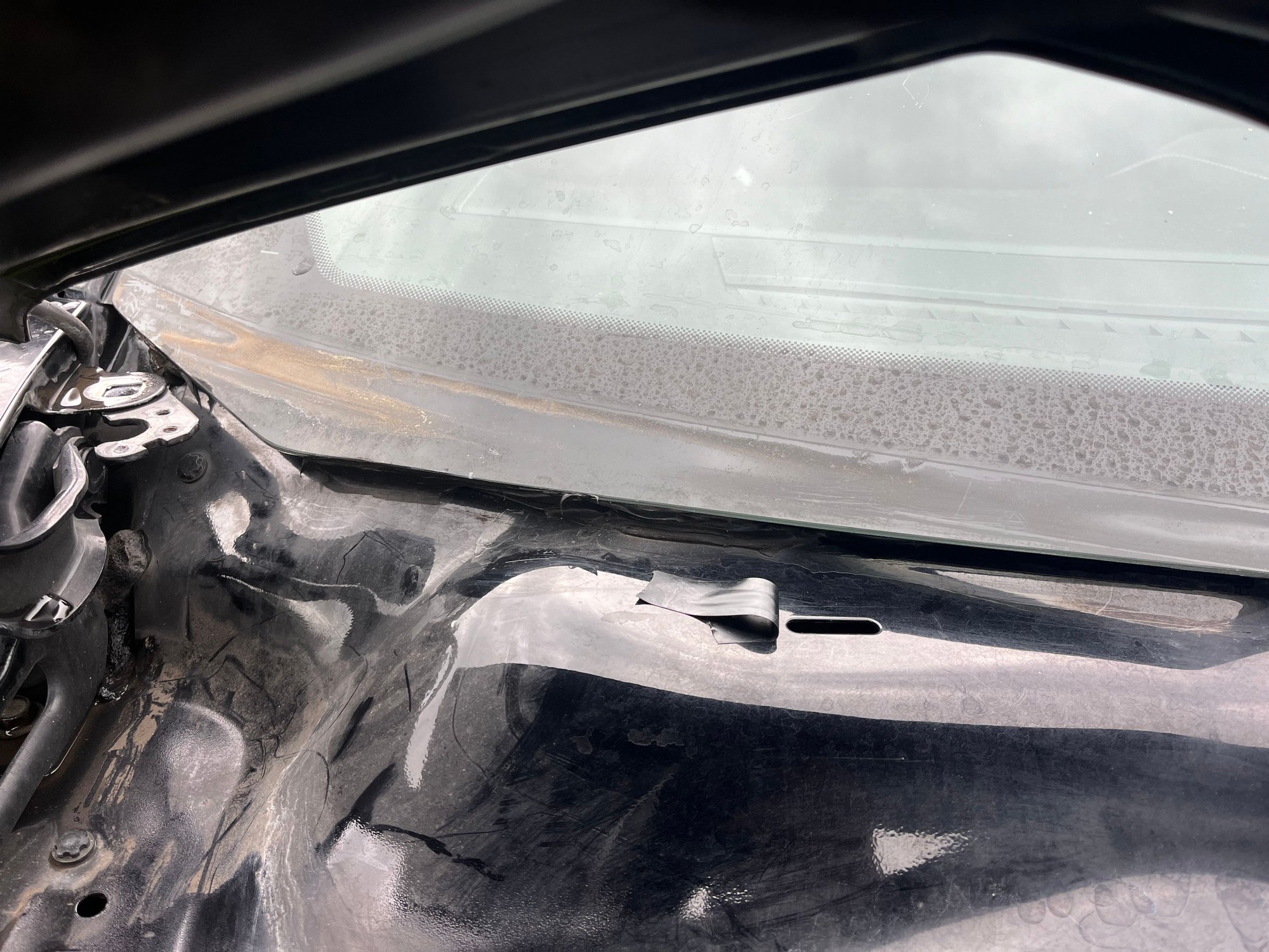

I found the leak but haven’t fixed the leak. Water is coming in from the fresh air intake. The cabin filter is soaked. Water apparently is draining through an oblong oval hole in the cowl directly above the fresh air intake. If I tape over the hole, the leak seems to stop. I’m going to read up on how to remove the air box/blower motor.

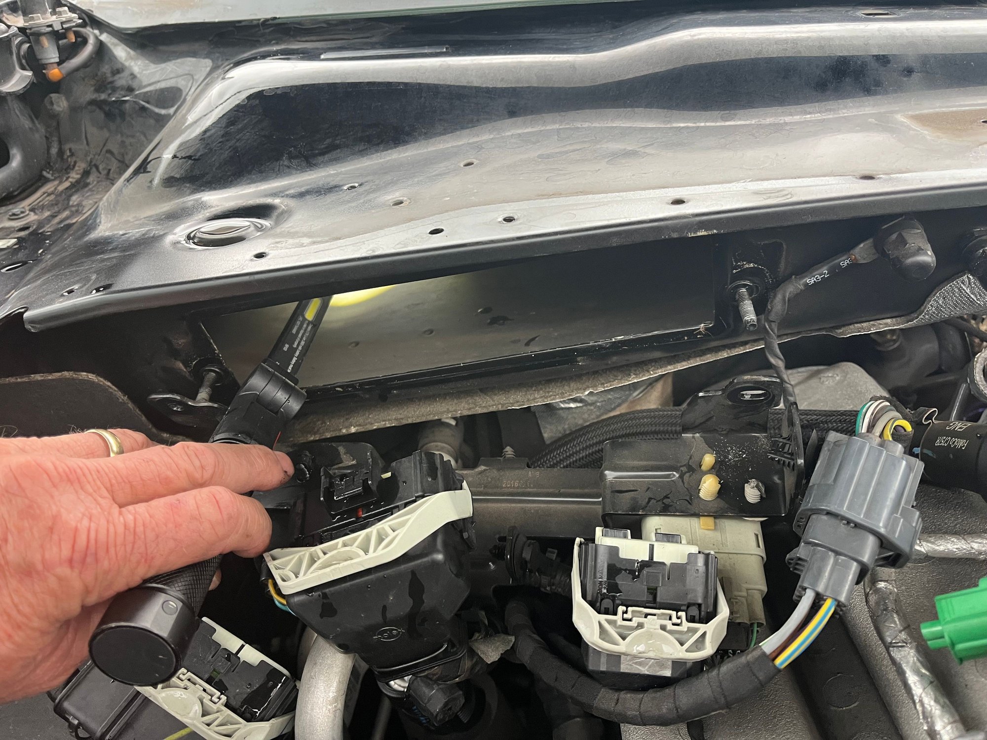

I removed the ECM from the firewall and lookie there….a wide open fresh air intake. We have had monster rains here and I think the sheer volume of water in short time overwhelmed the drain allowing water to enter the intake. I don’t think there is any reason to take apart the interior any further. I will seal the oval hole in the cowl above the fresh air intake and put the truck back on the road and see what happens.

I think mine came in the same area. The fresh air intake was highly suspect due to the heavy rains I experienced. Also mine was sitting ant an angle low on that side and the crud was built up in the drainage area. I cleaned the apparent drain holes (in the thread I linked earlier) and mine has been ok since (on that side).
