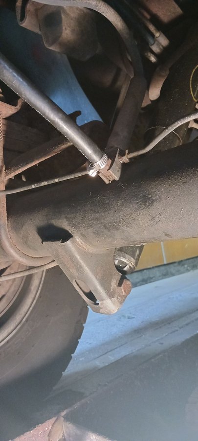

Here is an update. You all are good-- real good. I got under the truck and found that what I thought was a capped rear differential was in fact a chuck of rotted tubing and a mud plugged vent pipe.
I pulled off the old piping and went down to the auto parts store and bought a 5/16" replacement tube and put it on. I have it resting up under the bed facing the front of the truck - and I zip tied it up there so it would not fall down.
I will drive the truck this weekend to see if the leak returns. I assume that it could since the built up pressure from the plugged vent might have blown the pinion seal. We shall see.
It gives me confidence being able to do this types of projects. It was easy and I do appreciate all the help that you gave to me.
The finished project.

i hope you left a little slack in the hose for when the axle drops when you get air
