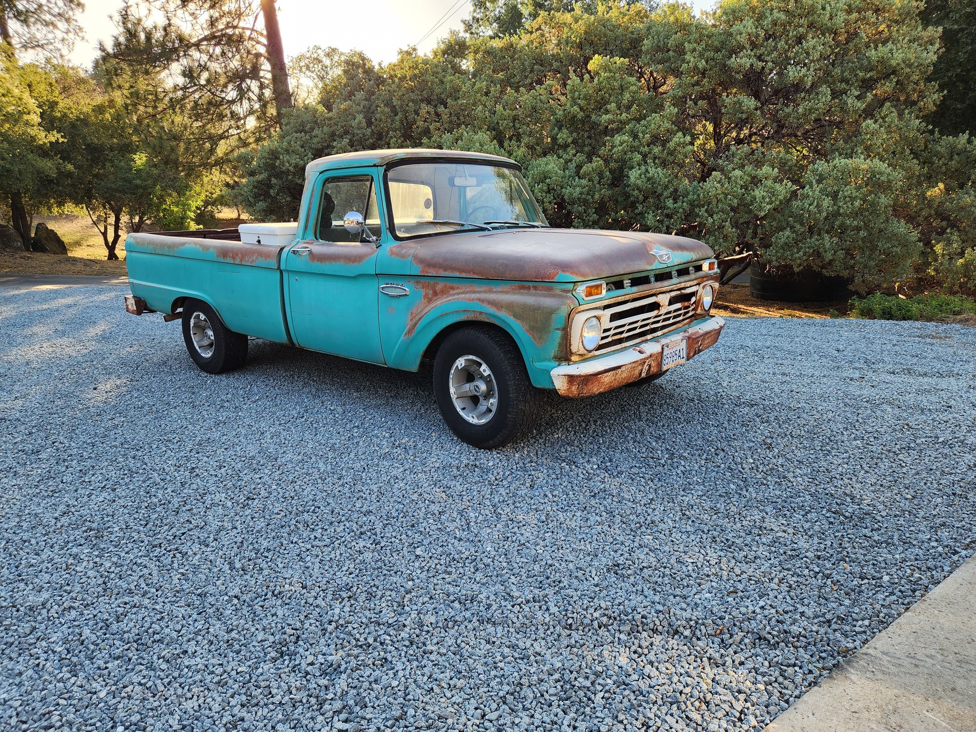

Try searching for Ford Truck rims with 5 on 5.5 235/75/15's are fine, 2wd or 4wd, P/S? Stock rims were 15x5 IIRC... you could definitely step up to a wider 7" or 8" rim, yes the 235's will be fine on the 15x6 rims, personally I like a bigger/wider tire to fill the wheel well, I have 15x8 rims on my 66 F100 w/265/70/15 tires it's 2wd, all my dents are 4wd.
