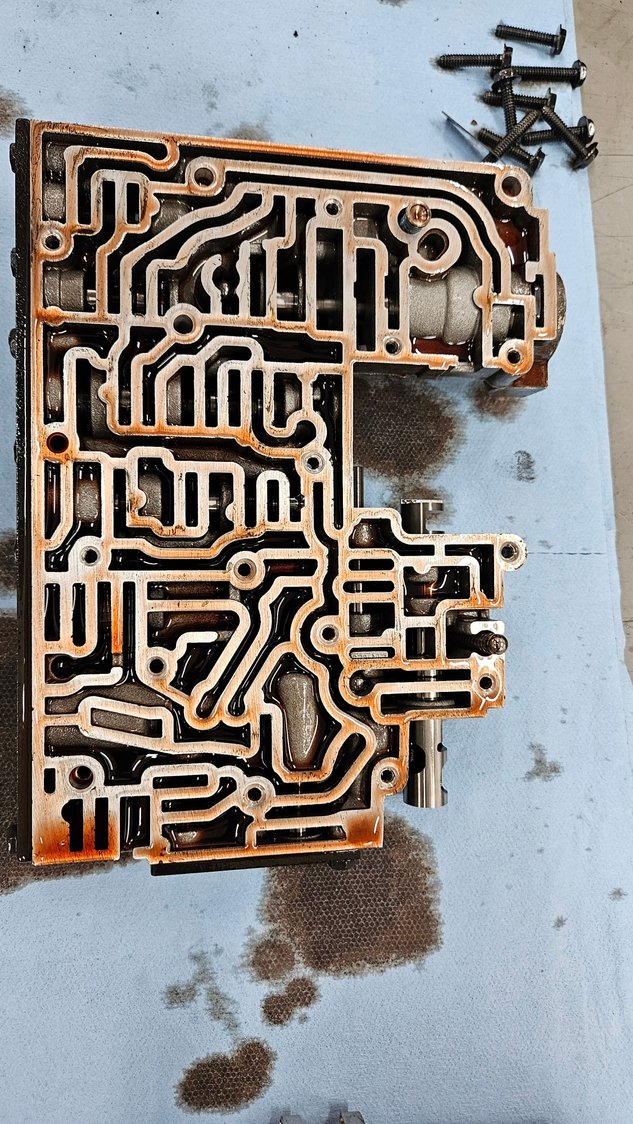

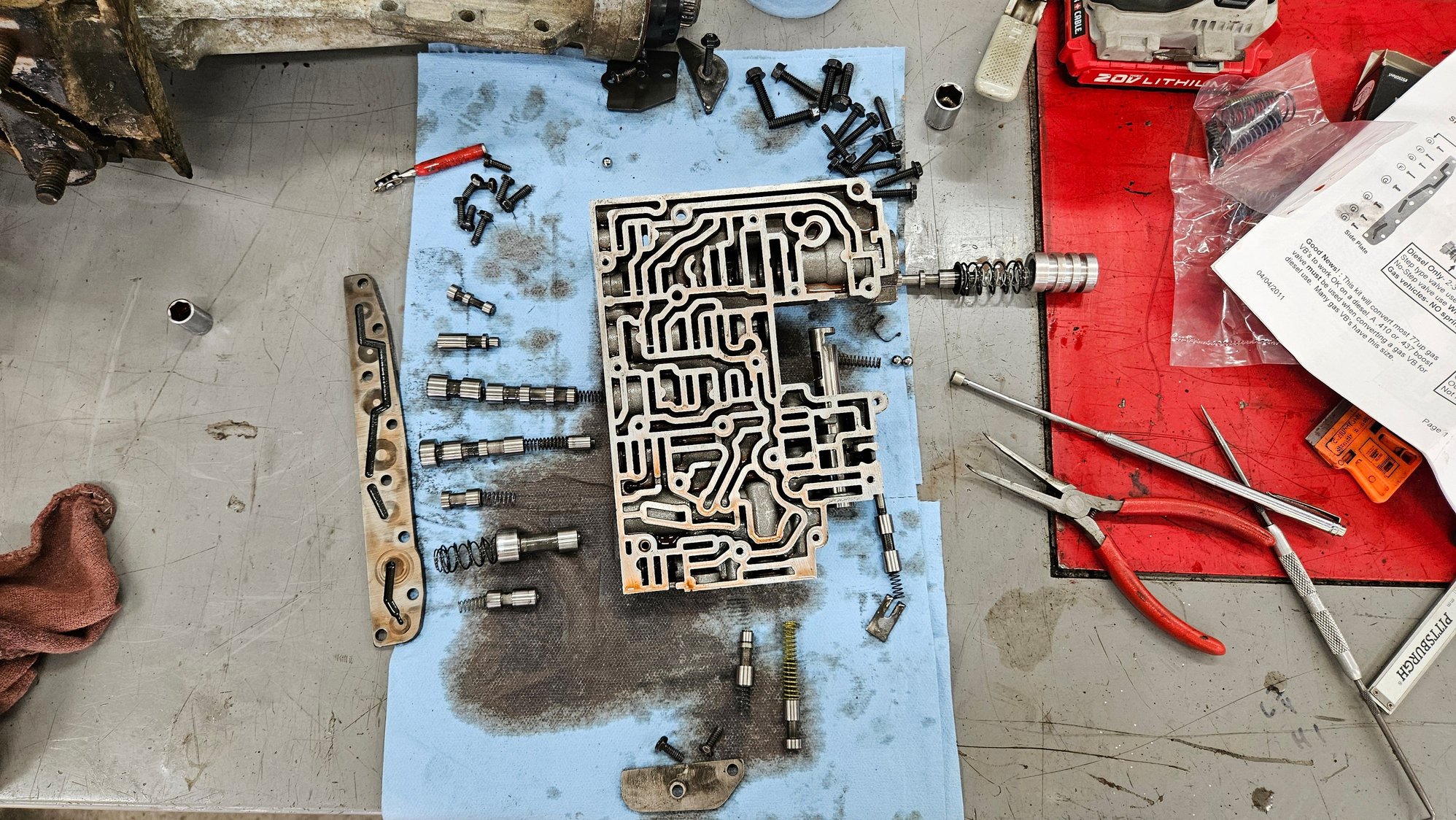

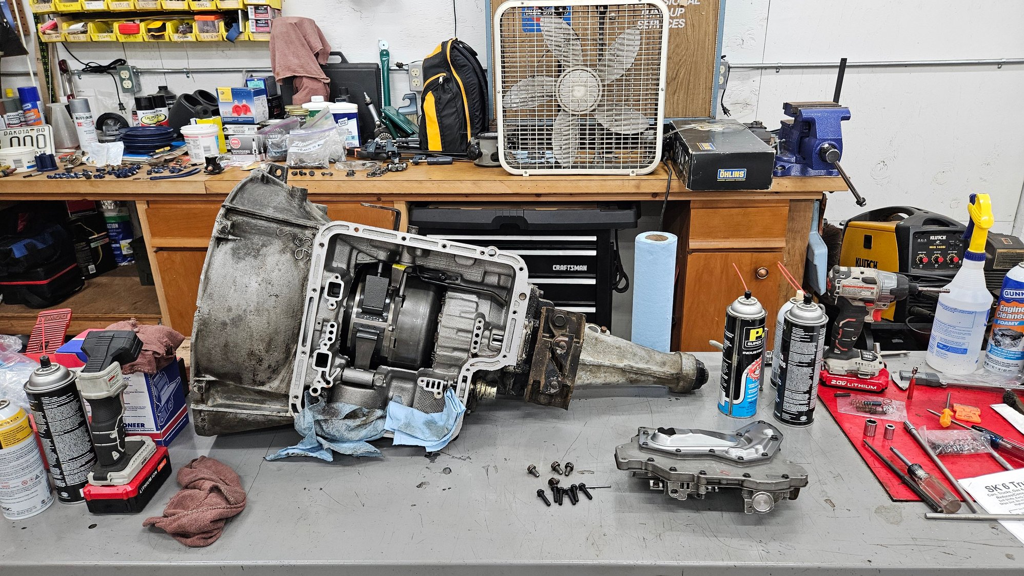

Kit is installed, there was a gasket, it didnt tear, reused it. I need to replace the shifter shaft seal so I havent reinstalled the valve body yet. Only a couple of other things to do, then I will start working on getting the engine/trans installed. Fist, I need to dig the thing out.

That dark patch on the blue rag has me worried
If the fluid looked that dark I hate to see what the clutches & plates look like
Dave ----

This is the first auto trans I have ever worked on, so I don't have much to go on. The fluid in the valve body looked nice and red, doesn't smell burnt out anything like that. Guess we will see. I bought the truck from my FIL and didn't have much of a chance to drive it before the rear main seal drip turned into flow. There was some darker film/ sediment on the valve piston covers/ plates.

It looks a little darker than I would like it but not bad and if it dont smell you should be OK.
I think it looks dark because the paper rag is soaked and the bench is showing thru it.
Carry on
