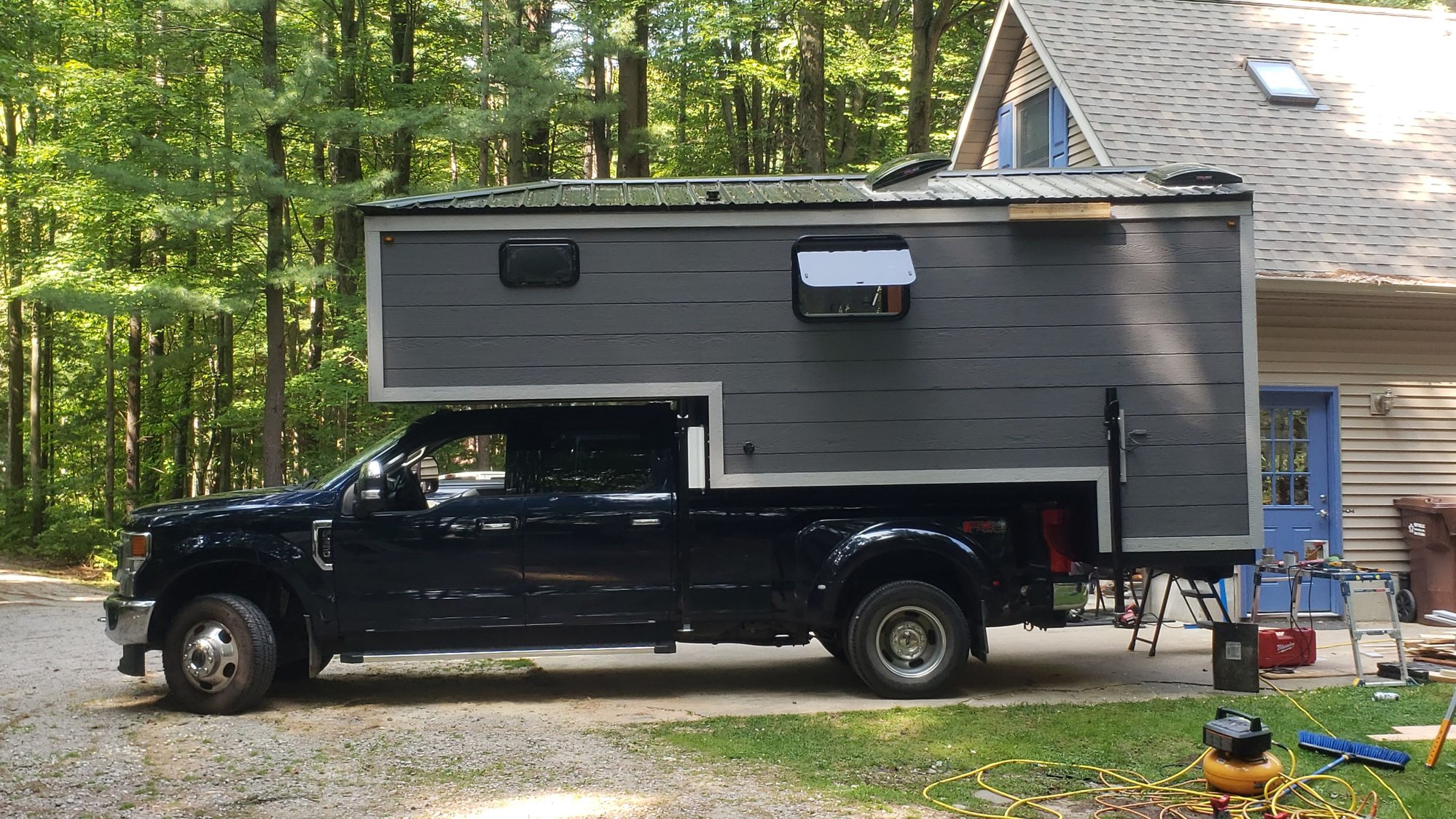

OBS460, do you have a photo of your homebuilt camper? What is the length and weight of it?
I dont have any interior photos because I was building it and my wife was the one documenting while I was building. In a month and a half I am 95% complete. Weight is unknown at the moment but it squats my DRW about as much as my 4000lb pin weight 5th wheel did. It is just under 12ft sitting on the truck. The interior length is 16ft and overall just under 19ft. The rear sits 32" behind the taillights. The entire frame is rough sawn red cedar 2x4 and 2x6. I put a metal roof on it because it's rated to 200mph the solar panel brackets are rated to 150mph. I used Owen's Corning self-sealing ice blocker on the entire roof. 7/16" force field plywood to sheet the outside, which I wouldn't recommend, wrapped the entire thing in Tyvek.
Solar setup is 8x 100w Renogy 16BB panels with a Renogy 60A MPPT solar charge controller, Renogy 40A DC to DC charger, 2x 200AH Renogy lithium batteries.
without solar or the Happijac jacks it was about $15k
Looks very solid and totally worth the 15k. You absolutely need to post more pics of that beauty and inside pictures pretty please

These are all I've got on my phone. When I return to civilization to finish the trim on the inside I'll get more.
Loft for King bed
Shiplap walls and cieling
Just installed the butcher block countertop so I had weight on it until the adhesive cured

WOW.......that looks very well built!

Thanks! I didn't want to waste my money on something commercially produced that would cost 2-3x what I could build this for. I couldn't justify spending the same amount for something garaunteed to leak and rot. I've seen the skeletons of Lance and others and the fact they use 1x and staples to hold everything together I think this camper will be just fine. I used 7/16" sheathing and the outside shiplap paneling is 3/8" thick. The rough sawn cedar 2x4s are 1.75" so my overall wall thickness is 2.5". I have plenty of room inside for my wife and I plus our 2 small dogs.
