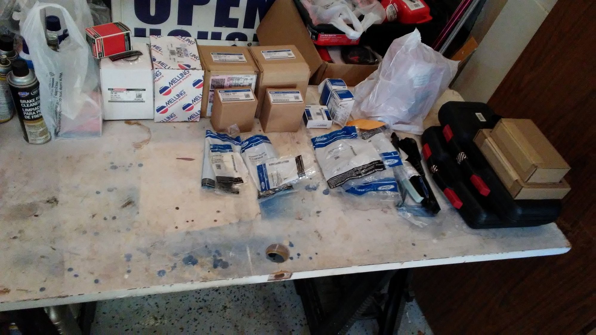

With regards to the followers, I wasn't sure what to expect either so I thought I would have more than needed.
Not really since I ended up using it all. I suppose I could have just left the valve train alone & lived with the ticking & loss of performance but I'm just not wired that way.
I didn't make any videos of the followers I pulled since they were VERY similar condition to FTML's video. (and I don't really do the whole make videos of myself thing) The needle bearings were in various conditions. Some seemed ok while others went from "that's a bit loose" to "holly crap". I did mine around 40k miles ago so it's been a few years & at the time all the followers & tensioners (old school engines these were the rockers & lifters) were not too expensive so I just added them to the list.
the pile-o-parts & special tools
