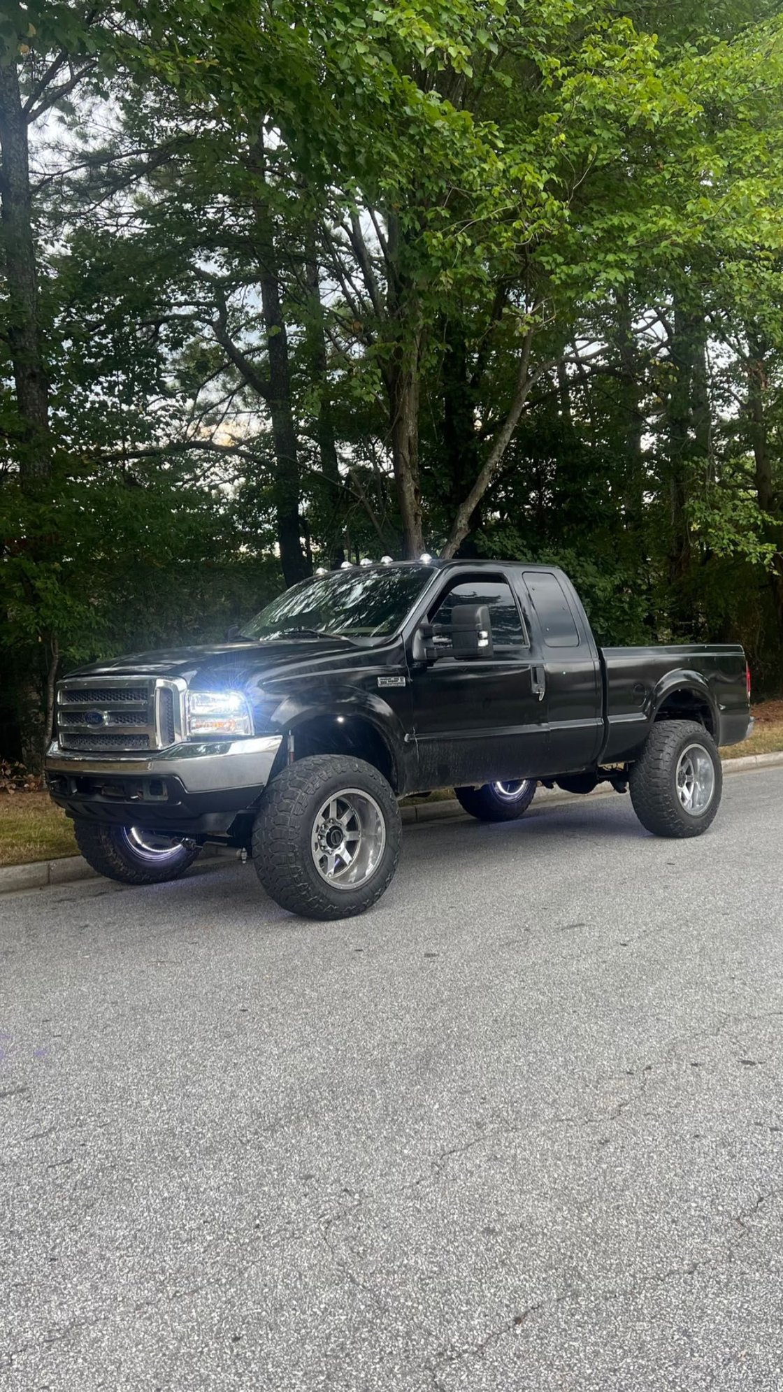

What’s the torque spec on a 2000 F250 wheels? Are they the same for aftermarket wheels?
These are the wheels I have

I use the same on my FUEL rims. I am **** about torquing aluminum rims, steel, not so much.

2002 specs are 165 lb/ft, wheel composition doesn't matter.
a couple years ago, I caught the tire shop torquing to 85 lb/ft
young kid, almost old enough to shave

Those aftermarket wheels are more then likely acorn style nuts. Not the washer style of factory. They do not get torqued as high as the washer type. If you torque then to 165 chances are you will never get them off again after driving it. lol I always torqued my acorn style to 110-120. Never had a issue.

Mine are acorn style on my summer wheels and factory aluminum wheels for winter, all get torqued to 165 since I bought it in 2005.
