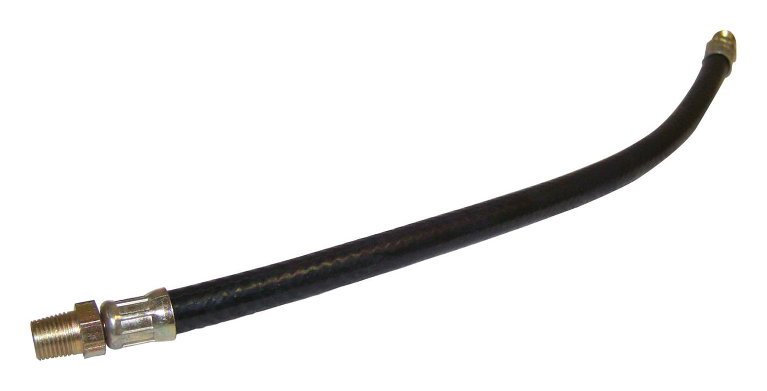

anyone used the flex hose from a grease gun? considering it,but concerned with quality of the hose and the outer cover deteriorating these are usually about 18" long, have 1/8" npt ends, and can be lengthened with a 1/8" npt connector

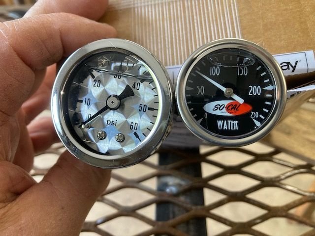

The way we did it.
Good thread and info!
When I came across these two small gauges, it hatched a similar plan on our 226-H last year...
Left, Moon oil pressure gauge.
Right, SoCal Speed shops temperature gauge.

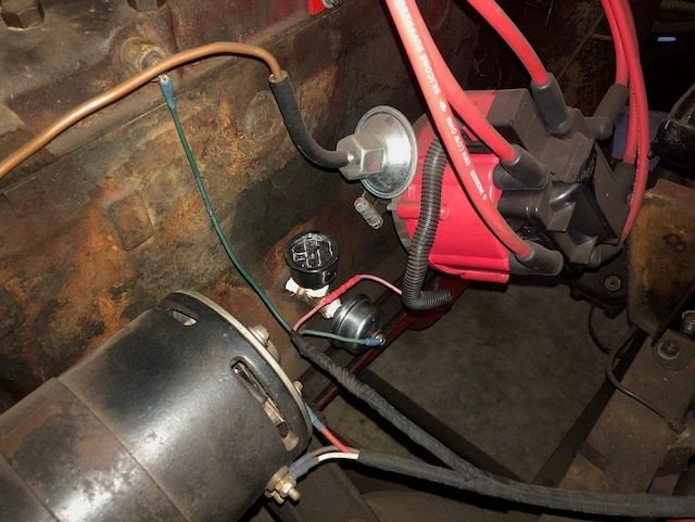

I went slightly different in the layout but the same idea, a brass tee with the gauge and the OEM oil sender on end...
(NOTE, the OEM Oil Gauge Sending Unit has an 'UP' mark that needs to be facing up for proper operation!)
... and yes, there is a different ignition distributor based on the GM-HEI system in our 226-H motor. Runs great!

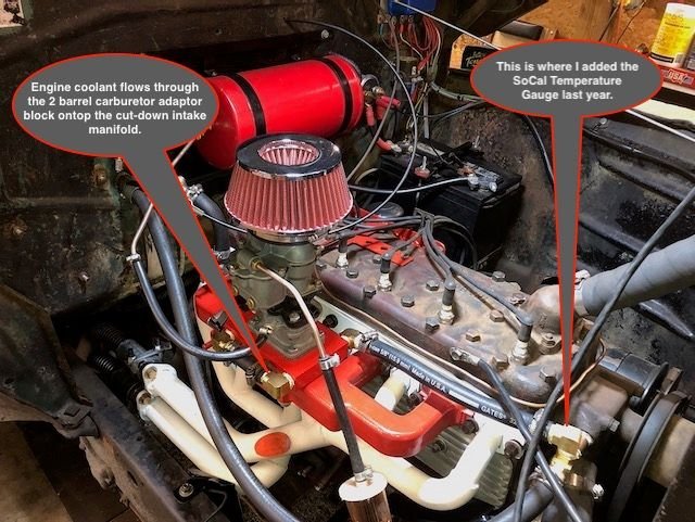

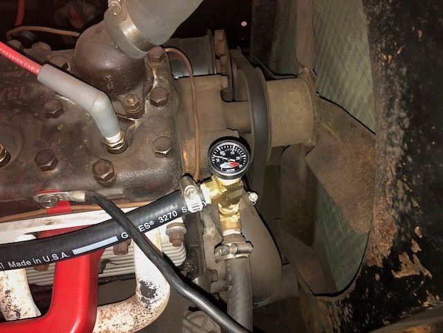

Below, is the temp gauge on the heater hose return to the water pump..
BACKGROUND: The exhaust headers from Red's eliminated the 226-H's OEM exhaust manifold, (and it's heat riser), under the intake manifold...
On top of the cut-down intake manifold, sits the aluminum 2 barrel adaptor block. It has engine coolant passages on both ends to warm up the base of the carburetor for better overall operation...
Below.
This was 2021 when the work on the headers and intake manifold install took place... (look how clean & white those headers were!)
