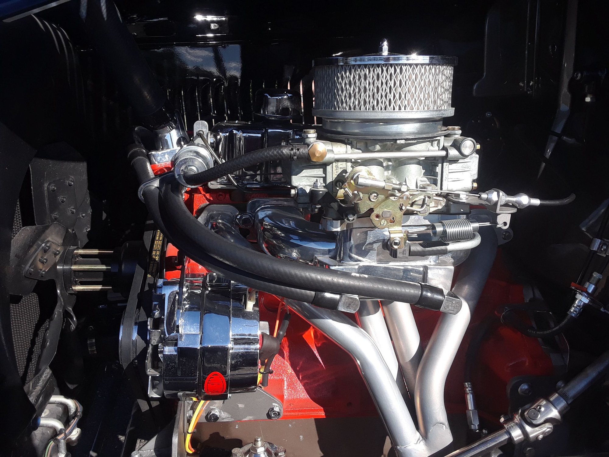

funny you bring up the 4.9 inline, we have built several model a hot rods powered by forklift 3.0l/181 inch gm based 4 bangers,replacing the low rpm cam with a marine 3/4 grind using clifford intakes and what is the smallest holley a 4160 4 barrel which is 390 cfm crazy little motors sound sweet and run just as sweet they are not really over fueled since in true marine trim that same motor's stock 2 barrel is 300 cfm

See below on the 390 cfm that is used on most straight six motors that are stock other than the carb, intake and header.
sad that so many people think bigger is better with carbs when it's totally the opposite,
Is the 3.0 / 181 the iron duke motor? What is that motor it in?
To lazy to look that up but if it is it is half of the GM v8 so it would run half as good right
I think it is cool when walking around at cars & coffee or a show and see something other that the GM / Ford v8 motors that is in everything.
That is what is nice of the 300 six in my truck, most of the time it is the only 6 there unless an old 60's Mustang shows up with a 170 in it.

iron duke is a totally different motor , it's what started life in the mid 60's nova,as a 153 ci 2 cylinders hacked off a 230 inline 6, it was made till around 2015 as a 3.0 l/181 inch ,powered forklifts water pumps,generators running propane had 10.25 compression merc omc, and volvo marine used it to power IO boats merc and OMC used it with dished pistons at 8.5 volvo used flat tops at 9.5 , later marine even had port EFI and cats . merc used a rochester 2gc carb at 250 cfm volvo used a holley at 300
flywheel back they used normal small block flywheels,bell housing and clutches clifford still makes the intake and header for them

From: Angier, NC
Thanks for the lesson.
What is that pretty motor in?
