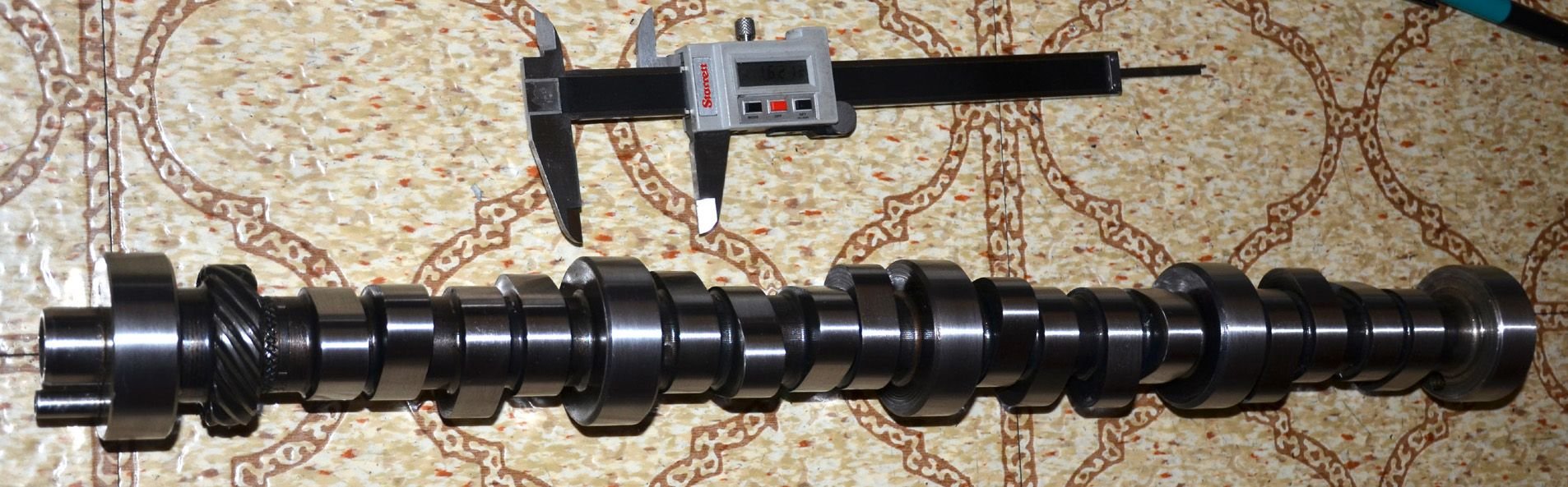

I got the cam yesterday, and took some pictures and tried to take some measurements. Overall, I do not see any anomalies, but I'm not en experienced cam maker. I'll note something I did see.
In the close-up, you might see streaks on the side of the lobe. They just catch my fingernails.
Closer view of cam
I tried to measure the lobes with my digital caliper, but I'm not sure if that's the right way. I was trying to measure the base circle by measuring across the narrowest width of the lobes. I found that they varied by as much as .04". But trying to measure the lift as best as I could, I find that each lobe peak is about 0.3" more than the base, which translates to 0.48" lift with a 1.6:1 rocker.
Overall view of cam
I will be getting my engine back from the shop on Thursday, and I will plug in the cam and try to measure with my dial gauge.

It it hard to tell from pictures but from what I can see that grind looks fine. I can't really tell about the streaks. When the cam is ground it can get a sharp edge/burr along the edge of the lobe. I like to knock off that sharp edge by using some Scotchbrite.
The base circle/overall size of the lobe will vary slightly depending on what's been done to the cam. The amount that the lobe has been changed in the grind has an effect on the finished overall size of the lobe. The cam started out as a dual pattern grind with an intake lobe that had less duration(and probably less lift) than the exhaust lobe. Assuming that it is now a single pattern grind with more lift and duration than before the intake lobe will measure slightly smaller than the exhaust lobe because they were changed more when reground. If gains lift and duration by changing the shape of the lobe in two ways, the base circle is reduced to gain lift and the base circle and the nose height are both reduced to gain duration(make the lobe get "fatter"). These changes are subtle and usually only involve removing a small amount of material.
It will be interesting to see what you find when you put it in the block.
