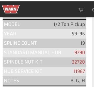

The automatic hubs are inside the truck? That’s odd. I looked at the Warn website and saw this in less than a minute
Sure. Lots of people have converted from auto to manual hubs. I liked the auto hubs I had on the ‘94 Bronco. When I broke them (my fault) I replaced them with another set of auto hubs.

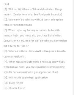

You just need new wheel bearing nuts and the locking hubs
You will be discarding your original locking nut and retainer
You will be using the two new nuts and washer plate on each side,
The washer with all the holes goes between the two nuts with the pin on the inner nut
Watch a video or two, 32720 or 28068X are the nuts
Some of the kits I see have the nuts but are double the price
Get the factory style Warn hubs with the plastic piece you turn (better IMO than the brass ones) (do not get sticky)
Warn 9790 are the OEM style 4x4 manual locking hubs, Ebay # 235244500220 134.99 free shipping for 2

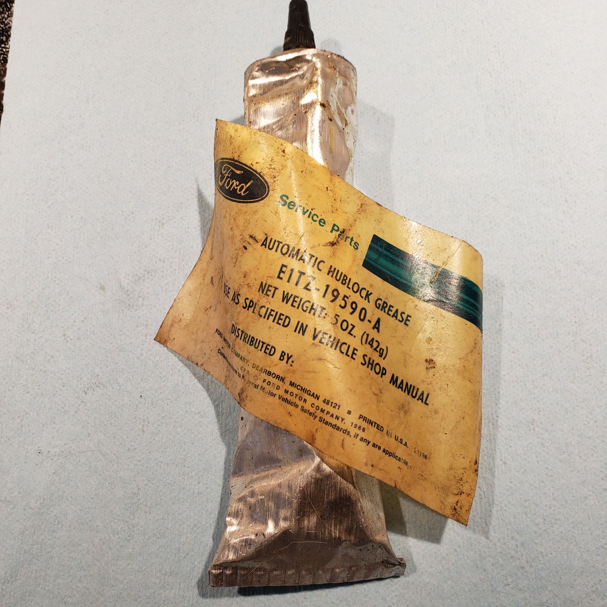

The grease is special for those automatic hubs
This is it
it's real slippery stuff

Never used that stuff. Plain old wheel bearing grease is all I’ve ever used.
