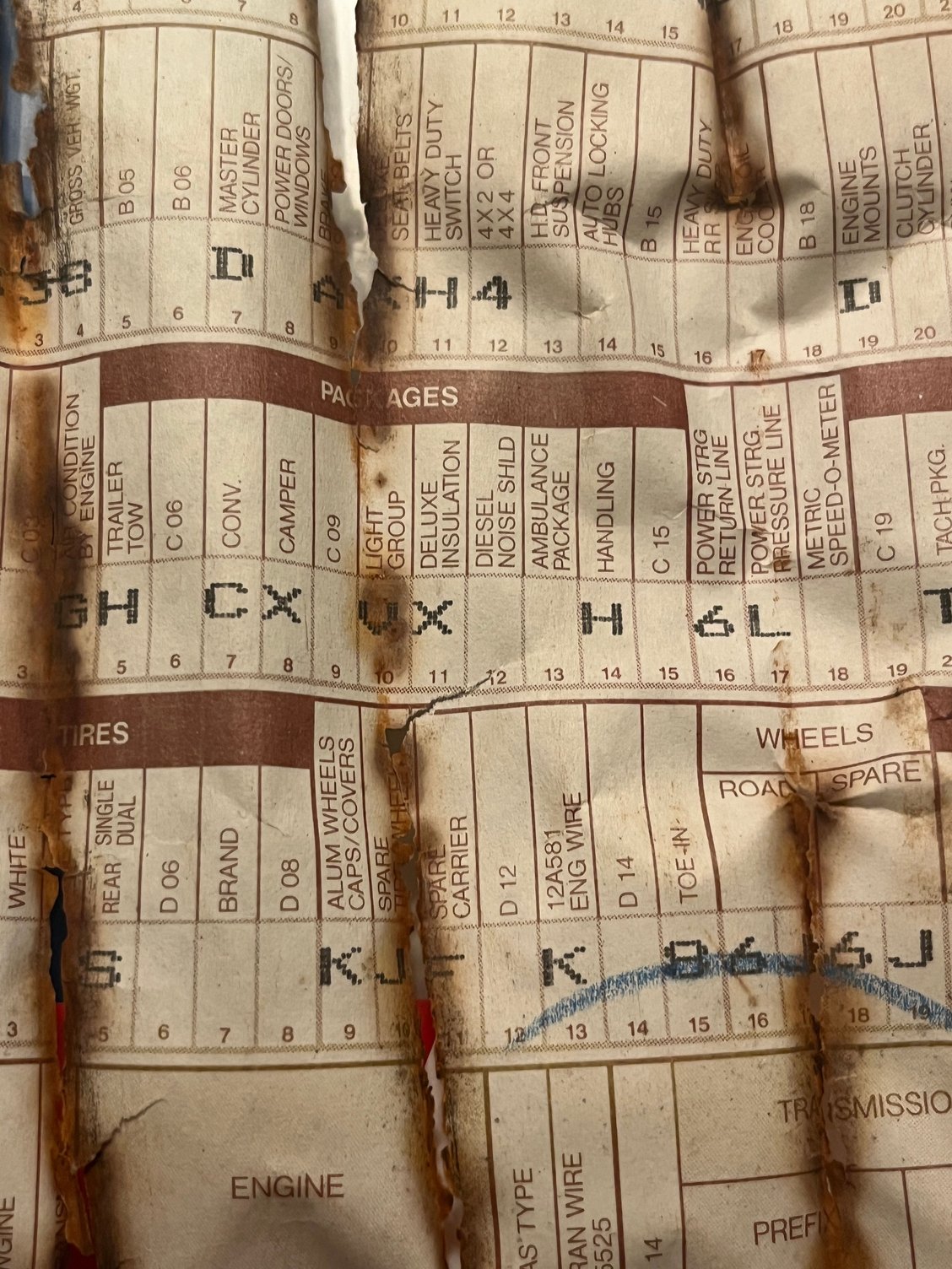

I would appreciate some help decoding the VIN and door option plate on this 1989 F250 said to be a camper special. Thanks in advance (photo attached)

89 F250 regular cab 2 wheel drive with 460 engine and E40D trans made in Canada.
not a camper special, that package was only available 73 to 79

1989
2FT - Ford Motor Company Canada
H - hydraulic brakes, 8500 to 9000 pounds
F25 - F250 2 Wheel Drive Reg Cab
G - 8 cyl 7.5 Gas EFI
8 - check digit
K - 1989
C - Oakville, Ontario Canada
B15153 - Sequence Number
FO263 - Front axle accessory reserve capacity in pounds
TO199 - Total accessory reserve capacity in pounds
B7 - Ford Canada Pacific
7H - Bright Regatta Blue Metallic
9M - Colonial White
F257 Type - F-250(4x2) - GVWR 8600lbs, 133" wheel base
TB4 - Medium Caramel? seats/upholstry, -Blue(regatta?) interior, - styleside standard cab
E - E4OD
39 - 3.55, 6250lbs
1 - pinstripe light regatta blue/bright regatta blue

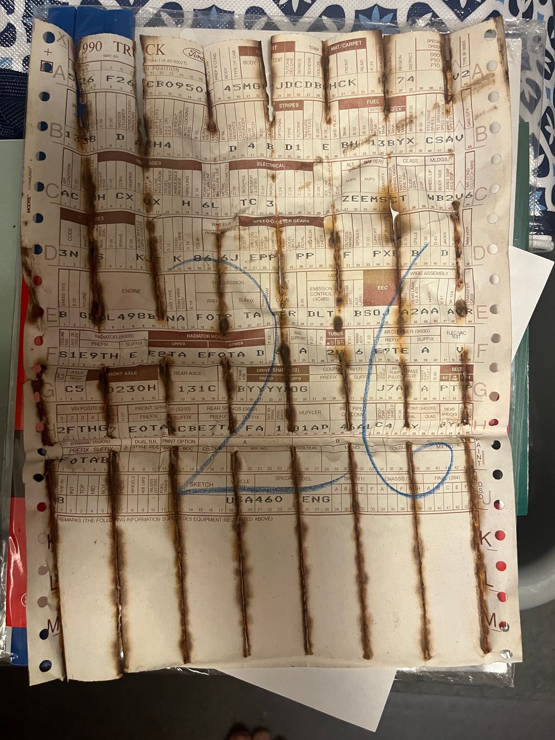

If you look under the seat you might get lucky and find the build sheet.
I just had my seat out last weekend and pulled the seat apart and recovered mine to find out it has the camper and handling package.
