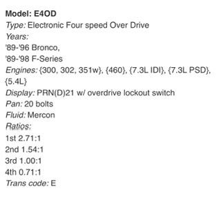

What transmission do you have now? The tag on the door jam will tell you. Most of these trucks came with the 'e' code E4OD auto transmission which is a 4 speed with overdrive and lock up torque converter. Very few came with the c6 transmission which is the 3 speed automatic transmission with no overdrive and no lockup torque converter.
Do you have the 'od cancel' button on the end of your shifter? If you do, you have the E4OD transmission.

The E4OD was the only overdrive transmission available behind the 351W/5.8L so you already have a 4 speed overdrive transmission.
