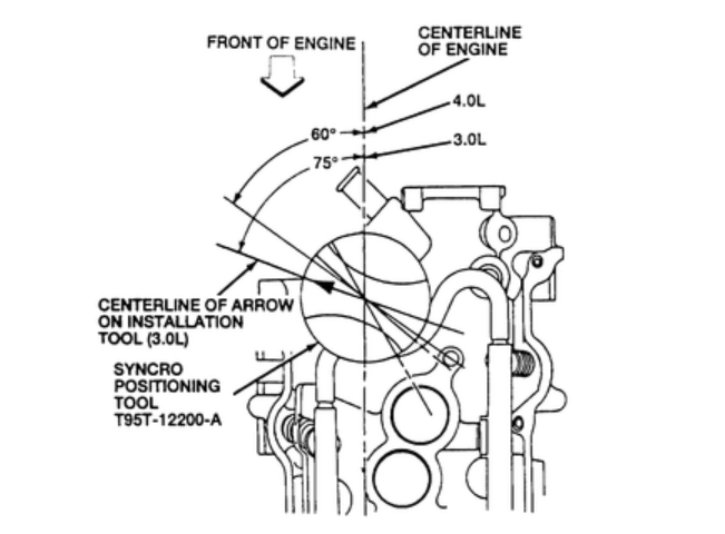

Hi, just about to fire up a ranger after an engine rebuild and the last thing I have to install is a cam synchronizer, didn't even know what it was until I looked it up, can anyone give me some more info on this, I did not mark anything. And from the little research I did it seems this part can be problematic on the 3.0 so I am thinking of just replacing it since I did a whole engine rebuild. So my questions are, is there any updated synchronizers you can buy out there that don't develop whatever problem it is that they have, and how do you install this accurately since nothing was marked upon removal.

I think I have a better idea of how to install it after some research but can someone tell me how you accurately degree the thing. I hear there is an allowable margin of error of a few degrees, but I am still concerned I might not get it within a few degrees if I don't know the exact angle. And where should the synchronizers housing be.

You need one of the synchronizer tools. And you'll need to set cylinder 1 at TDC. You can probably get the alignment tool at a local auto parts store but it will cost more. Maybe they'll have a loaner.
https://www.rockauto.com/en/catalog/...nt+kit,1001188
This guy's video covers the basics. But he is not starting from scratch. You'll be better off with the tool. Make sure you get the 3.0 tool, there are several types.

This is probably the one. 6473.
https://otctools.com/products/ford-c...ronizer-tool-0
Ford Camshaft Sensor Synchronizer Tool• Works on 1998 - 2001 3.0L V-6 Ford Taurus, Mercury Sable, Ranger pickup and Windstar van.
• Same as Ford 303-589.
• Used to synchronize the camshaft sensor to the No. 1 cylinder.

so in the video it seems to me like its really simple, but why does the repair manual say to offset it 75 degrees from the centerline of the engine. From what I can understand it wouldn't matter how you degree it as long as the rotor is positioned correctly in the housing.

Apparently that is so that the harness will plug in to the sensor correctly, with no physical interference, after installation. You can imagine getting the synchronizer installed and everything buttoned up only to find that you can't connect to the sensor.
