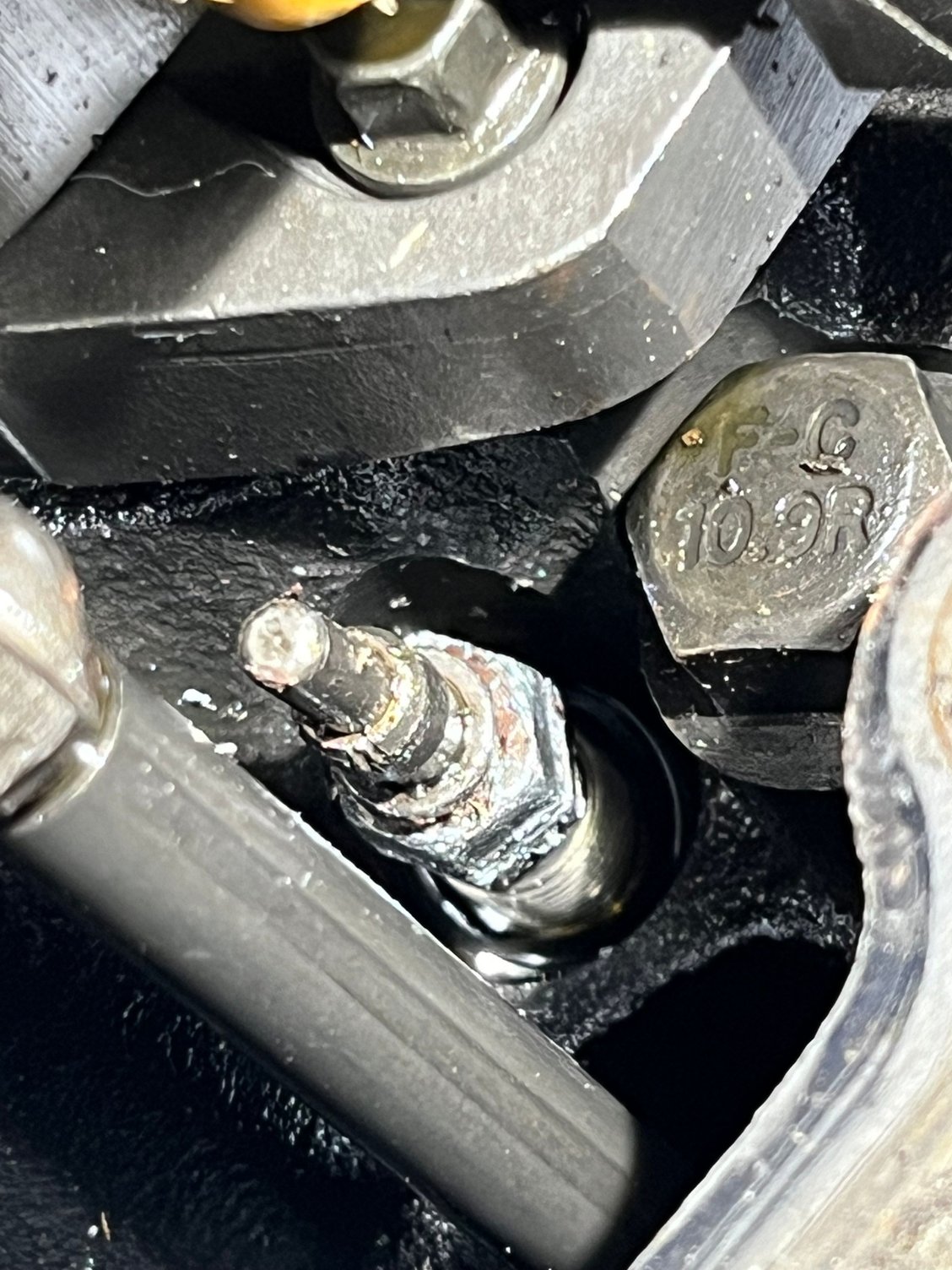

Ok. Got glow plugs #7 removed no issue, #5 (blew out like previously mentioned), #3 removed no issue and #1 was tough from start and now it’s made it up to what seems like the it’s close to the top and it just spins like it’s stripped threads. All these glow plugs are autolite. What can I do to get #1 out? It’s stuck at its current position and won’t thread in or out like it was installed cross threaded by previous person maybe. It was a not smooth turning like the other two from the start.
any help would be appreciated. Thanks

do you think it’s the thread are all the way out and the head (tip) is stuck like it’s mushroomed?
Cylinder 1. Plug is spinning but not coming out.
Cylinder 3 removed but covered in oil.

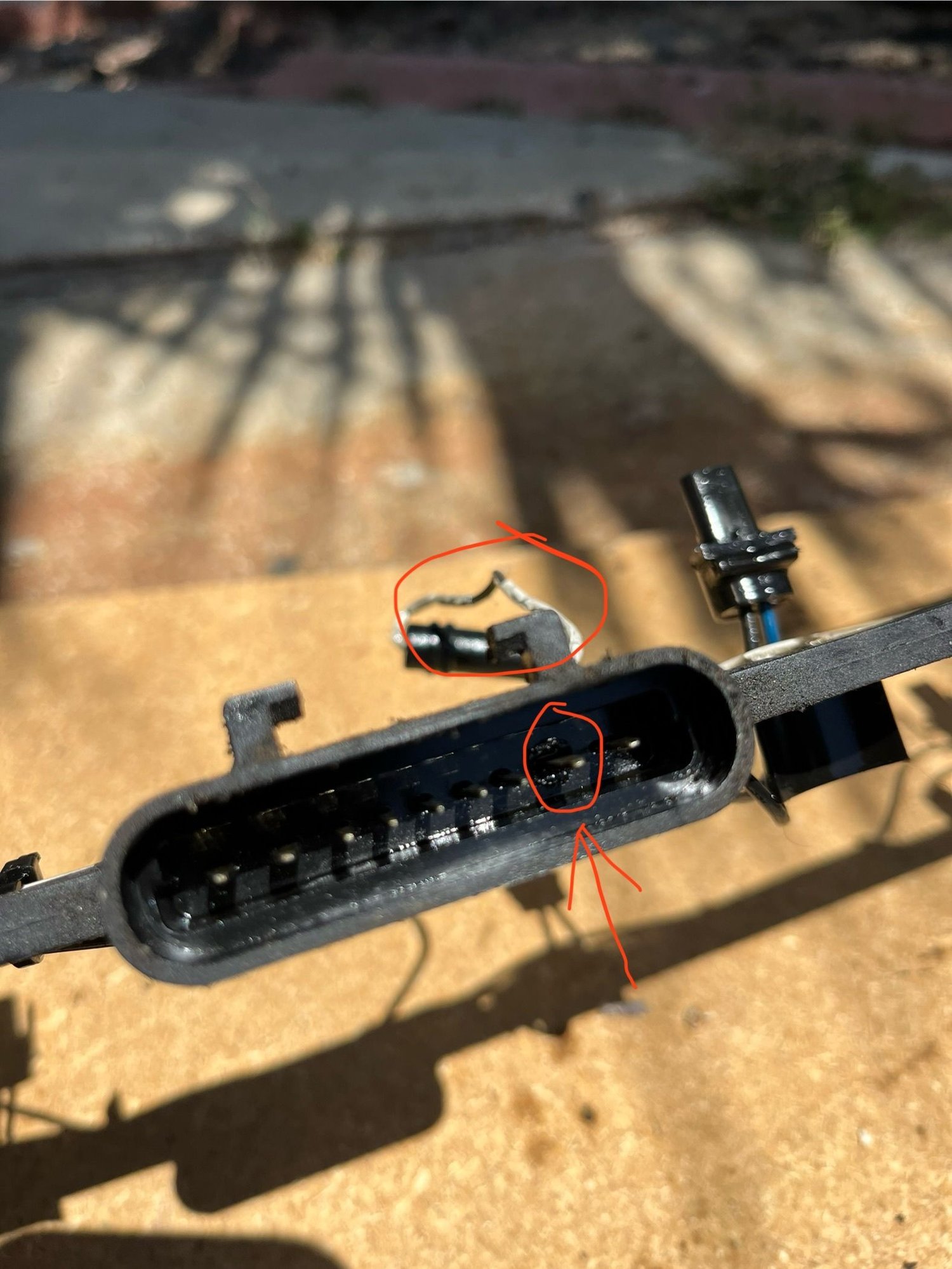

Cylinder 5 burnt at harness and pigtail

The glow plug is bent from the force of it blowing out (it is longer than the distance from the head to the valve cover) and being complete, there is no way it touched the piston.
#1 has a swollen tip, hence the reason to only use motorcraft from a reputable source.
you can use a small slow turning drill and spin the glow plug (counter clockwise) while spraying it with GOOD Penetrating oil ie. kryol, pb blaster. Light up pressure then down then up....
until you wear the tip diameter down to fit through the hole.
same thing can be done by hand with needle nose vicegrip pliers. Go slow, very little force or the tip will break off. Just keep spinning it until it shaves enough off for it to come out.
once it is out, install new motorcraft plugs, valve cover gasket then do the drivers side, the longer those autolite plugs stay in the more they will swell.

came out!!! Thanks so much!!
after I get it all back together do I just start it up? Should I crank it “X” amount of times to clear the cylinders first?
#1 was caked with oil. #3 had oil on it too. 7 did not have any. Any concerns with the oil accumulation difference?
1 was covered in oil. Concerns?
1/4” extension with socket. Spun for about 45 seconds slowly and noticed the plug stated pumping up and down on its own in reverse. Pulled right out.
1 is caked in oil on the left. 3 is oily too.
