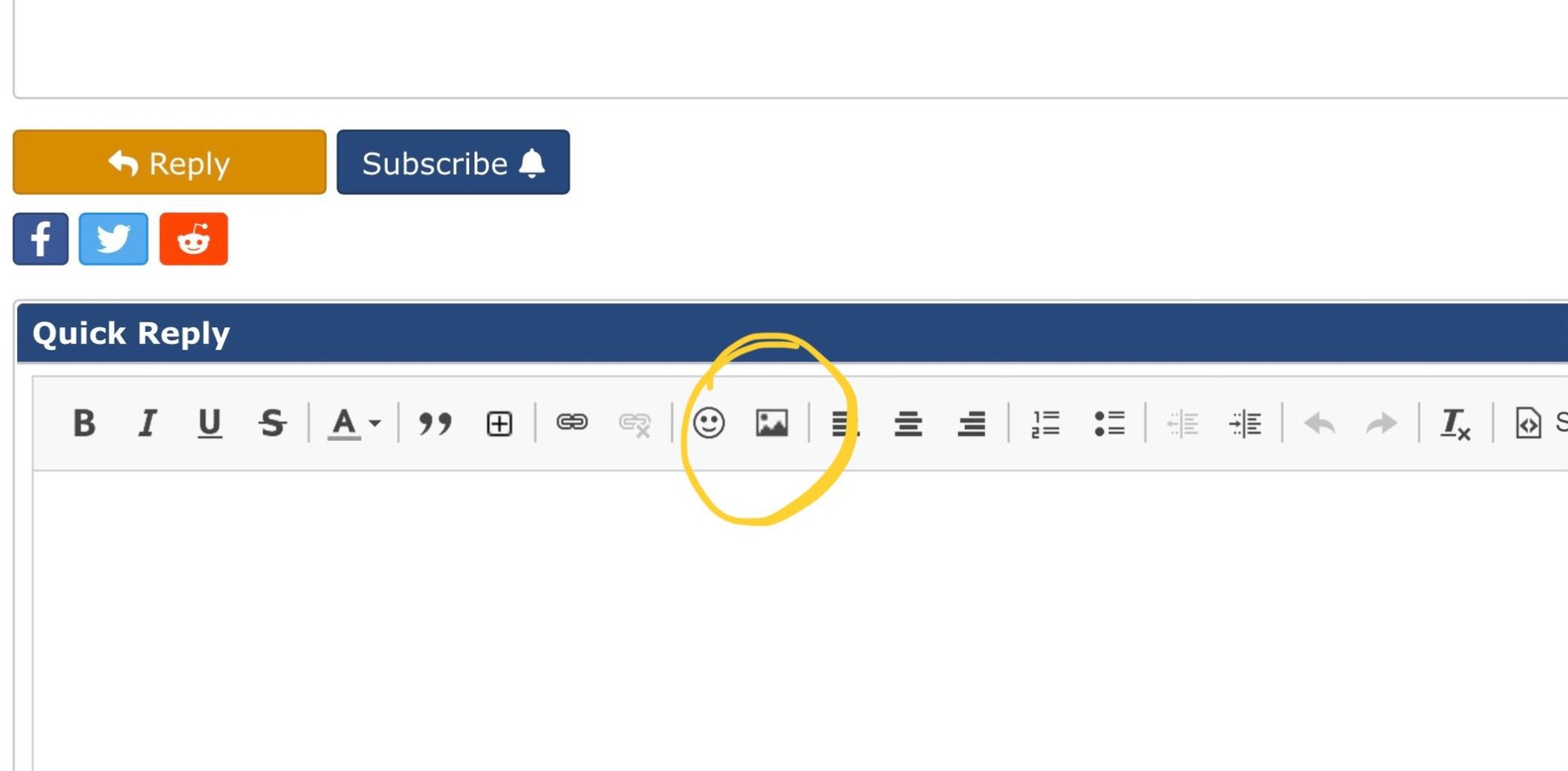

Post up some pictures, you should be able to. Click on this icon - see pic below.

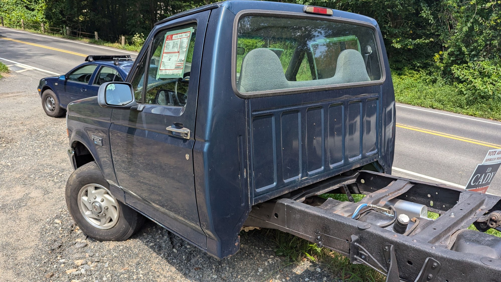

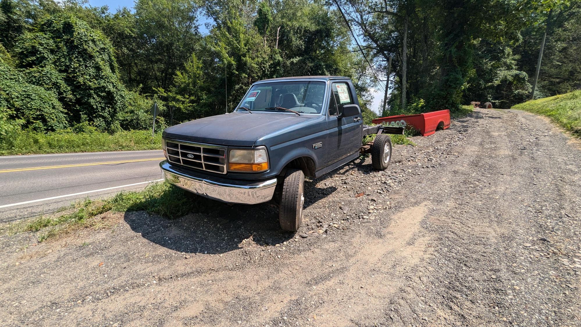

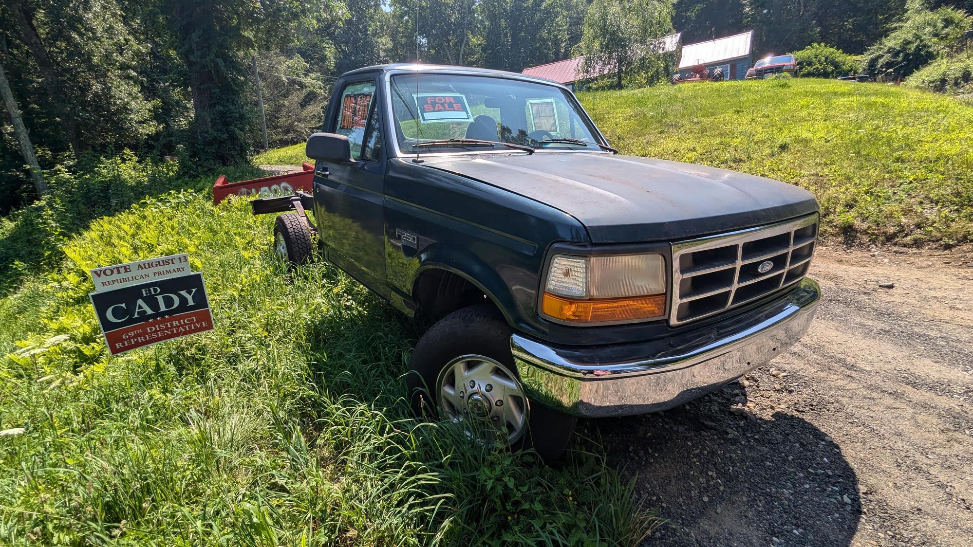

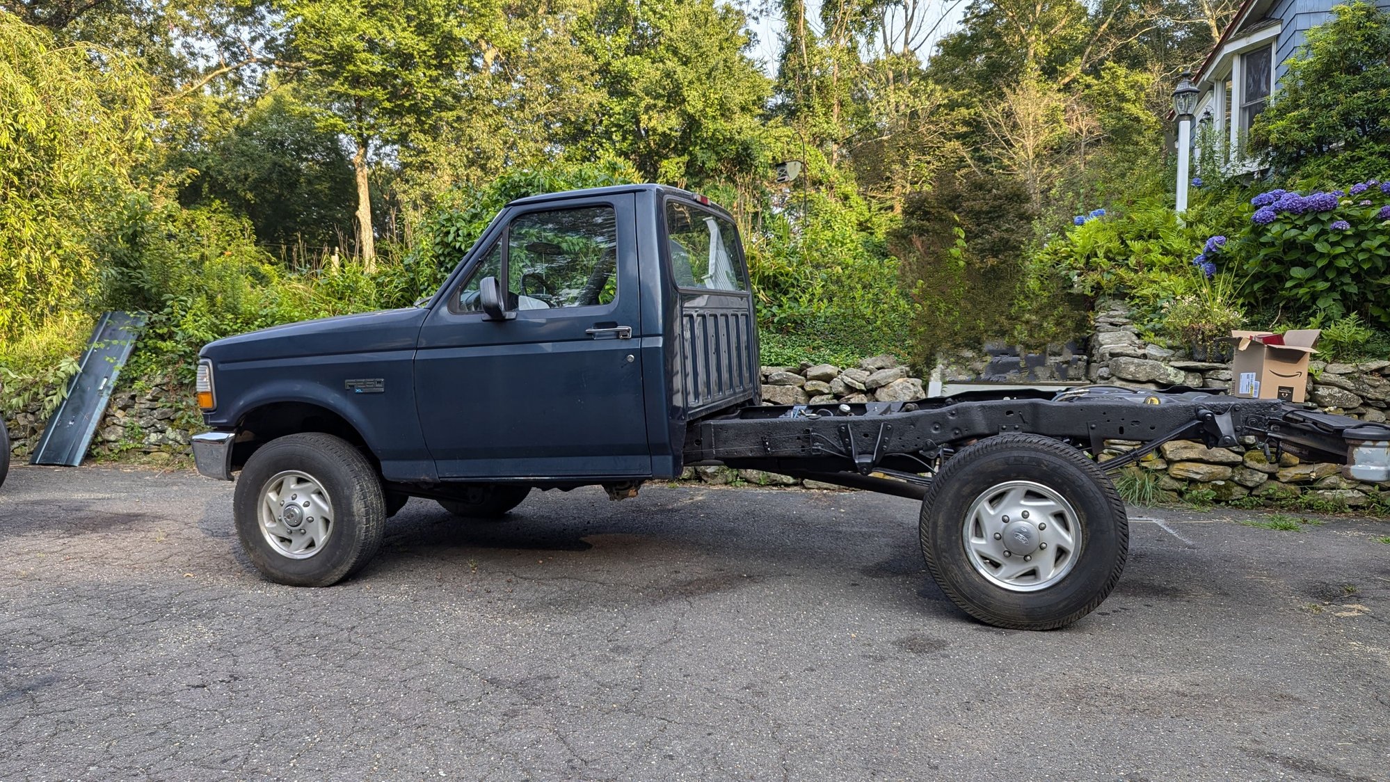

Thanks for the info guys. Right - 351w
As for plans, I may get a repaint (the bed is red - so yeah, that will be done). It also needs tires, so that's on the list. Long term plans include a rear limited slip diff, and a 2.5" lift kit. I also prefer manual hubs vs the automatic ones as I've had issues in the past with auto hubs. I will give these a fair try before I start judging how well they function. I really like the stock look of these old trucks, so I'm going to keep things factory looking, other than a mild lift. A tall, government "fleet" vehicle with narrow wheels & tires is the look I'm after. Later on I may do some engine modifications, but it runs great now.
It also has manual window cranks - which I like, plus the vent windows.
Regarding usage, I'm not planning on doing a lot of recreational off roading. The area where I live is kind of hilly, and you will get stuck in a 2wd in snow. I put a locking differential in my FWD Jetta. With proper winter tires, it will climb a steep ice covered driveway or road no problem. I'm a big fan of locking diffs. I also have a 4wd VW van with front and rear lockers.
https://www.thesamba.com/vw/gallery/pix/2467175.jpg
Currently, the bed it off. I'm planning on a thorough cleaning of the gas tanks & frame, along with an application of Waxoyl undercoating. Rust prevention is my primary goal. The AC needs some attention too.

Same color mine was originally. Look forward to the updates as you go.
Looks like someone has already gone over the frame and cleaned it up, replaced front leaf hangar, muffler, and coated it with something. The rear cab corners on these have a sprayed in foam that is open on the bottom and likes to absorb water. Front does too, but difficult to access. I pulled the rear foam out, and installed a cover, then soaked it down inside with rust inhibitor.

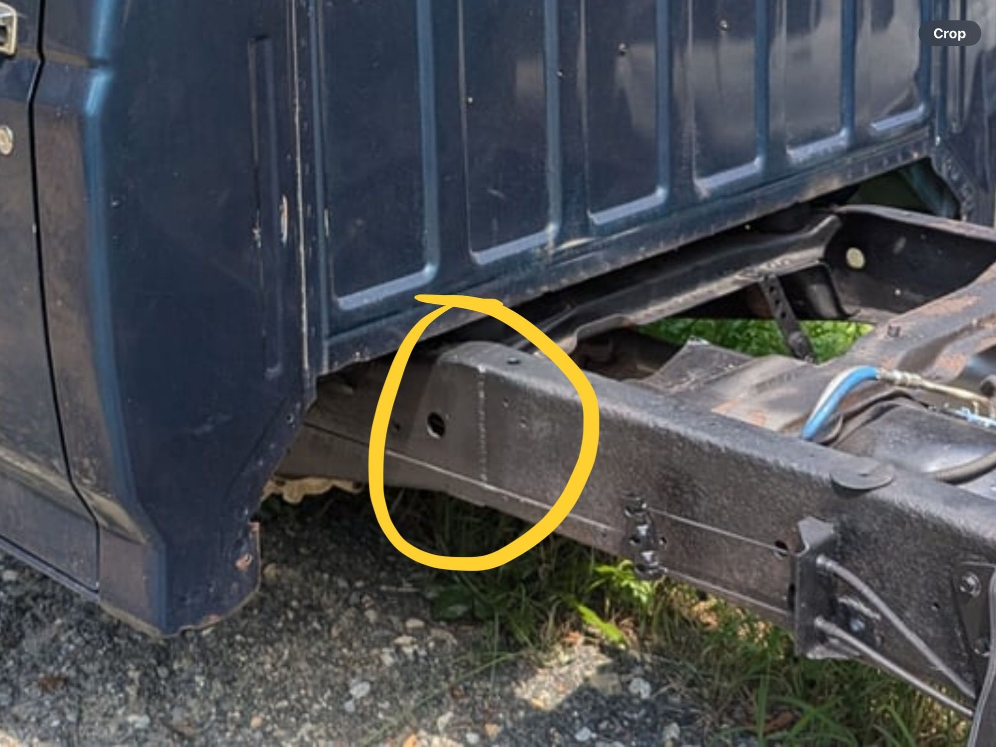

Also looks like a frame repair has been done. I’d have a good look over that.

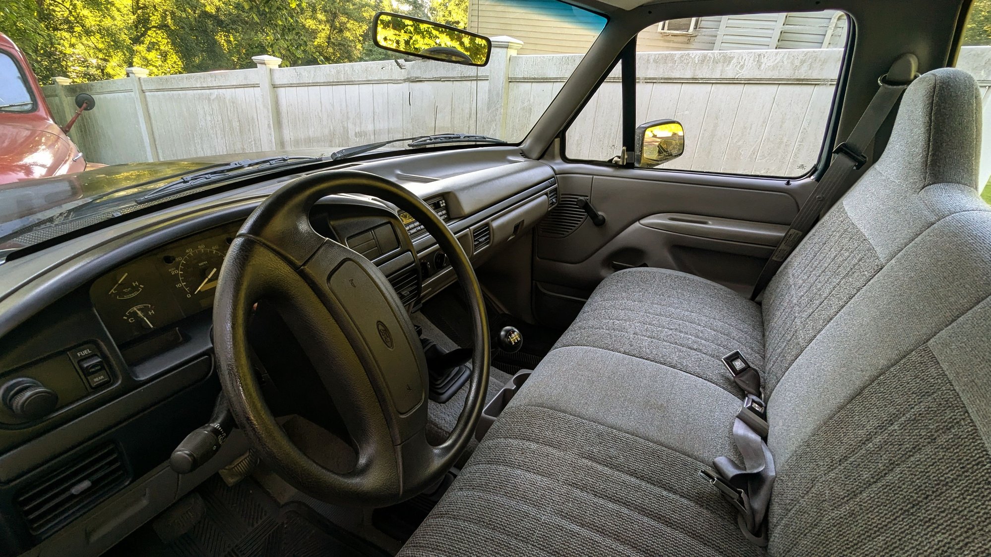

Couple more pics.
Does this truck have an airbag in the steering wheel?

WOW! Let me, first wipe the drool off, are kidding me!! that interior looks like its never seen daylight...really nice find you have gotten yourself.
