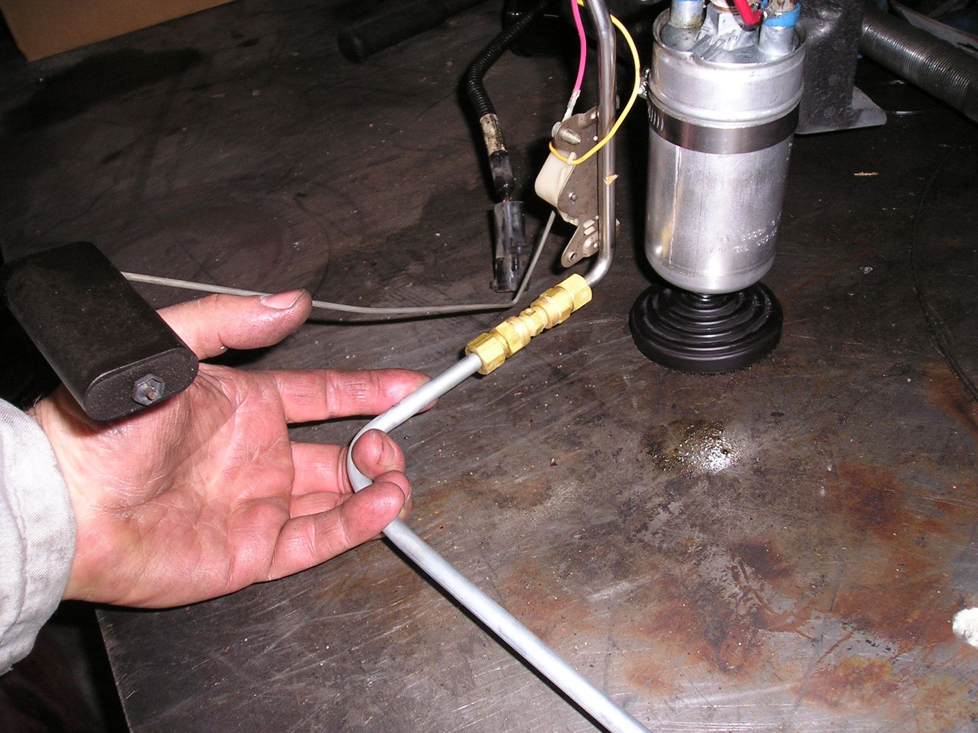

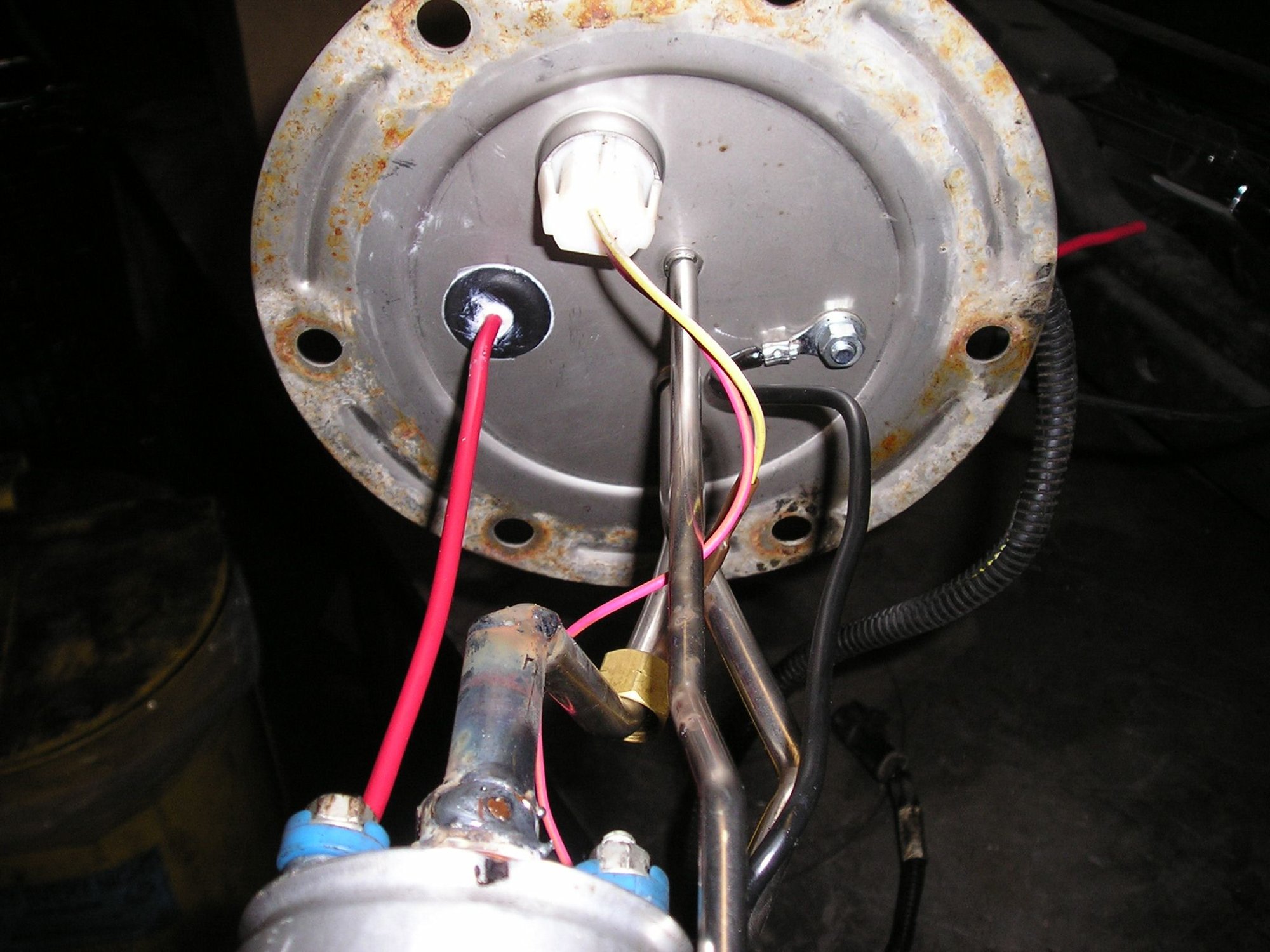

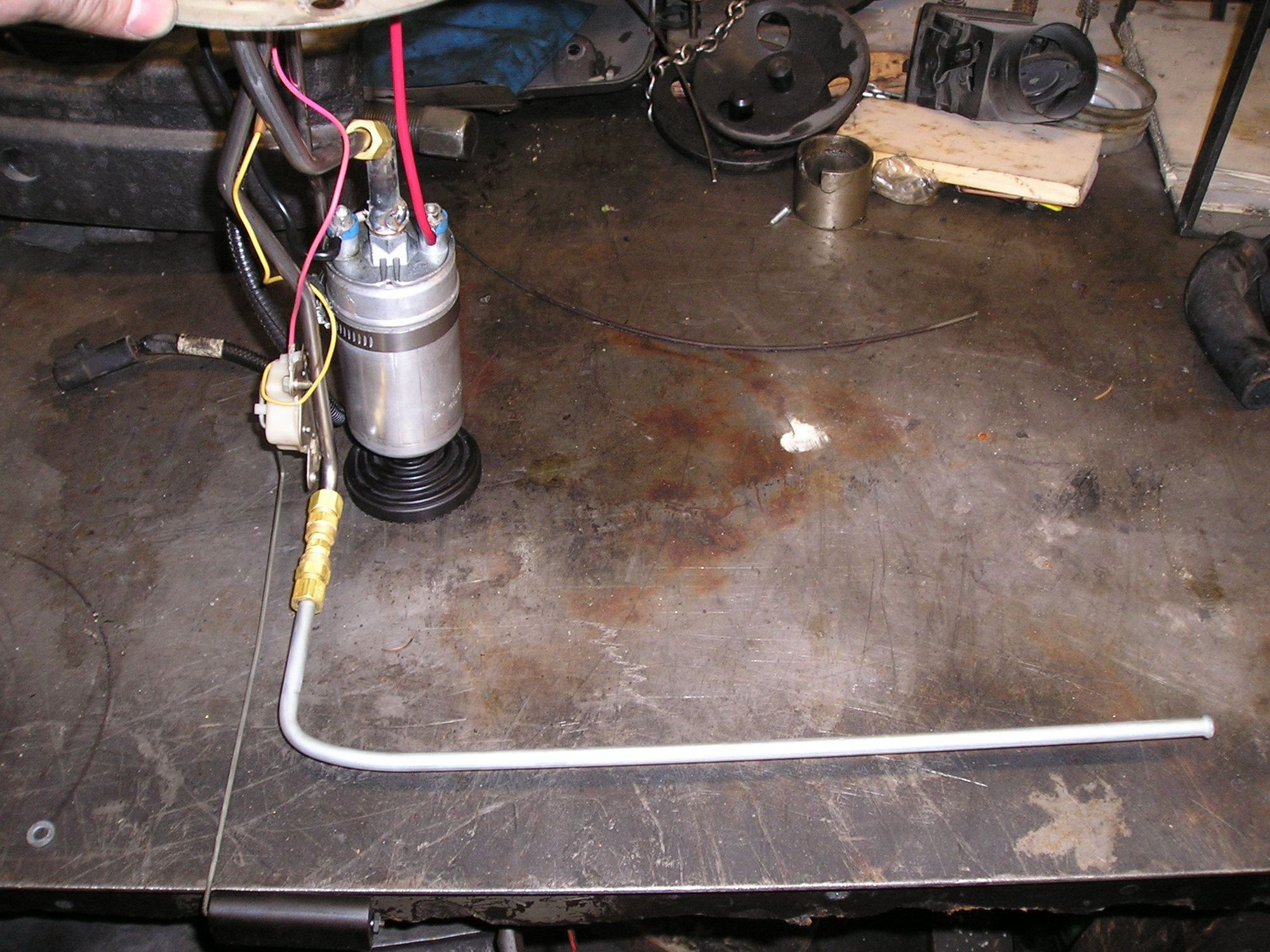

Here are some pictures of what I did back then and I am still running the same fuel pump as then without ever having a single failure. Basically weld on a fitting at the appropriate height to accomodate the fuel pump. Remove the factory fuel pump from the frame rail and jump the gap with some fuel injection rated fuel line and double clamp both ends, jumping the ridge that the quick connect grabs onto with one clamp and the other clamp on the other side of the ridge. Pictures are worth more than 1,000 words in this case.

@Kwikkordead I never got to do much with welding, would you be open to making one for purchase?

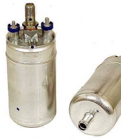

looks like I would need some 10 gauge wire, -6 AN fittings, Bosch 0 580 254 044, and the new connector. Now here comes the questions haha:
