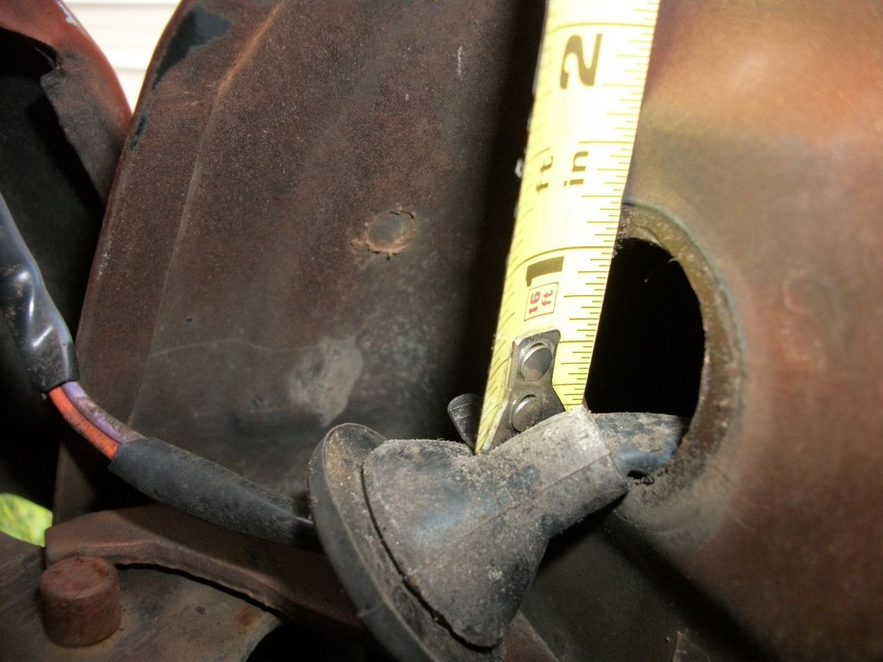

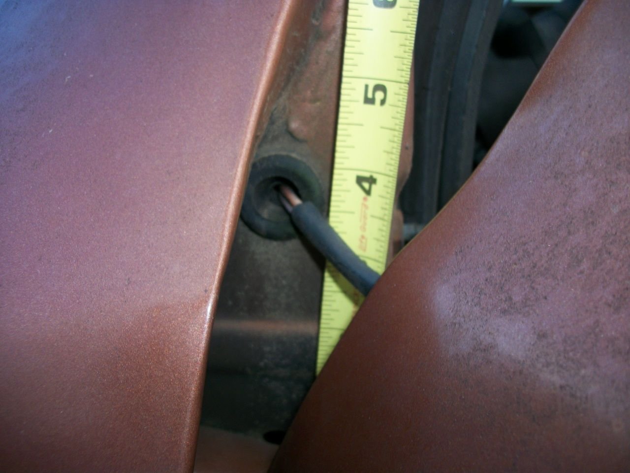

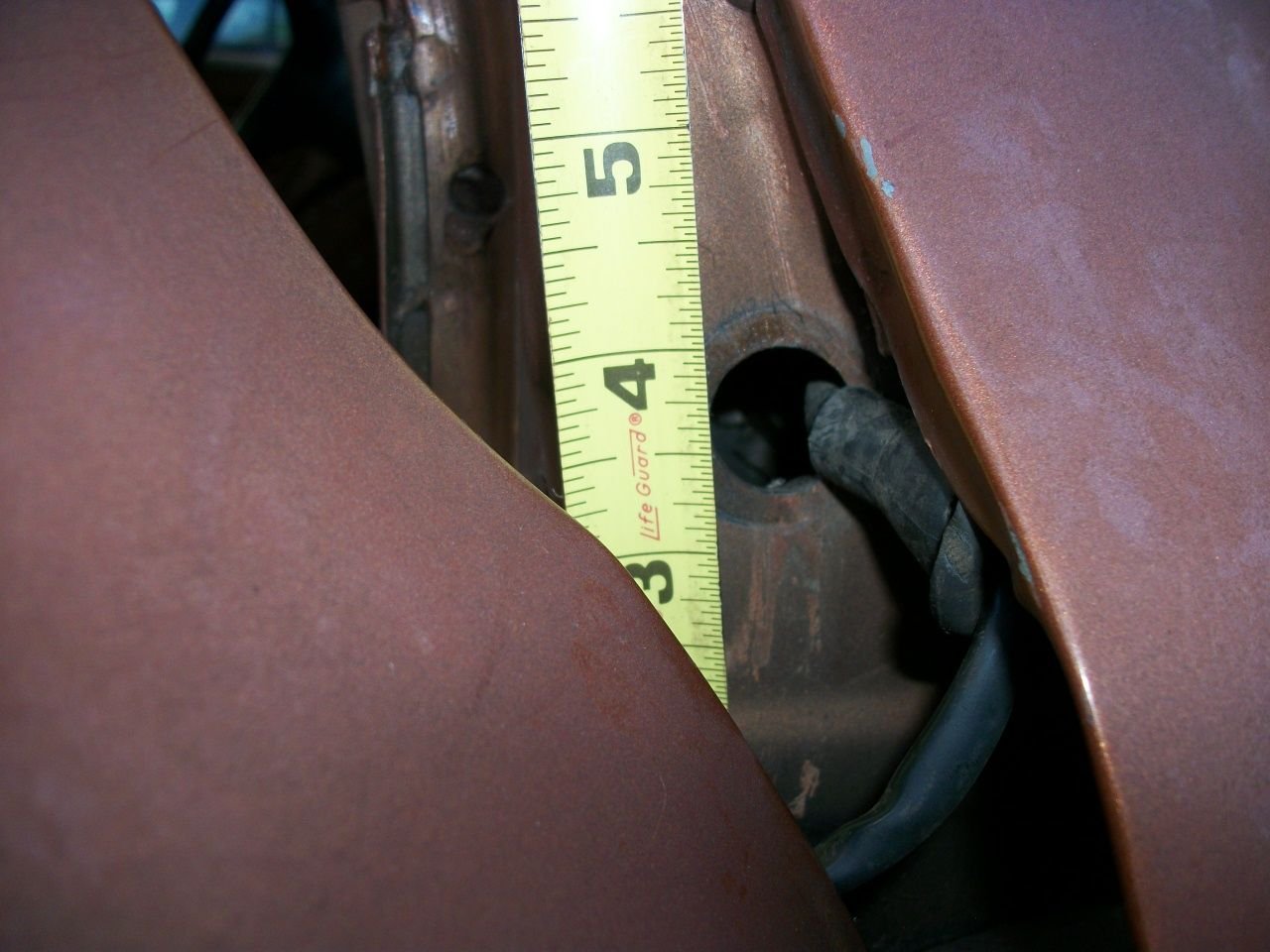

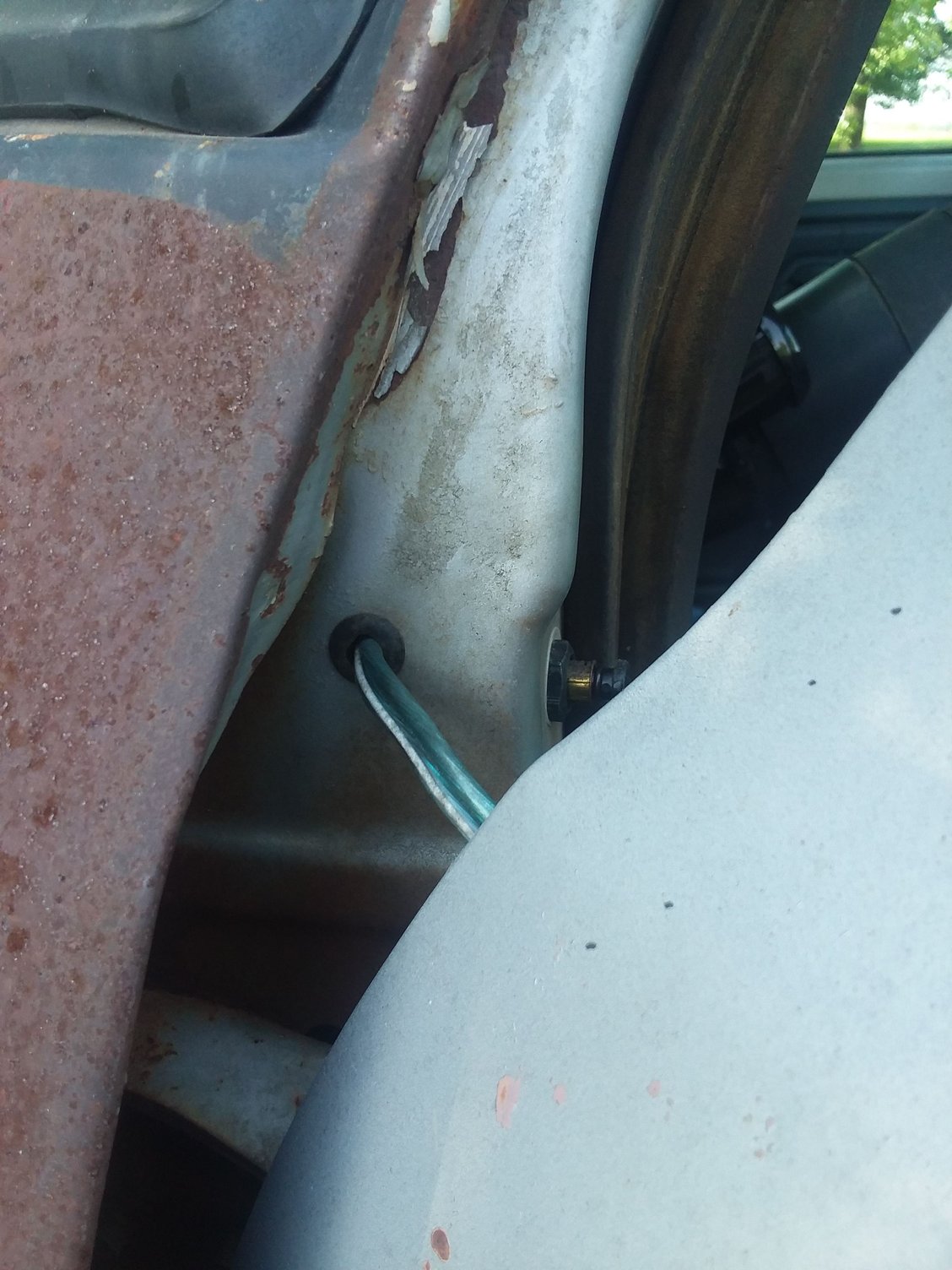

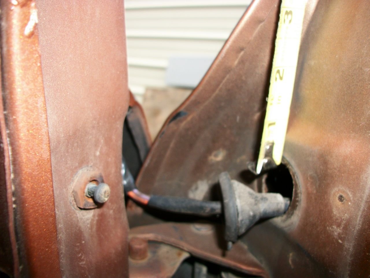

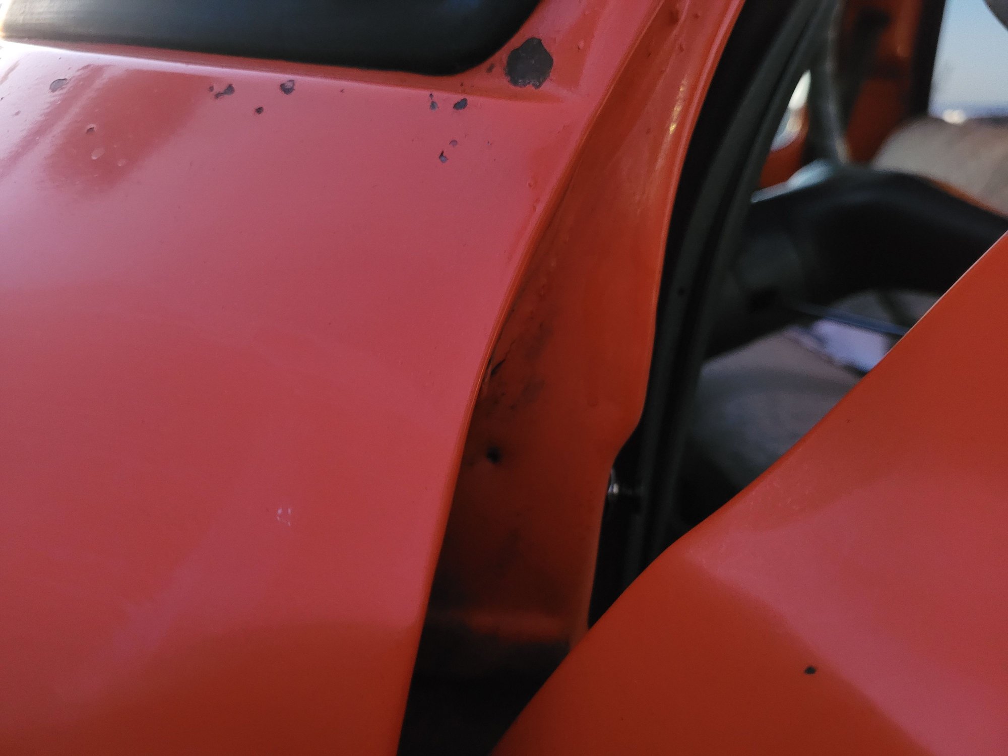

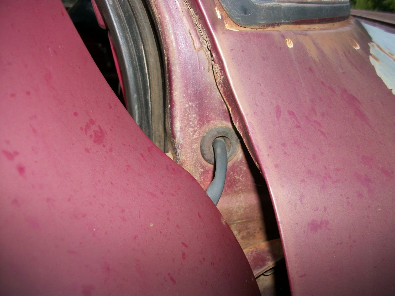

Silver truck, there is a dimple in the cab wall where to drill.
Pretty sure tape measure is setting on top of door hinge. Cab side.
Cab side.
3/4 dia hole, cab side.
Again I believe the tape is on top of door hinge, different truck. Cab side.
Door side hole.
1" dia in door. OEM wire harness and rubber grommet.
Door side.
This is the passenger side door hole.
You should have access to the hole from up under the dash (on each side) And pop out the side wall panel up high rubber plug. Also there is the door open push switch wiring in there, so go fishing carefully.

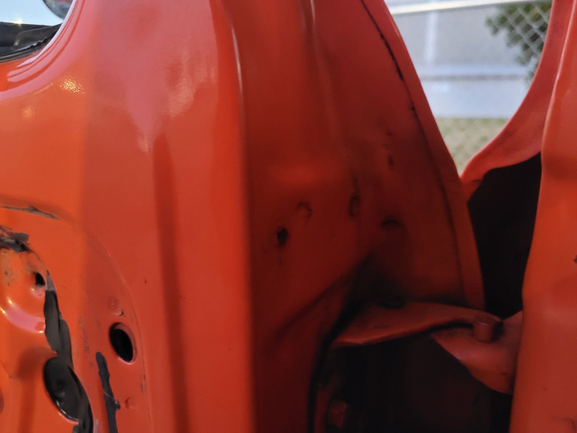

Ok thats way different than what I'm seeing. I'm guessing this truck must not have originally came with a radio cause I do not believe have those holes which would make what the previous owner make more sense but still not ok. The speaker holes are cutout and those look factory though.

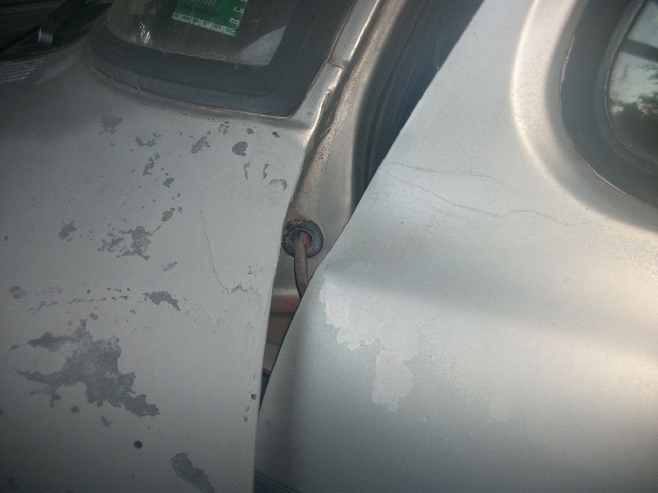

As you can see from the first photo, when I got the girl she had a speaker wire coming out of the hole on the right, running under the door seal and through the hole in the door. The passenger side they went through the door seal. Nothing protecting the wires.

Nope, that is a PO wiring job right there. At least the wire had some protection.
