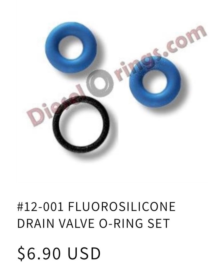

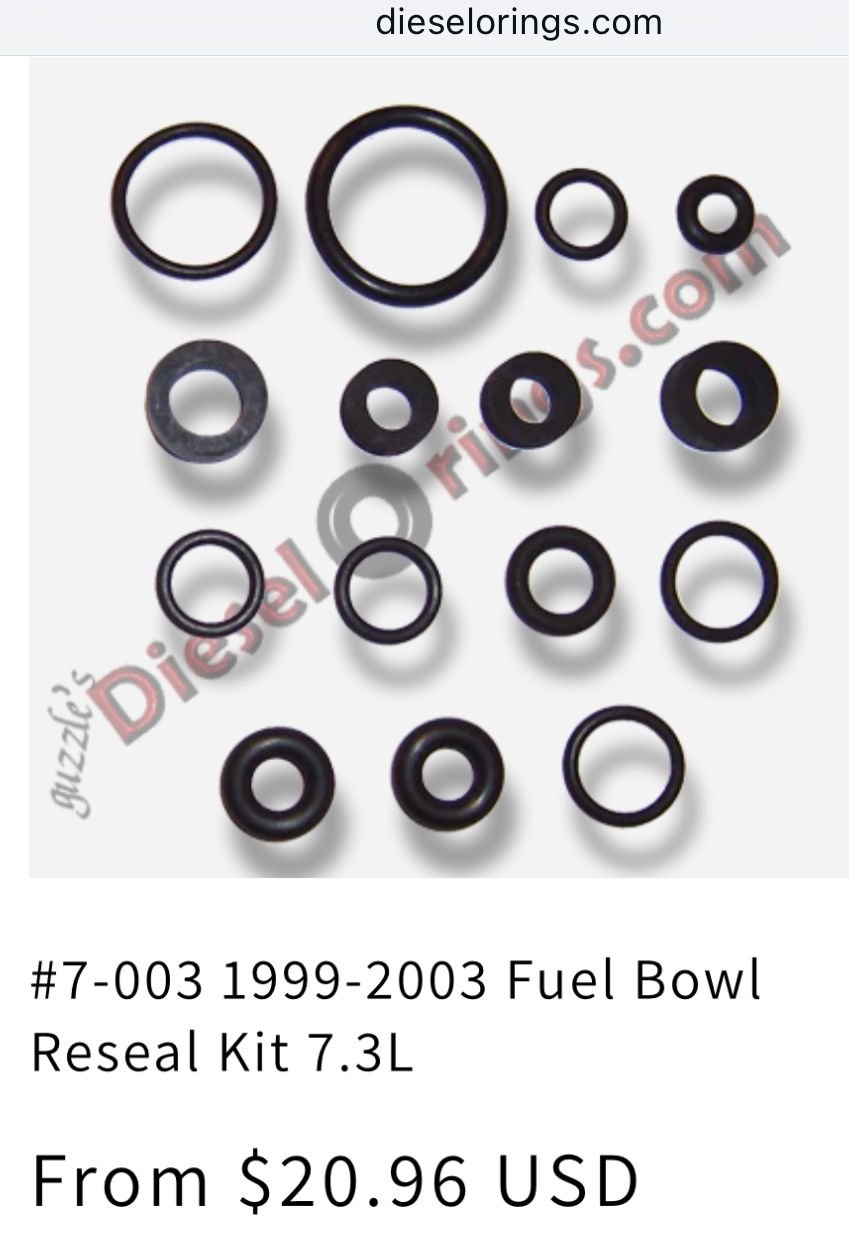

I’m not really wanting to get in the middle of this, but these parts are cheap enough to keep a set on hand. The fuel drain valve rebuild kit with the better Orings is less than $7. The full bowl kit including the Parker sleeves for the lines is $21. 🤷‍♂️
Like you said, you do you, but the logic on this one is eluding me.

You can get complete seal kit from diesel o ring for $25. Thst comes with all the o rings, all the fuel line compression seals. New upgraded o rings for drain valve and o rings for the wif and heater assembly. I'm still running the 25 years old original drain valve just replaced the o rings in it with ones in that kit. Couple months ago when I rebuilt it again as pm all the o rings still were soft and pliable and were not leaking anywhere after 10 years.
https://dieselorings.com/products/7-...eseal-kit-7-3l
