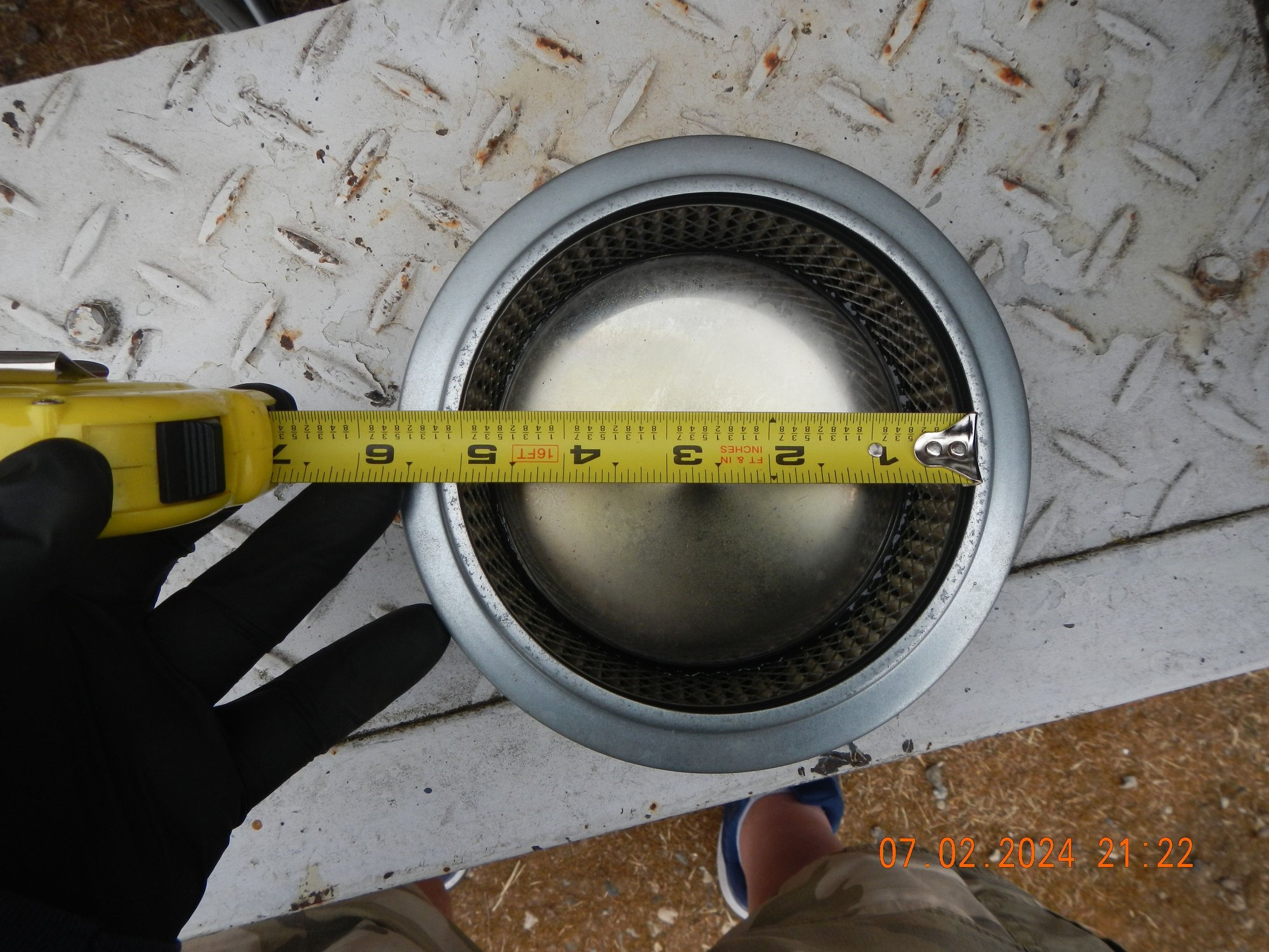

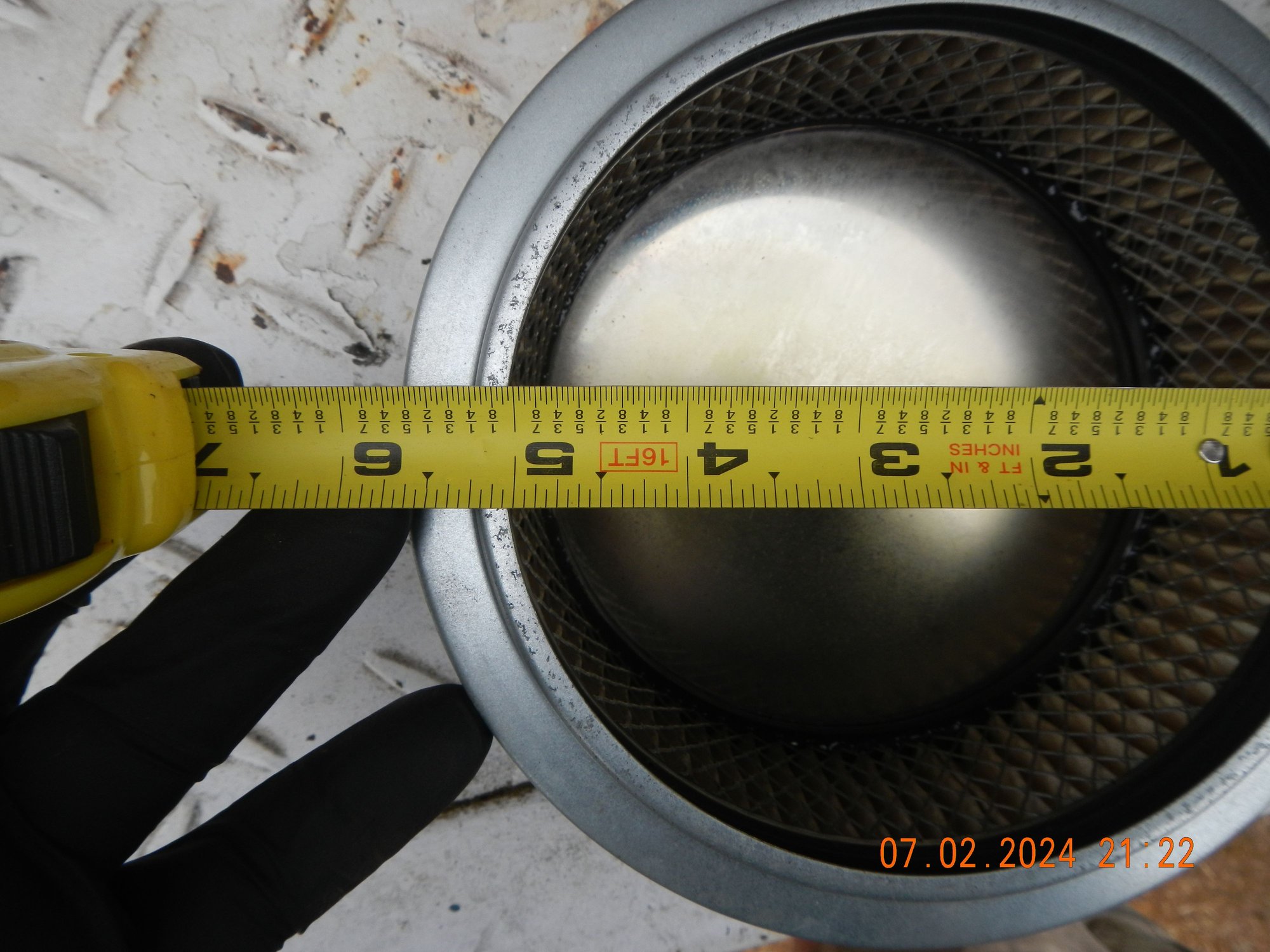

my carburetor is a:
Holley Street Warrior 600cfm - model 4160
with that..... Give me part numbers for the air filter spacers and for those o-rings you are talking about? I measure the top opening on this carb and i believe it would be called a: 5 1/8" opening.
My best pictures are of the Bottom of the current Air Filter Base (see attached) Inside to inside measurement.
Thank You
