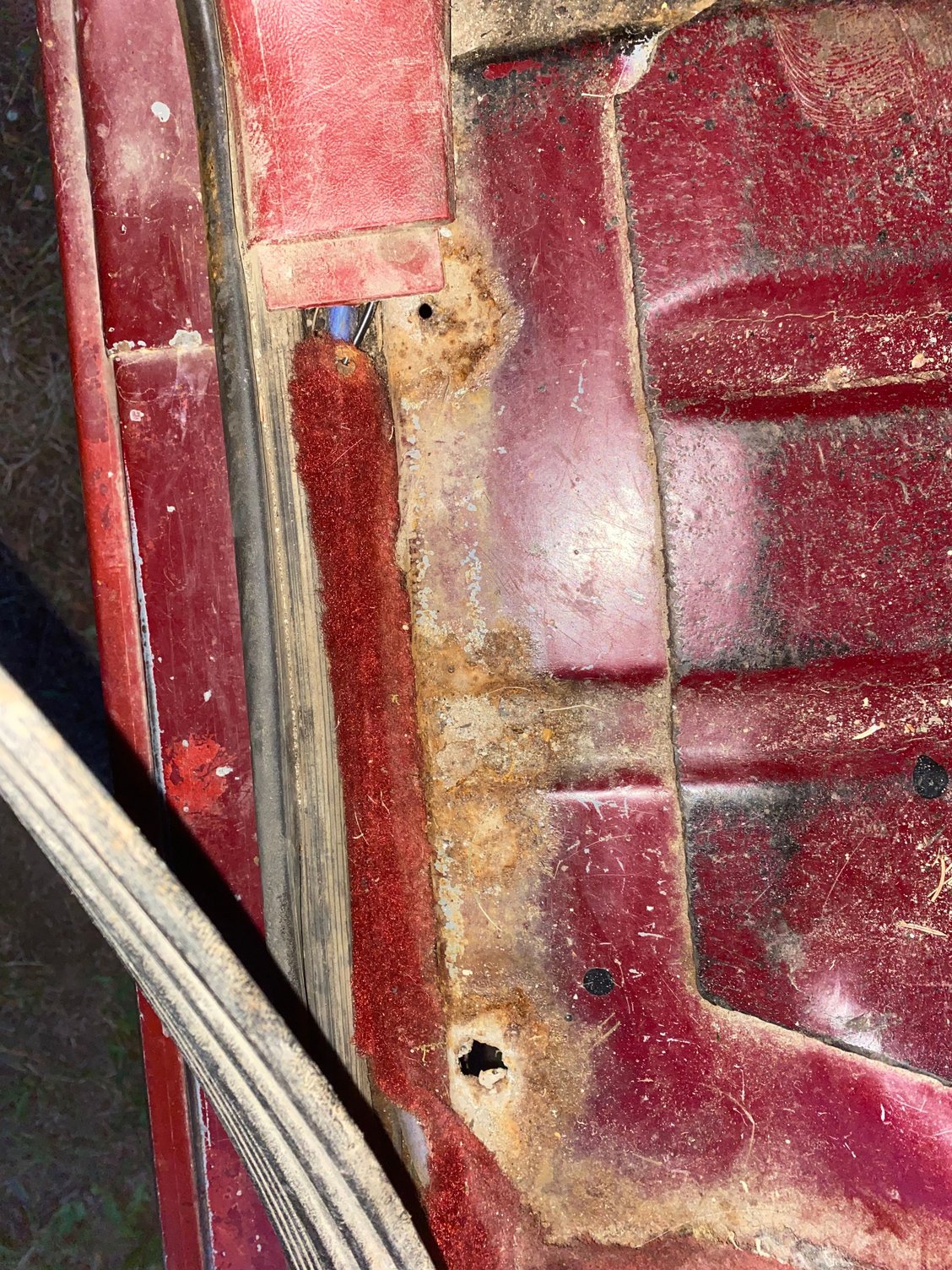

What should i do here?
I just bought the truck and so i am fixing up the little things that are needed to be done. There is a hole in the driver floor pan that is normally covered by the door, the rubber protector screw hole has been rusted out. It is metal in the cab and fiber glass on the under side. Here is a photo underneath what should i do.

Cut, weld, drill.
Or use some bolts and washers for a quick fix

LMC sells these replacement panels. You'll have to decide how to attach them, if you go that route.
Welding and panel bond are two options.
I panel bonded mine.

If you already have fiber glass in there, its a rust bucket.
Fix it properly once, or leave it, or get another rust free truck for the same price.

Sorry there is no fiberglass it is just a coating over the metal cab
