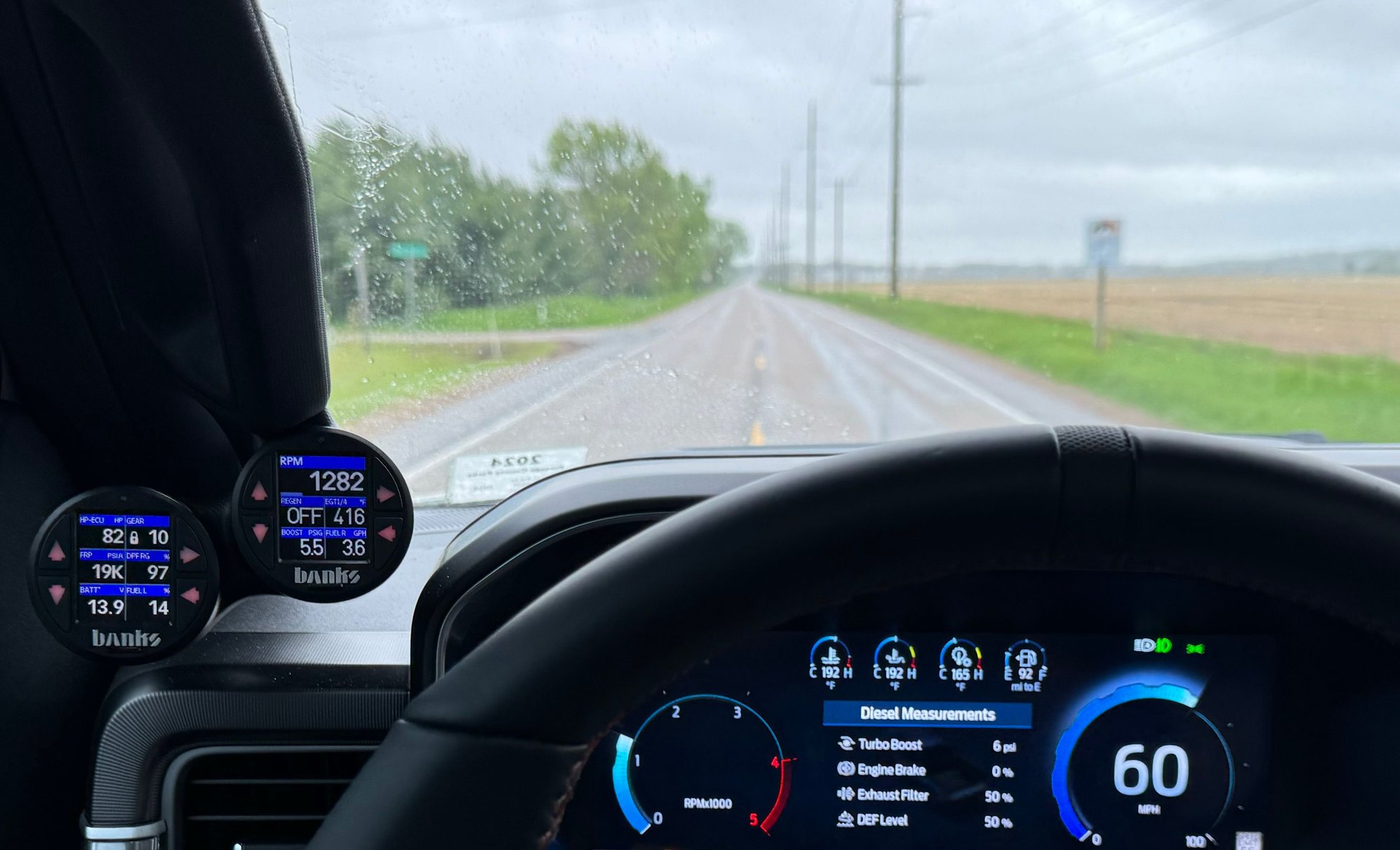

I’ve noticed that my DPF will read really low when compared to my idash. The Ford will display something in the area of 20%, while the idash shows 70%.
The interesting twist? When the idash gets to 100%, a regen starts. I’ve never seen it get to 100 and not start. The Ford display is a crapshoot when it’ll start. Sometimes the Ford is still showing around 40%. It’s amazing how different they are.
I have no idea what the Ford is reading, but it’s hard to gauge when you are about to hit a regen cycle when it’s lying to you. Either way, just thought I’d pass this along in case anyone else was looking for a reason to get an idash.
DPF % is on left pod, center right position. In this case it’s 97%, and the dash shows 50%.

The iDash is probably set on trigger while the truck shows percentage. Sometimes mine will trigger when the percentage is 40-60% but the trigger shows a more accurate percentage when it will regen. On a quick regen, the trigger will drop into the 40s. If it runs a full regen, the trigger drops down to 10 or less.

Yes the DPF regen trigger goes from 0 to 100%. It is not the soot load.
It (the trigger) is accurate. The trigger is at 100% and the pcm triggers the regen regardless of soot load based upon miles driven.
If the soot load were to get at 100% before the trigger then it will regen based upon soot load instead.
When you tow it may get the soot load down to zero but the trigger will still have it regen.
I think up to 2022 MY (at least on my 2021) you can use forscan and disable auto regen so as not to needlessly regen when the soot load is not calling for it.
To have it regen based upon the trigger for no reason other than miles driven is wasteful if you can stop it from happening.
Check out your DPFDIS for the average distance between the regens.

You are not interpreting what the idash is telling you correctly.
If you are talking about the one that reads 97 in your picture then that is where you are wrong, that is DPF regen %, not how much soot load is in the DPF. Basically that is the "countdown" clock to regen which on most trucks is right about 500 miles, so the truck will regen when it hits 100 whether the DPF is at 20% or 90% full. The only way the truck will regen earlier than 100 on that reading is if the DPF itself is actually full before that gets to 100.
This is why many people turn off auto regen and wait till the DPF is actually full because like you stated your OEM read out is saying 40% DPF full but the countdown it at 100 so it regens anyway. you are just wasting fuel, basically you can go twice the distance between regens if you turn off auto regen.
There is a different setting in the idash that will show how much is in the DPF but it reads in a different unit so it still wont line up with the OEM DPF screen, i cant remember the name of it without going out to the truck to look.
