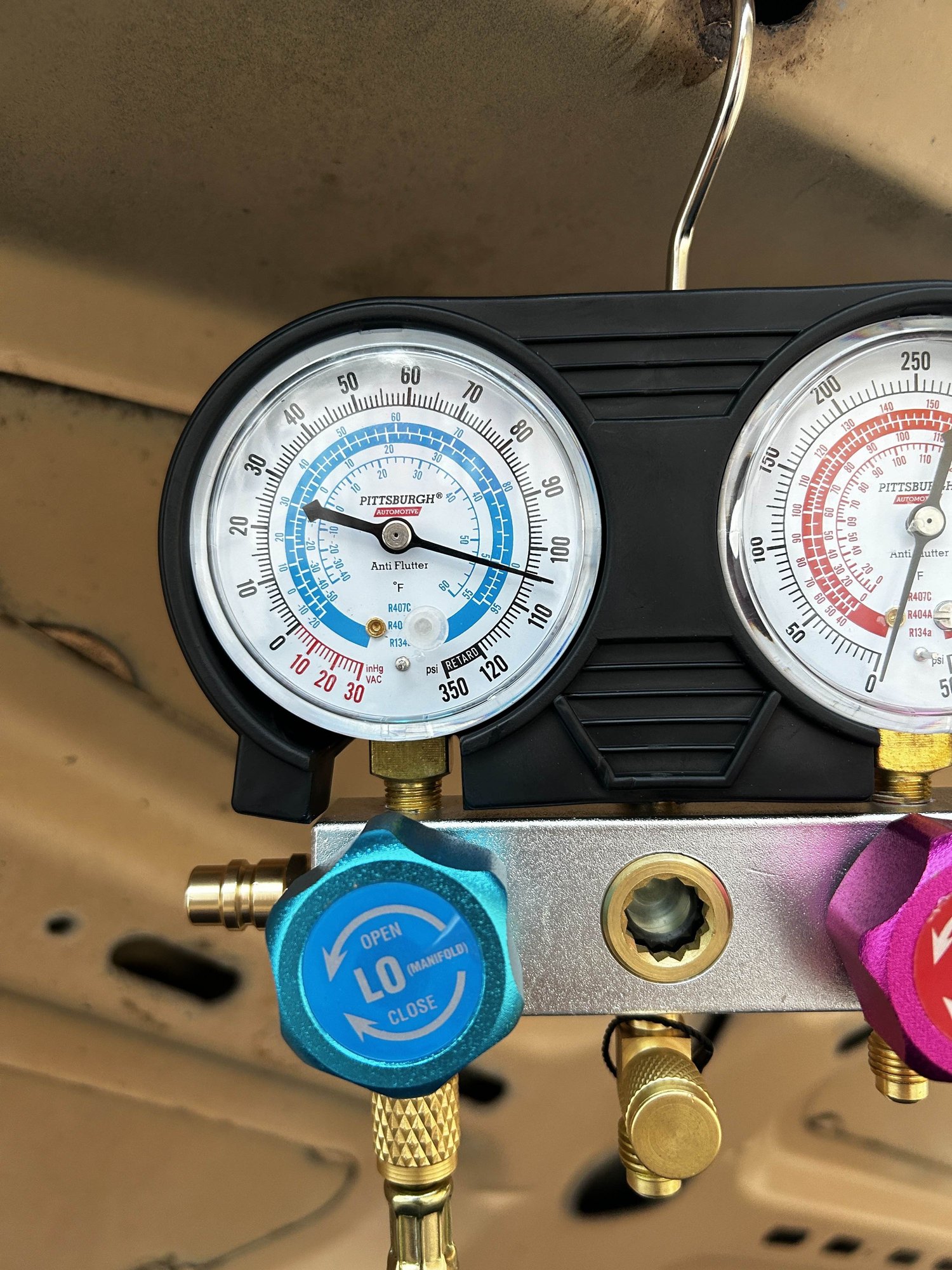

this is my reading from with the engine off. temp outside was 85-90 degrees.
this is with the compressor picking up and running

I have just posted my readings of my gauges under junktownbill99s post.
i have pictures there posted if you would like to see them. could you let me know if those are proper readings? is there something wrong in those readings?
I only have 18oz of 134a and 7.5 ounces of pag oil in the system which could maybe be why the pressure is so high?
my compressor will turn on for a while, and then it will continuously turn on and off.
Should i put more refrigerant and oil in the system?
im afraid to add more because if i have to change a part theres no point putting 30$ worth of gas in the system for it to be removed.
thank you

What are you getting on the high side? To me, it looks like the low side pressure is too low and the constant cycling means that the system is undercharged.
On the tube, the colors mean they are different sizes and yes BS that they would be the same size and different colors
I dont think it really matters what color you have in there now as long as it cools.
The low side reading high when off is normal as the system has equalized. Why dont you have the high side gauge hooked up?
You would see that they both would read the same PSI after a while when off. The hissing you hear it the system equalizing.
The on & off of the compressor is because it is low on charge.
The low switch should have a psi on the side of the psi it works at.
If you watch the low gauge you see it drops and the compressor shut off. The system then starts to equalize and the switch closes turning the compressor on till it happens all over again. Put more charge in it and the compressor will stay running and the AC will start to cool.
BTW 134a runs at a higher psi than r12 did so you really cant go by the r12 readings when switching to 134a.

20psi is nearly same refrigerant temp. That is why short cycling...system is low as hell, not even half charged. System off always high when ambients high. Basic pressure versus temperature...physics 101.

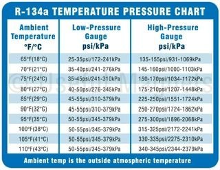

Should be 45-55 psi at 90°F but his gauge is only at 20psi.
Thank you i just charged my system and getting 45-55psi at 90 degrees out. Thank you for helping
