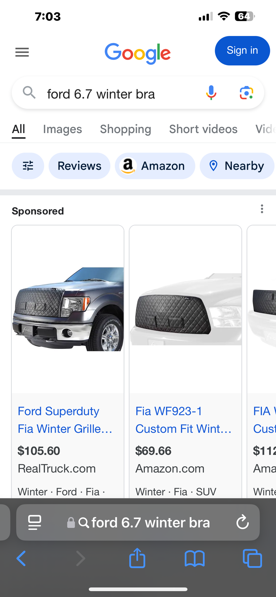

in the 90's I had a junk van . to get it to heat up faster...I would put some card board in front of the radiator.....I think 1/3 coverage
Old Oct 15, 2024 | 06:05 PM
