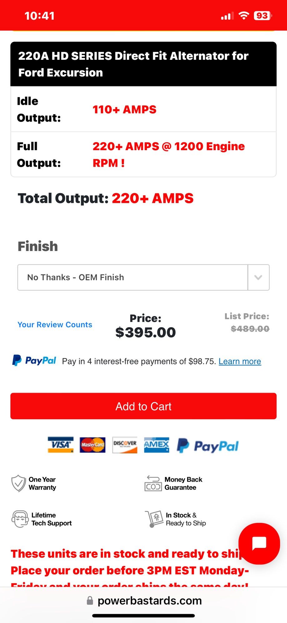

I used Power Bast****s 220 amp alternator, direct bolt in , New American made and I have great results. I have an 03 6.8 gasser but they have applications for all Ex’s . Runs around $395 with free shipping. Sorry wasn’t able to post a link

that is almost the same price I paid MechMan for the 320A alternator that I bought a year ago
