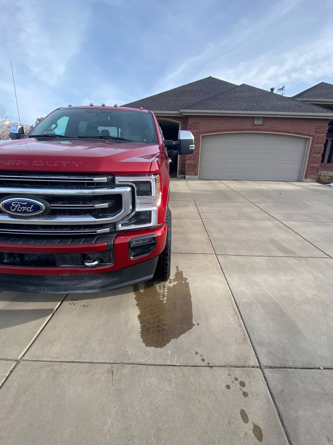

Mine are 20x9 0 Offset. in this photo wearing 35x12.5 tires

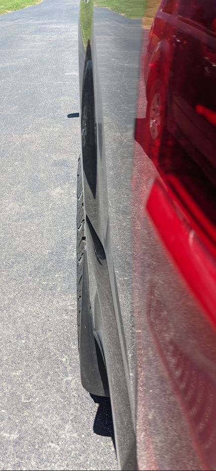

In this photo wearing LT295/65R20 tires
