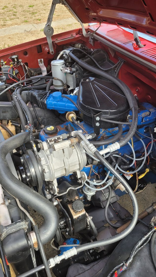

Thanks for that.
Thing is I am running a different compressor so I dont know if my picture would help or not and the compressor hoses are not run right.
The 80 -82 trucks use a York compressor I do not have a picture of that setup as I never had that system together.
My setup also has the shut off valves at the compressor.
This it the later compressor with the early HVAC box. The line across the motor to the HVAC box should go to the firewall and held there with a clamp like below. Dose not have the dhut off valve at the compressor so different hoses. Think the same for the York compressor?
Dave ----

Thanks for that.
Dave ----
Restauración de Dave usando un compresor FS6 más moderno.
