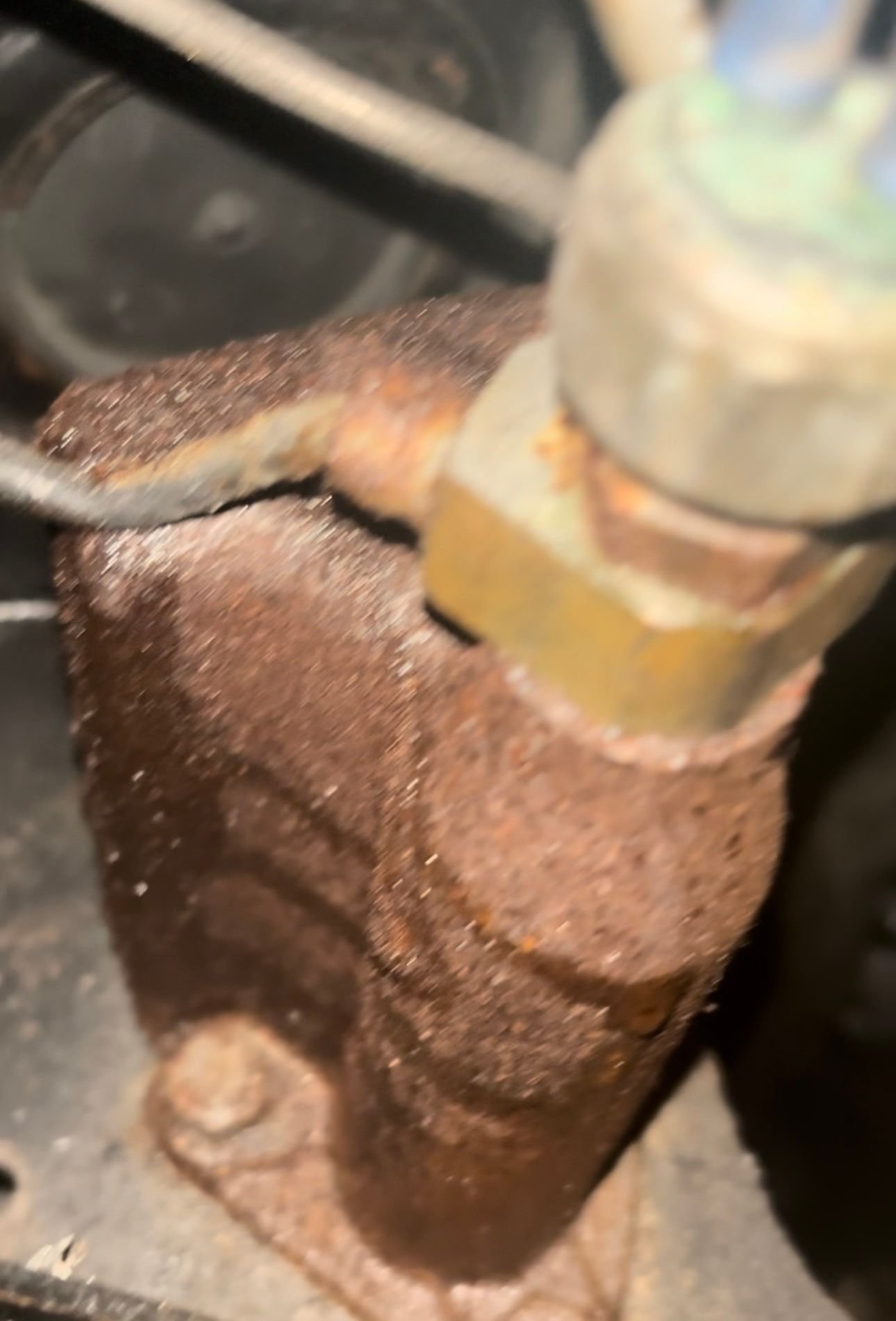

Ok I finally was able to get under the truck, well it’s pouring here and I was only able to stick my phone under it while recording and verify the truck still has the non power orig master, unless anyone’s keen eye spots something that I don’t lol.
The truck does have disk brakes on all 4 corners, and since this a whole new world to me, is there anything specific I need to order, or if anyone can post a link to the exact power booster I need to order, because I’m seeing 1” or 1 1/8” bore and I have no idea what will work best or I would need. We have a cruise and car show in the end of June we want to get the truck in so I don’t want to mess with returning anything at this point.

As asked before, which disc kit was installed? Your master/booster needs to be matched to the calipers specifications and the front/back circuits need to be proportioned correctly. What you show is a stock single circuit master cylinder which is completely inappropriate for quad discs.

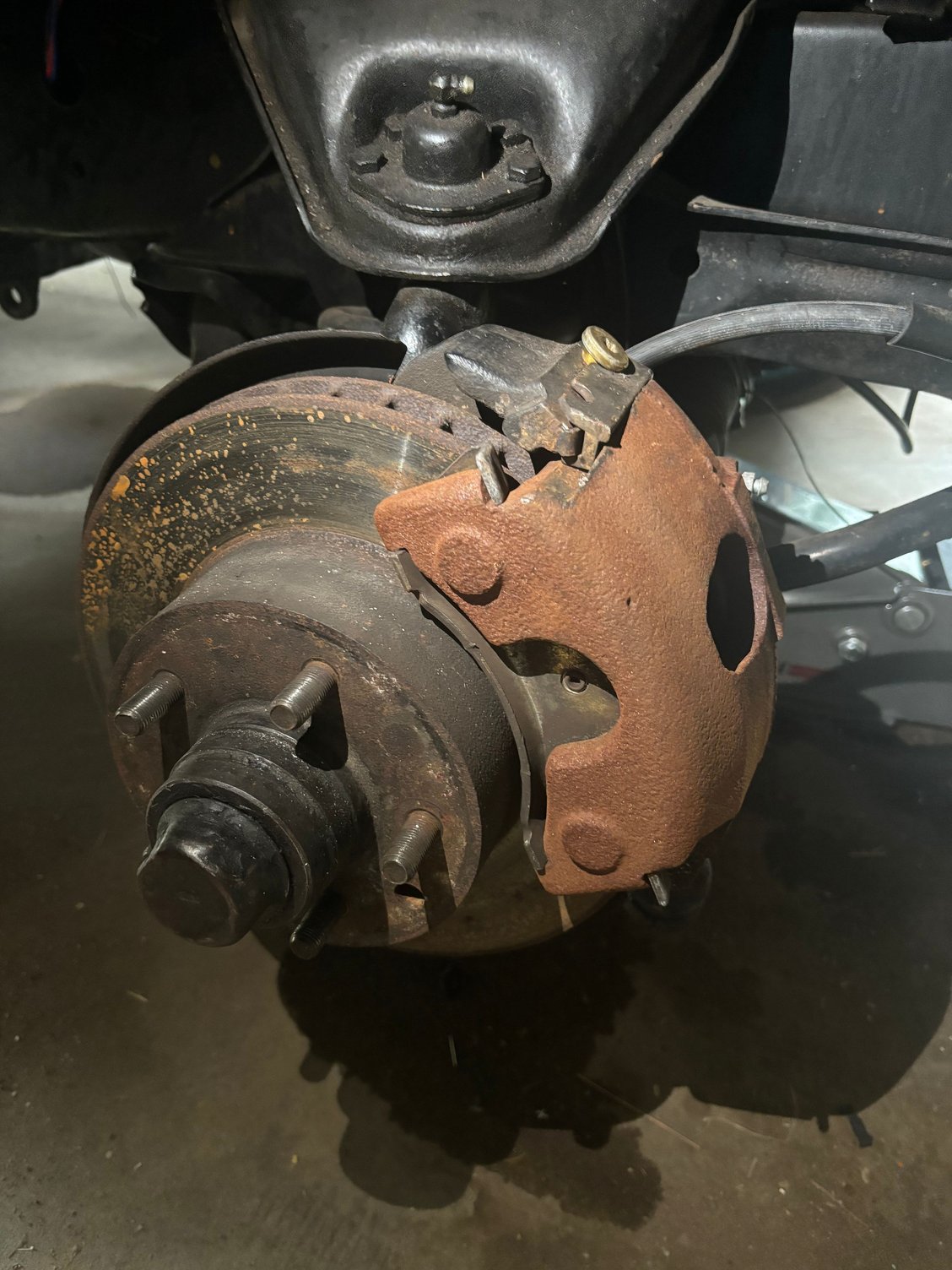

here’s what I’m looking at. I’ve never seen brake calipers like this.

Your brakes looks like old 70's Ford stuff. Perhaps Granada front, not sure on the rear. Been awhile since I've messed with that stuff.

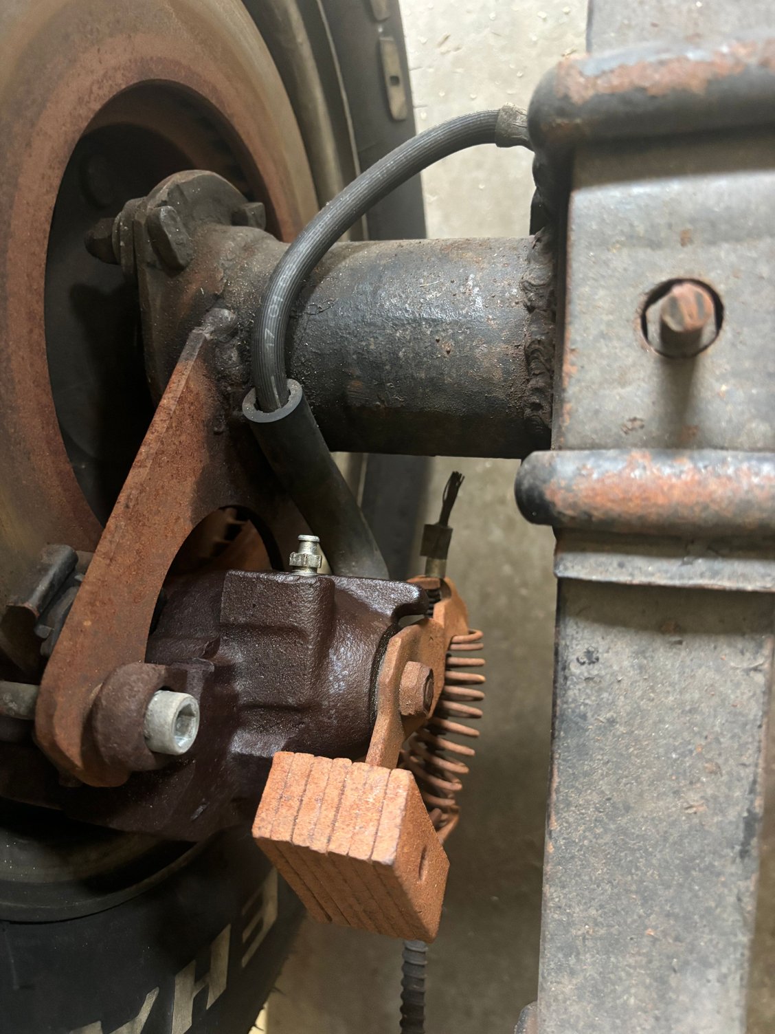

That welded on rear bracket looks a little scetchy .

that’s what I said too lol. A full system is in the future that’s for sure.

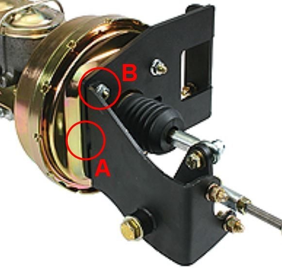

If you mean the weld at "A", it looks like that bracket is also angled and through-bolted at "B".

I meant the weld they used on the brake caliper bracket in my earlier photo. Idk when it was done and why they didn’t get a ford 9” bracket. But again he built this truck in thr 90’s so idk if there was even brackets.
