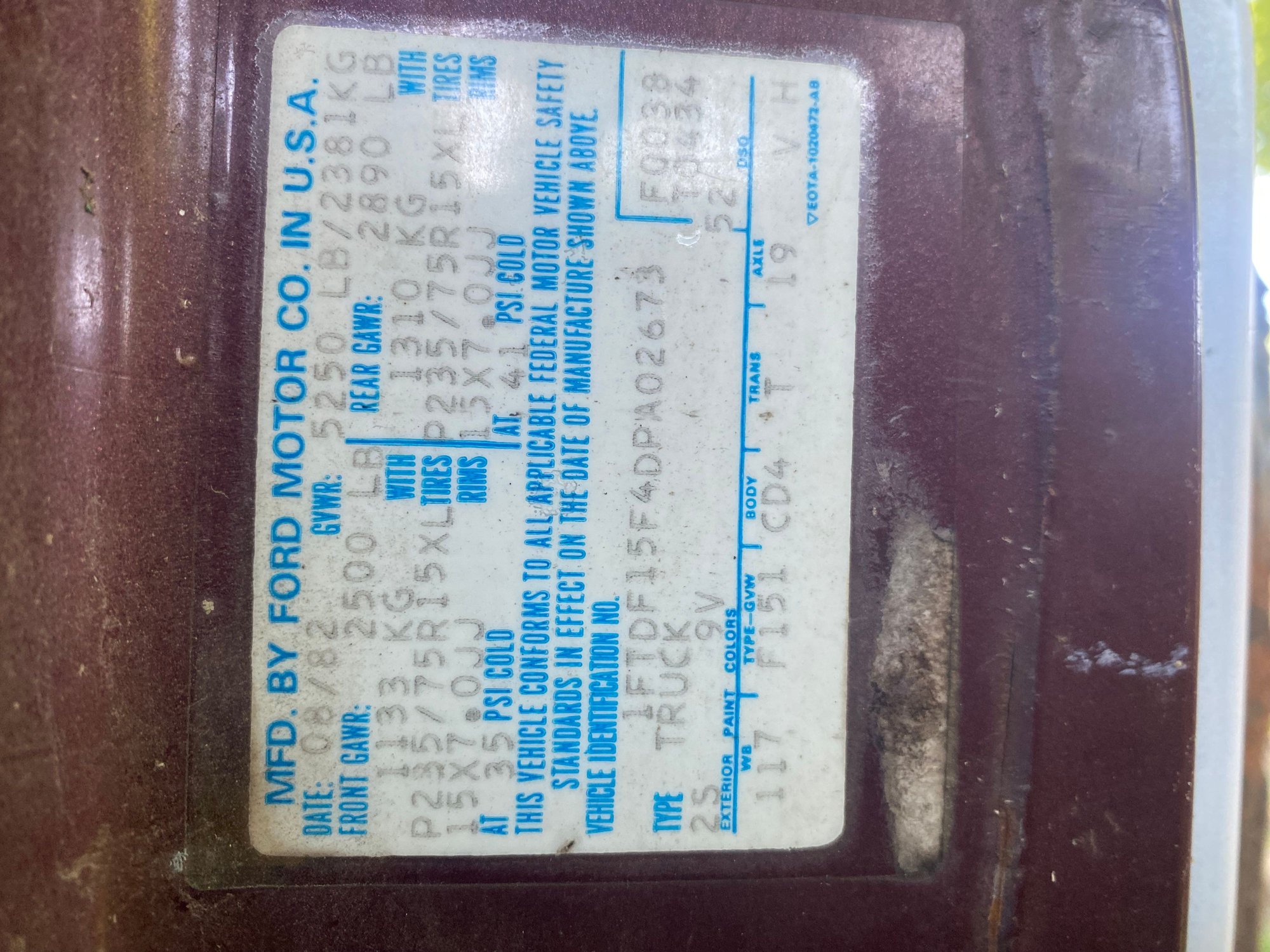

Hello there! I recently got this truck from a friend and I’m just trying to find out more about it from the codes. However I am not having any luck. Hopefully someone on here can help me out. Please and thank you

By the VIN I come up with
Looks like a F150 4x2 pick up
Hydrlic brakes and 5001 to 6000 lb GVWR
302 with v2 carb
VIN says it is a 1983 but the sticker has 8 / 82? Most of the time after Sept the year changes to the next year model?
Built in Twin Cities
The rest I will let you do as I stopped at red & gray for paint

Trans T is a AOD automatic overdrive transmission
Axle 19 is a open 3.55 to 1 ratio 8.8 rearend.
