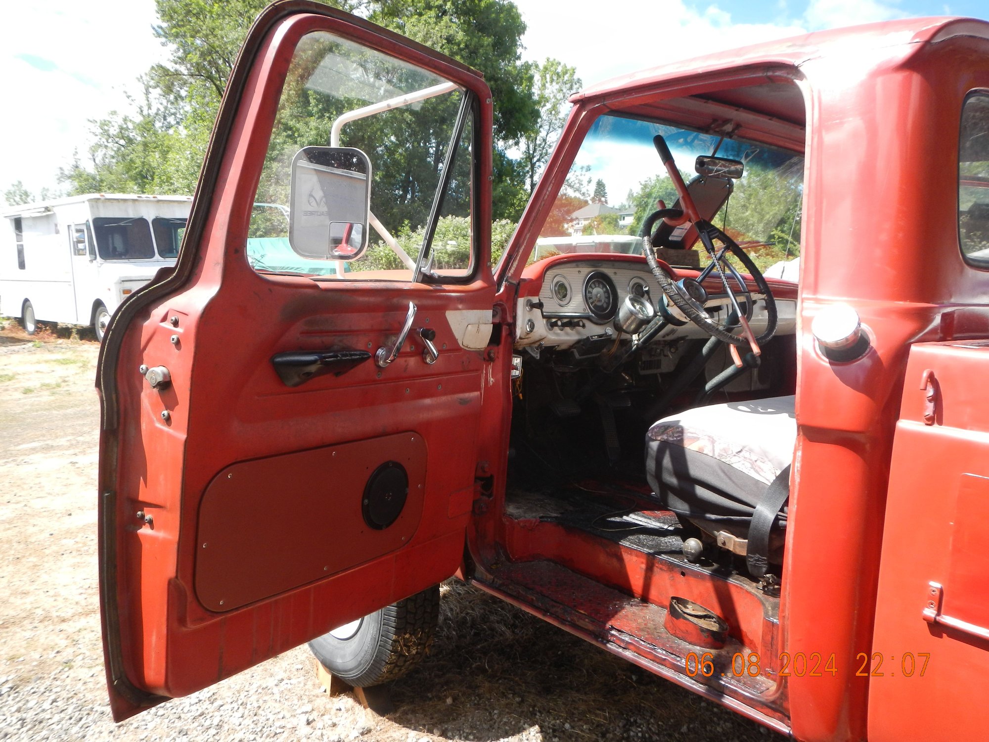

Been having some difficulty with the driver door. The door sems to sag just a little bit, not sure how the best way to fix this would be, to get the door to shut Tight (second click) I have to lift and Slam it shut.
Driver door Lock does not always want to lock from the outside using the key.
I took some picture from the inside of the driver door, looking up at the internal door lock and opening and latching assembly. I am adding a picture of one particular issue I found, where the blue arrow is pointing there is a bolt coming thru from the outside, into and thru a piece of square metal on the inside of the door.
"What.".. is the square metal piece?
The square metal piece spins along with the bolt that it is attached to. I am guessing that metal piece is broken off from something in there?
I am also attaching a picture of the bolt I am talking about.
I would like to know what this is so I can get the door linkage and everything to work as it is supposed to.
Thank You

If you need to lift your door to close it I’d start by rebuilding the door hinges.

Oh, and I believe the bracket you are looking at holds the window track.

Take a good look at the underside where the cab support is. Also where the floor and side meet below the hinge area. If it is rusty, damaged, etc. it can/will have an effect on the door closing.
