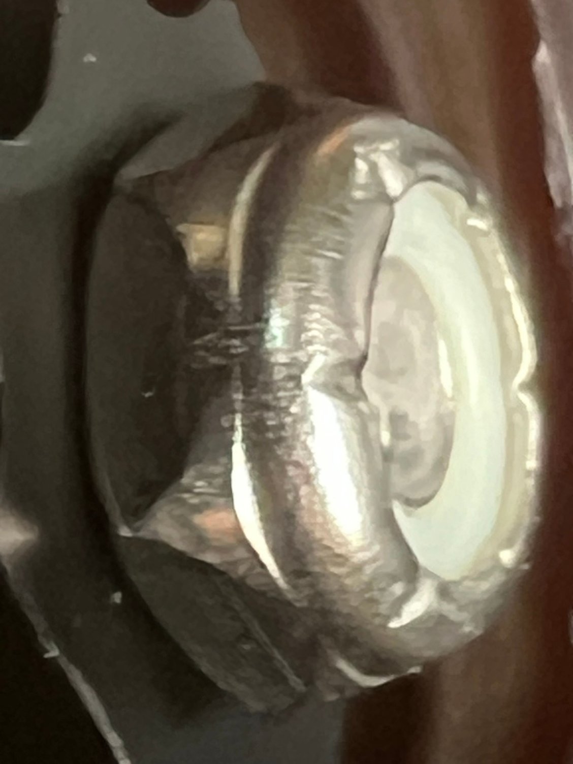

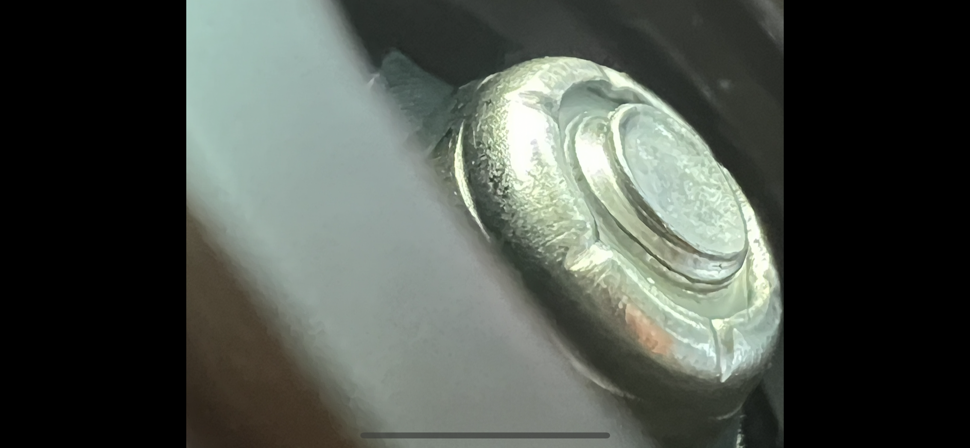

Got the BEM caps about a year ago.
while adding def today I noticed the cap has a nylon nut, which does not have proper thread engagement.
All I need is for this nut to fall into th def tank and lodge into the def pump.
bad cap design…they should have used a longer bolt so the threads would clear the nylon nut.
So I tried to turn the nut with out jamming the lock mechanism
i him I got just short of a turn on it and the threads cleared the nylon .

Really was no worry with it falling in and jamming the pump inlet, it has a screen on the pump that wouldn't let any debris like that from blocking it.
But even so, seems short sighted of the maker of the locking caps.

I checked mine at lunch and the bolt is definitely engaging the nylon. Glad you got yours corrected.

mine is fine too.
