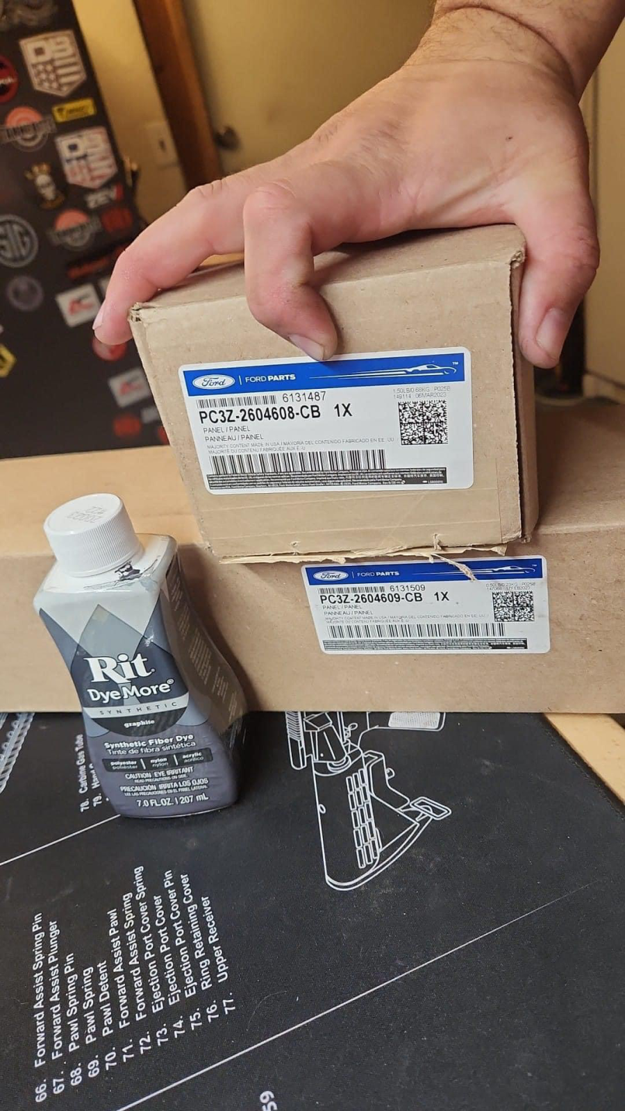

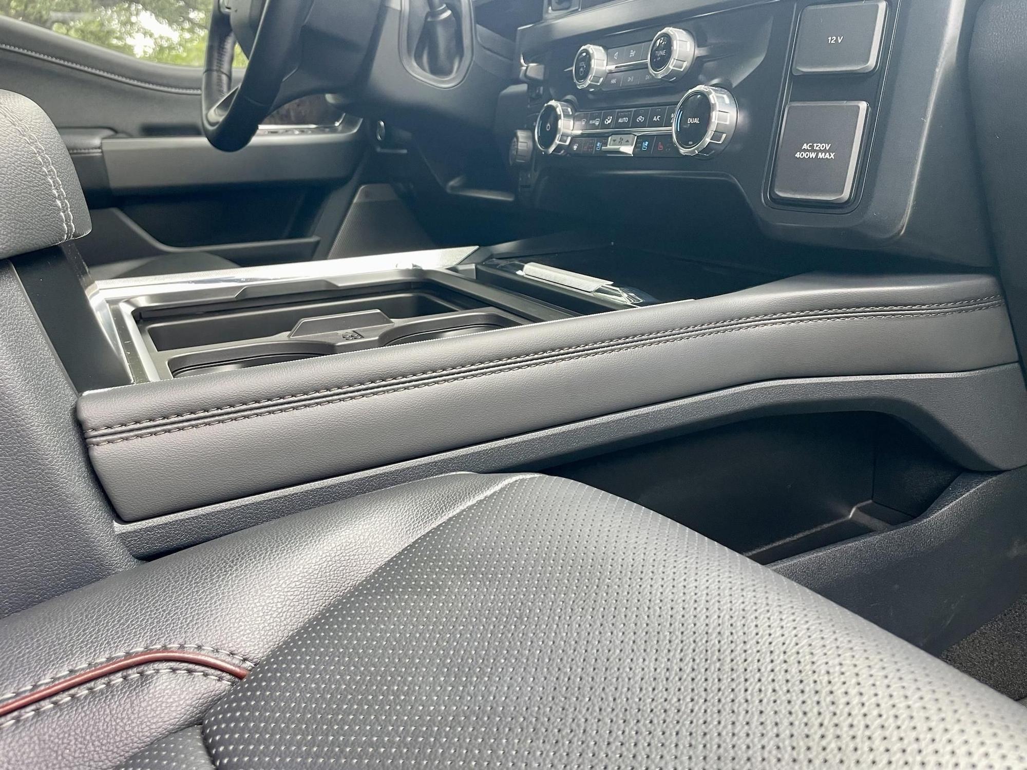

My 2024 Lariat had the dreaded plastic center console side trim pieces that squeaked to no end if you even got your leg/knee close to them. It was a cheap, awful design flaw.
I bought the leather wrapped trim pieces and installed. What a difference. Not only do they look better with my Baja interior, but they are now 100% noiseless.

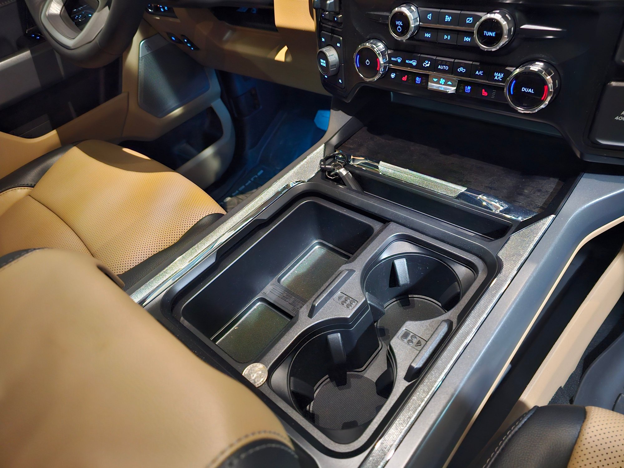

Oh... and the quarter wasn't to try to stop any other squeak... it's the DW's quarter for an Aldi shopping cart.
PC3Z-2604608-CB
PC3Z-2604609-CB

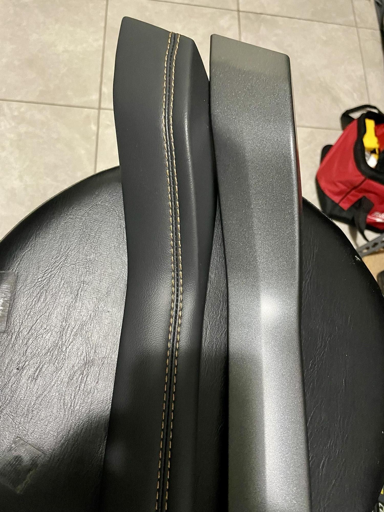

There isnt one. Black dye fixes this and youll never know there was beige stitching.

Qtip and drip it on each stitching and wipe up any on leather.

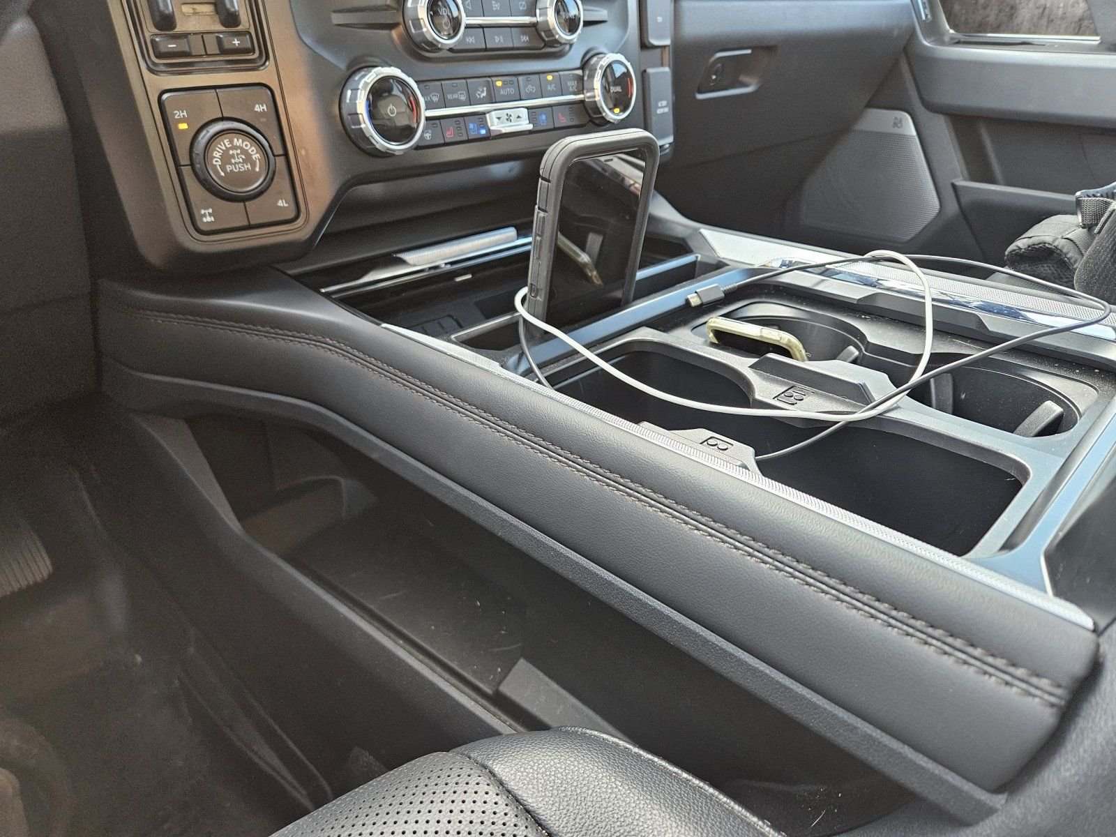

The old ones snap/clip off... the new ones snap/clip in place. 5 minute job once you have them.
I did not dye the stitching on mine as they match the Baja interior.
If you have black interior, then you'd likely want to dye them.
