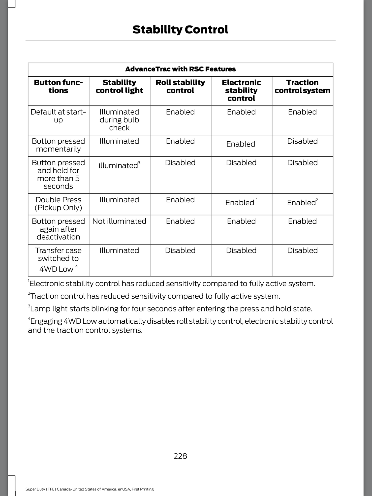

Originally Posted by bentring
This is probably the most important thing to remember. This is from the 2018 manual, no idea if it's changed since.
A lot of that is wrong unfortunately. The traction control and RSC are always on. Led me down the path of putting the ABS circuit on an upfitter switch to actually disable that stuff. The newer trucks might be programmed differently though.
OOPS! hate spreading wrong info so I edited it from the previous post... Pretty sure I stole that from you, and I remembered following that thread but must have missed the final outcome

That was another thought, that 4lo completely turns of RSC.
I don’t trust that it’s completely off after holding the button down 5 seconds. I have some horror stories about getting stuck in 2wd f250s, like it forces you to get stuck.
