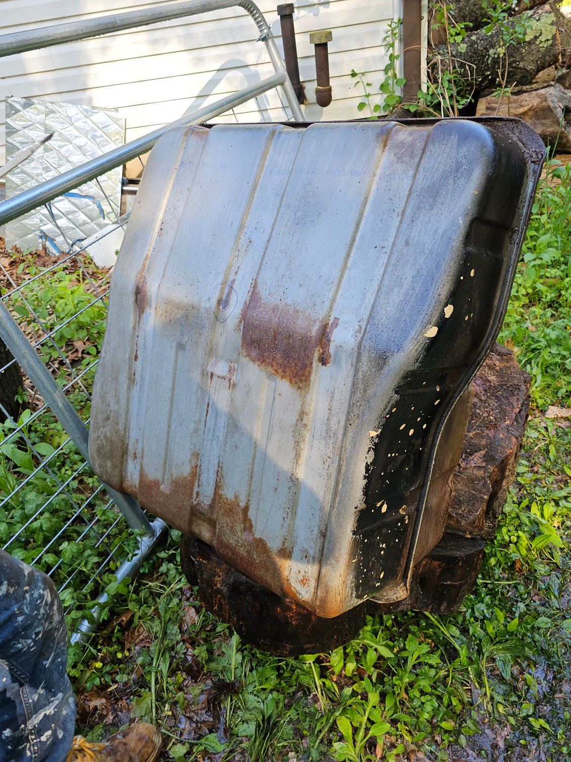

Previous owner used this 01 7.3 as a plow truck. Started leaking slowly. But in New England it's $4.25-4.50 a gallon so I had to get after it. It is pretty rusty in spots and looks like it might have had a thick coat of something put on some of the holes before.
Anyone know of a place to get tanks for less than a lot? Or something that might last me 5-10 years at low annual milage and no plowing?

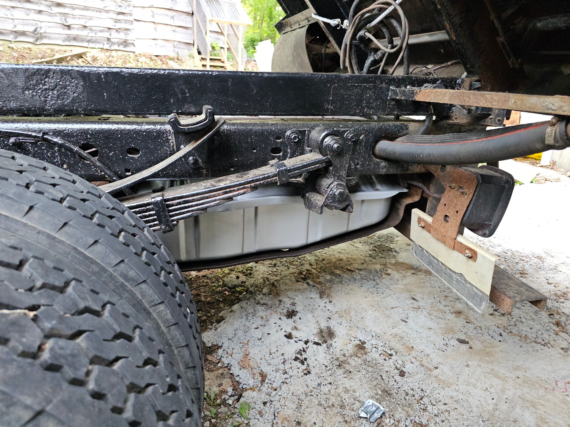

I ended up with this one incase anyone else gets in this same situation.

Looks like a good replacement tank.
Was the install straight forward, or did you have to do any modifications?

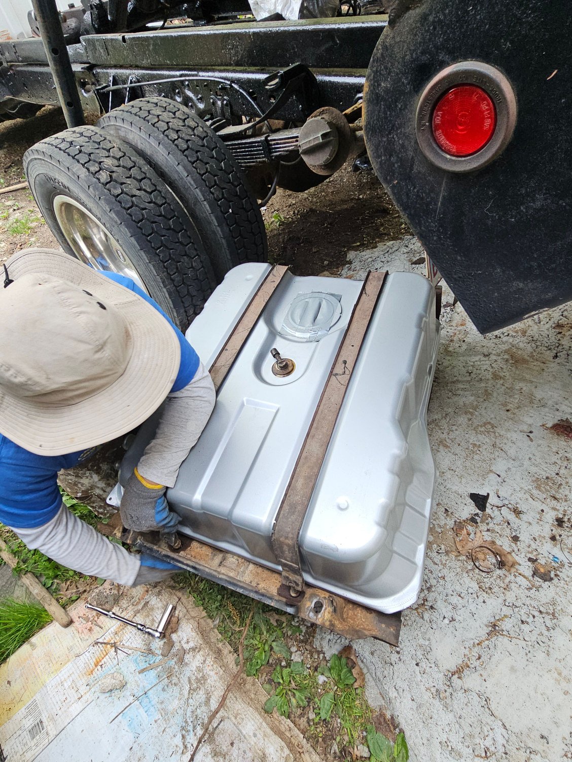

I'm supposed to get it Monday. I bet it is raw steel and needs paint. I have some black farm equipment Rustolium I'll put on it and let you know.
It should be galvanized or coated, so you shouldn't have to mess with any coatings. A good extra coat of something may help in longevity, or, may make it look good for a year or 2 and then accelerate rot.

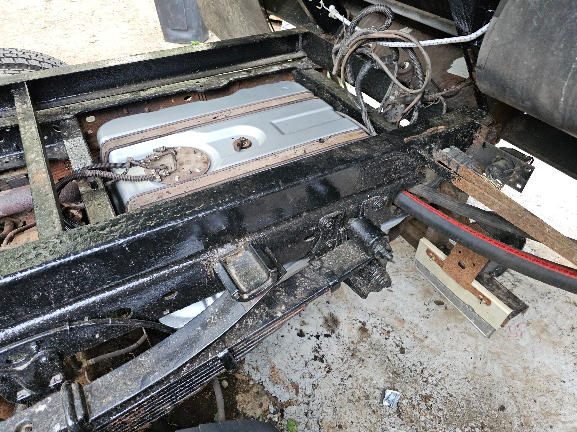

Tank is in but I have to work out of town tonight. I hope to get to it tomorrow.

Got the tank in and drove the truck around some. Everything fit and seems like nice stuff.
