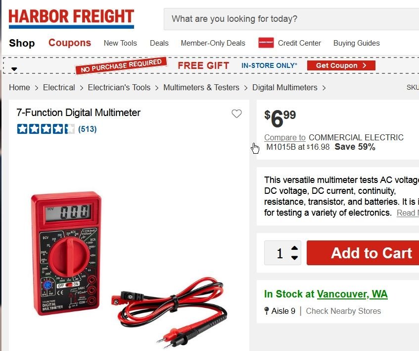

Great advice already given, all I'd offer up, on the chance you might not know, is if you have a multimeter, measuring across the battery terminals at high idle should be in the 14v area and pretty steady (assuming a high steady idle)
If you don't have a multimeter even the cheapies (that they used to give away) from Harbor Freight would work. I have a good Fluke meter but at $7 the Harbor Freight meter works better than I would have expected, just don't try to measure voltage if you have the meter switched to measure resistance (Ohms). The circuit isn't voltage protected and it kills that resistance measuring part of the meter, though voltage measurements will still work,....and I wonder though what practical experience I figured that information out :\
