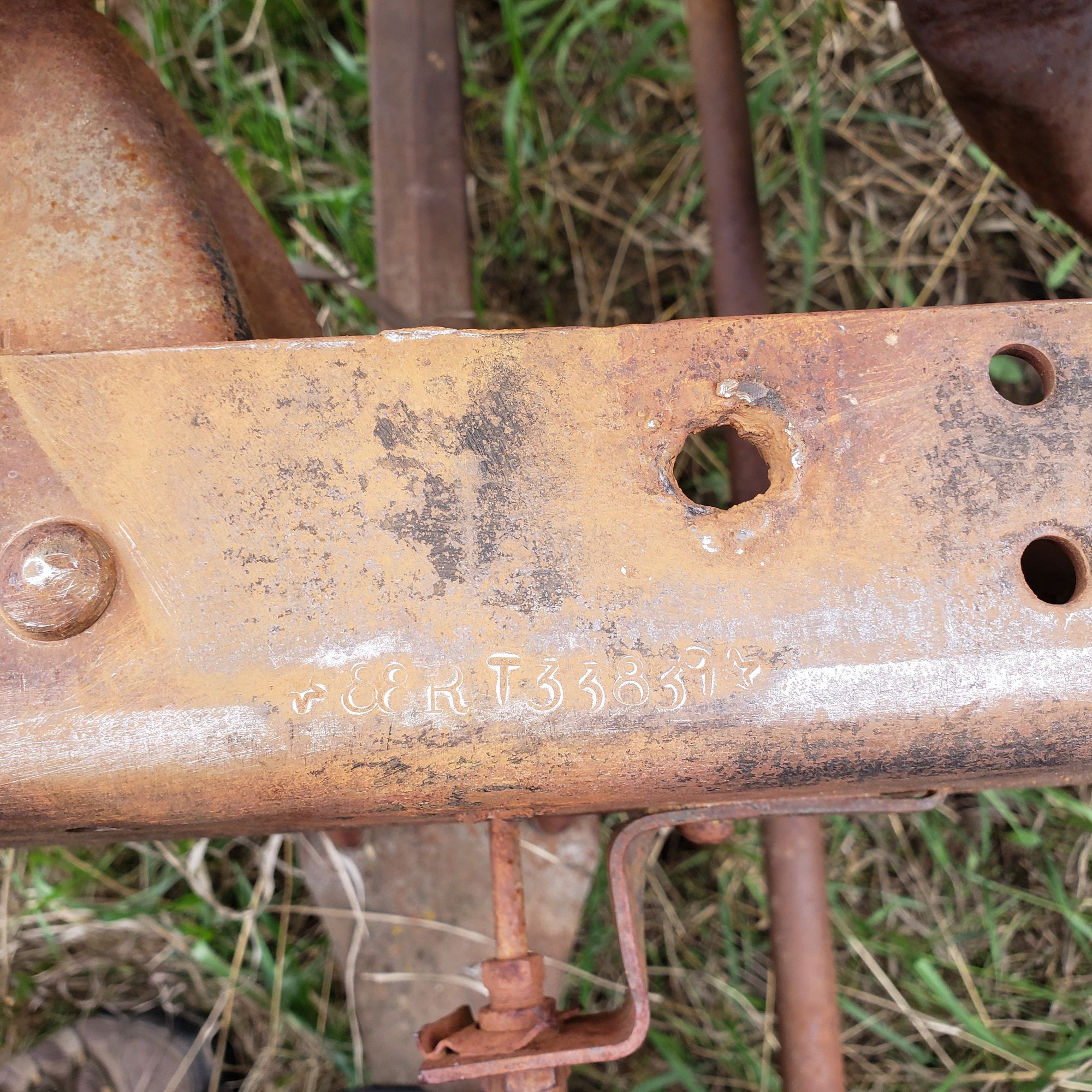

Sanding block helped. Edge of the left frame rail directly over the axle.

You would have thought that Ford would have centered it on the top frame rail.

The inside edge next to the bend will be stiffer than the middle or outside of the flange, so you could get a better, more clear stamping with less deflection in the metal from the hammering.
