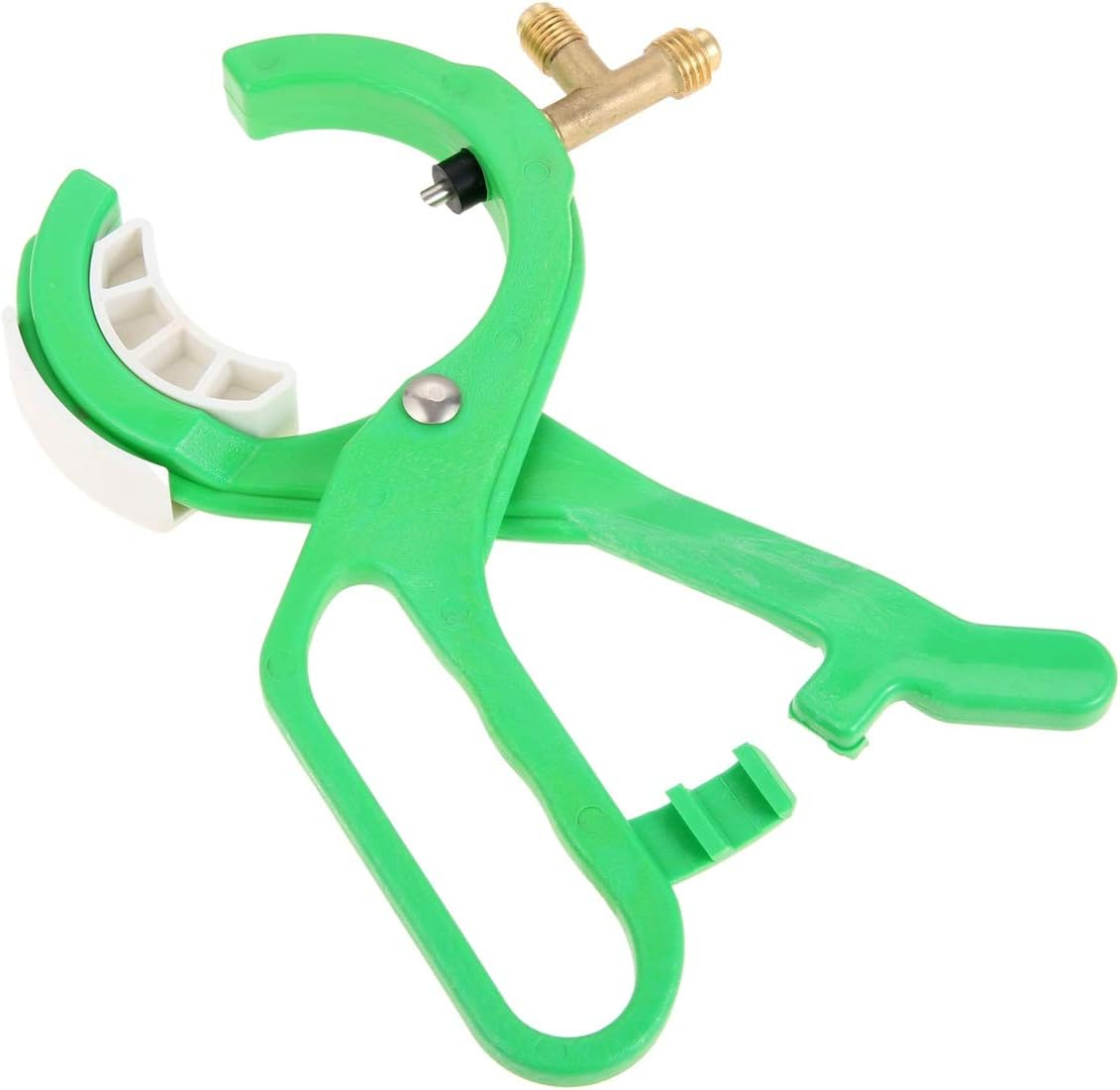

Thanks for the link. I have an older version, but it does not fit new R134a cans. I've got the proper threaded tap for the new self-sealing cans, but goodness is it finicky. Slow, too. There seems to be a restrictor inside. Worked on my car recently and was wishing I could have used a side tap instead. I though they were no longer available.
Here's a picture of the version you purchased:
This same adapter appears to be offered by multiple vendors, all from brands I've never heard of. I got to poking around and found Robinair makes their own version, part #10102, delivered yesterday:
Amazon Amazon
The Robinair version is a little more expensive, but note the two grey adapters. They are hinged and permanently attached, so it can fit three different can sizes. The Fling Dung version only handles two sizes, and the separate piece is easy to lose. I'll let you know how my latest toy works, but it might be a while before any AC service is needed.
https://www.amazon.com/dp/B0009XT7NY
I just bought this Robinair version as well but probably won't need it for many months to come. I am so done with most of the Amazon cheap junk.
