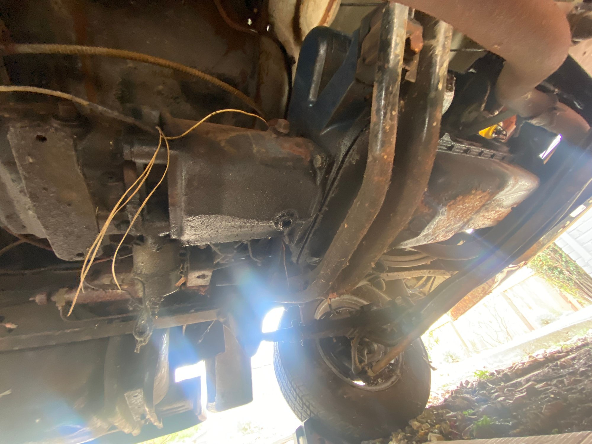

The truck seems to have a ton of flex, so I'm assuming the frame needs work. I crawled under the truck to see what's what and find the frame seems fine, but the transmission mount is missing (see photo)? Furthermore, the brake MC is right where a crossmember would have to mount. It's a 3 speed manual column shift (R10F-1 WG DIV stamp). The weird thing is, the engine mount/crossmember is nearly at the bell housing, and is just 2 bolts, and appears to be the only thing holding everything in. Is that right?? Is that enough support to keep the engine and trans in place? Would this missing trans support be causing frame flex? Anything else I should look at to address the frame flex? Are there frame stiffening measures I could so? (eg. Mustang guys use an x-brace welded to the frame rails)

The difference in frames between a 6 and V8 truck is the front engine mounts and crossmember. In your truck's era, you had one mount in the front of the engine and one on either side of the bellhousing, just like you have. Your transmission is not stock and originally wouldn't have had the mount on the tailshaft. There is no crossmember there, originally. You have the desirable overdrive 3 speed, so that, with your 6 cylinder engine would make for a really nice and comfortable, and economical driver, if it all is hooked up and working properly. There are manuals available to guide you through that process if necessary, and parts are available. Again, working with what you have will be far cheaper and can be just as enjoyable without scrapping the whole mess and starting over with a V8 and some other transmission. But this goes back to what I mentioned in the beginning, what is your idea of what you want your truck to be?

If the original bell housing mount was removed as most are with modern engines, there is a good chance the frame is broke near the cantilevered cab mounts. That original cross member did much more than just mount the engine and transmission. It also braced the frame in that critical area. These frames are only good for about 300 horsepower and that is with careful usage.
With independent suspensions you really do not want the frame to flex. The frame should be boxed if you go over 300 horsepower. The frame must be perfectly level and square when it is boxed, otherwise it will never be correct. Once boxed, the frame will not move much.
