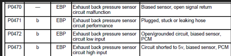

That P0470 points to an electrical problem with the sensor/pigtail or associated wiring I think. Another check to confirm would be to look at EBP_A and MAP PIDs in FORScan/FORScan Lite with the key on engine off, and see if they match within 0.5psi. If the EBP sensor has not been replaced in its history to this point, it's not a bad idea to change it out with one from a reliable seller like RiffRaff or dieselorings.

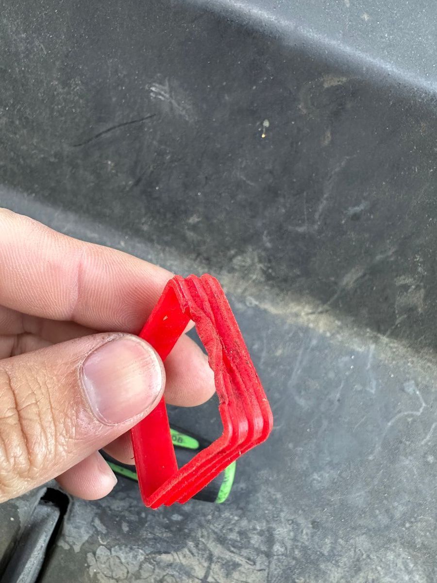

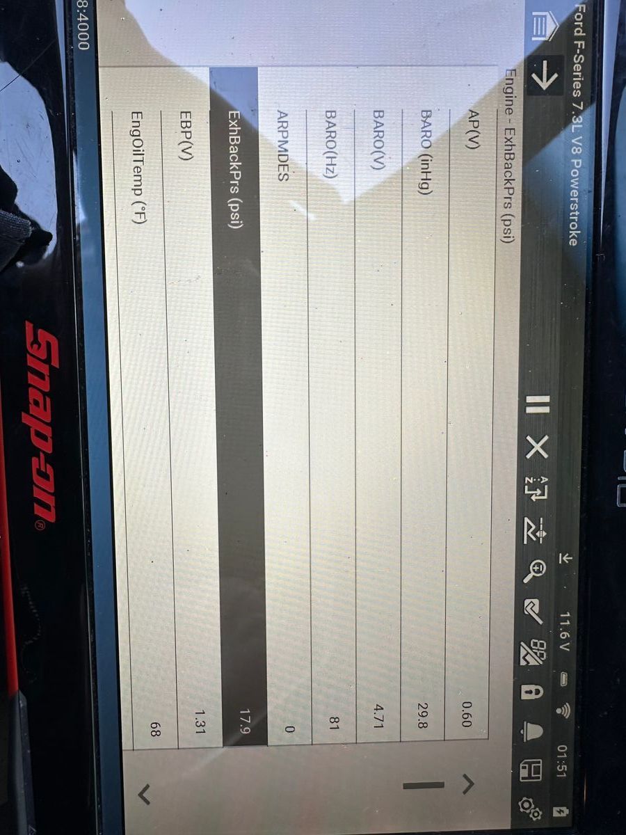

So I've heard back from Orangevale Diesel. Seems the glowplug connector needed repaired. After I had pulled the connector, and checked resistance, the code hadn't stayed cleared so I just decided to take it in. The day I started it to drive it over, no SES light. They sent me a picture of this gasket from the connector. All fixed I guess. I think it mentioned other codes were dealt with so I will see what's left over when I get it back.
They said the EBP should be replaced, but I think it's worth seeing if it is clogged anyway, and can easily replace the sensor (I have a socket for it now). This is something I can do with an hour of free time on the street. They also said the WIF light was flickering which I hadn't noticed, but quoted $230 for fuel filter change. I have one here already and can drain and replace that and see if that light still shows up. Another thing I can do with just a little spot of time.
