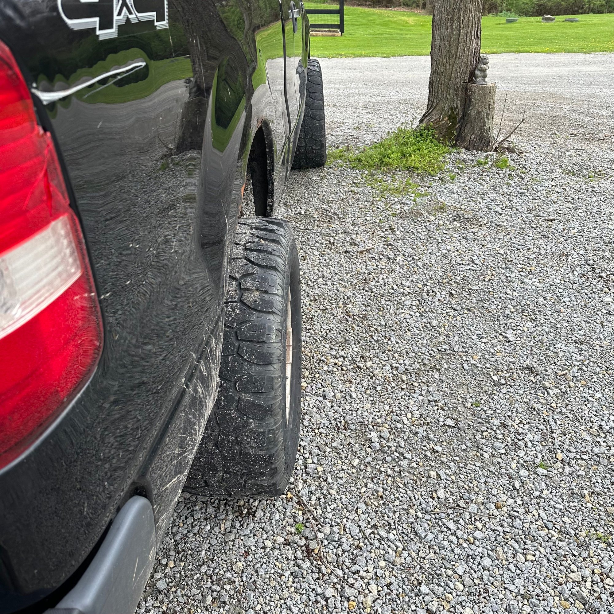

The wheels on there now are 6 lug aftermarket with way more negative offset than we want. So that’s the reason for swapping. The tip about salvage yard is a route I’ll look into. I didn’t think of that.

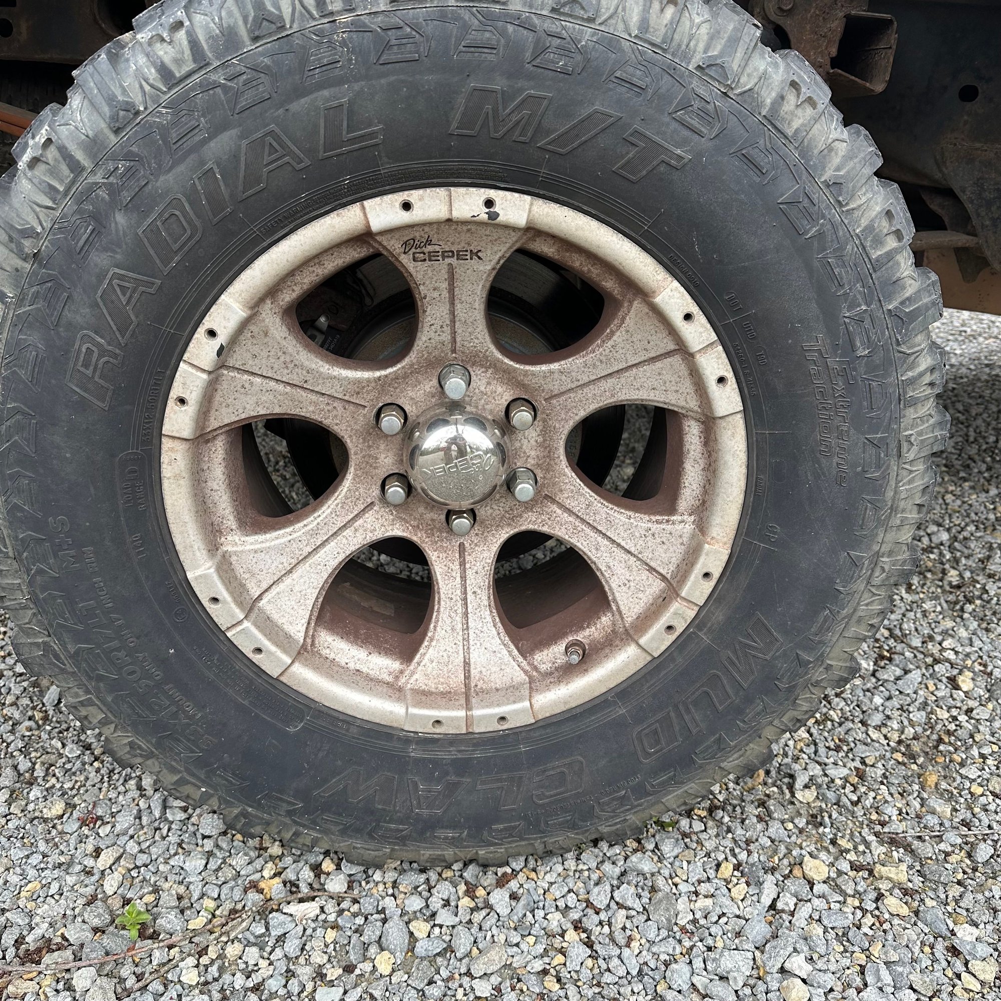

Originally Posted by Quad Racer
What are you going to do with those Dick Cepek DC-1s when you remove them? Is one of them damaged? Too bad they aren't 8x6.5" to fit my Bullnose truck. I'd be all over them like a rat on a Cheeto.
I’m going to post them on FB marketplace in the hopes of recovering some of my money lol. There seems to be no damage. They’re fairly dirty though.

thanks. I figured it wouldn’t be plug and play lol. I may try to track down some 07 wheels before all that. Or maybe just go aftermarket. To be honest I don’t know what if any changes were made to the lugs already to run the wheels that are on it.
No, they will bolt right on, you just need the right lug nuts. Anything will look better than having those zero offset wheels sticking way out the way they are now. The lugs in the picture wont work though. Funny how there's 2 long and 4 short lugs. I wonder if there are spacers behind those wheels?
There is no spacers. I’ll have to order some new lug nuts as it seems there’s a plethora of different ones installed currently. I’m supposed to pick up these take offs this evening but won’t believe it until I have them in my truck as a few deals fell through.
