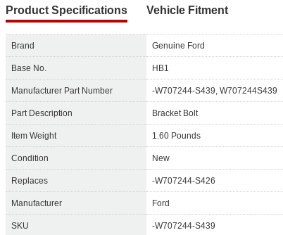

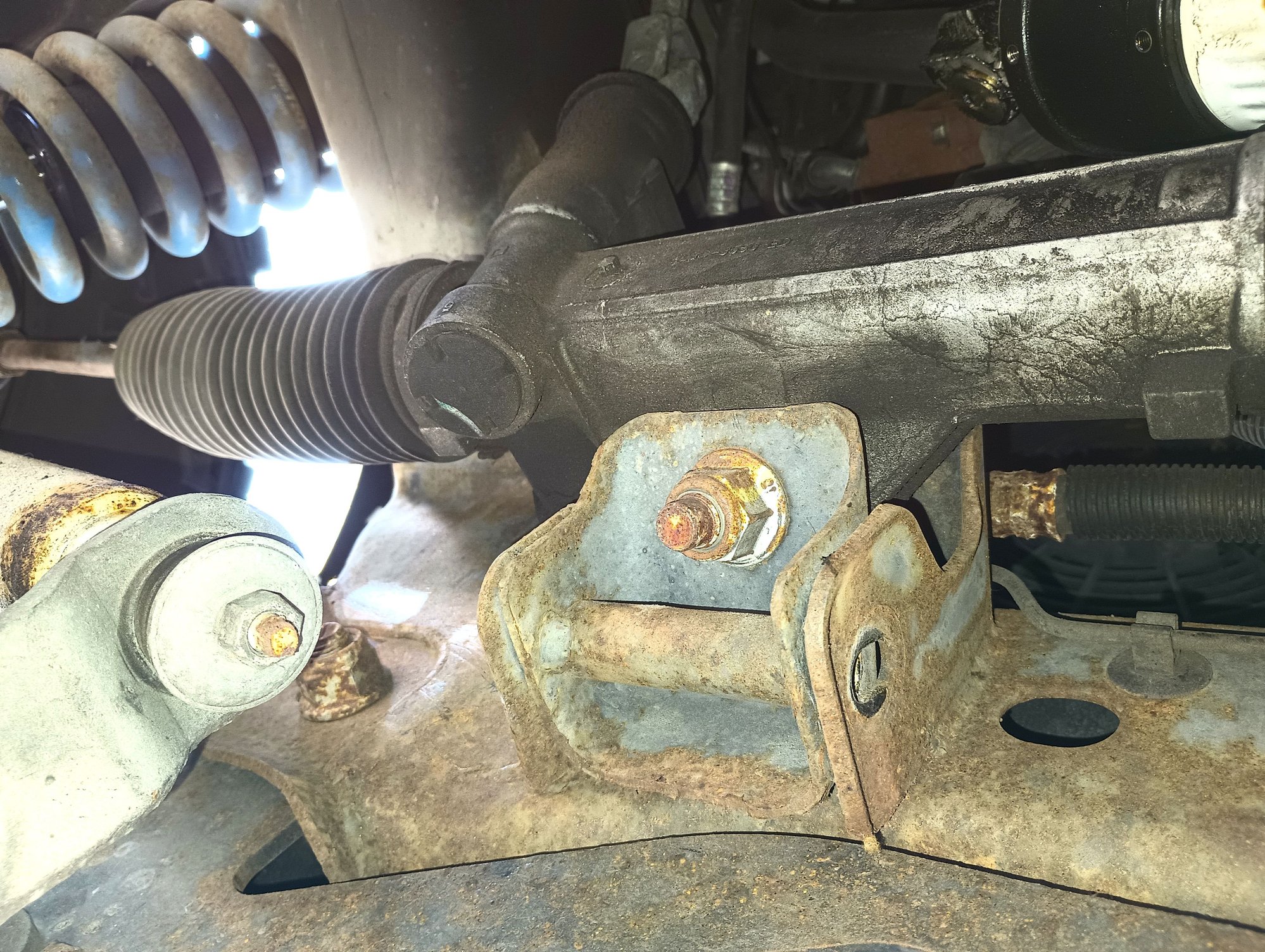

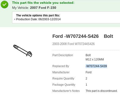

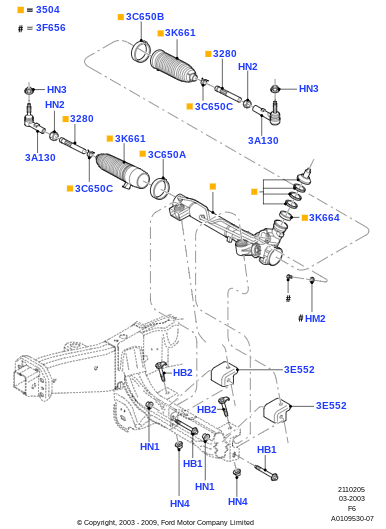

Mine disappeared. I don't know how that happened. The part is now obsolete. Discontinued. I found a suitable match. Here are the part numbers if anyone else runs across this.
