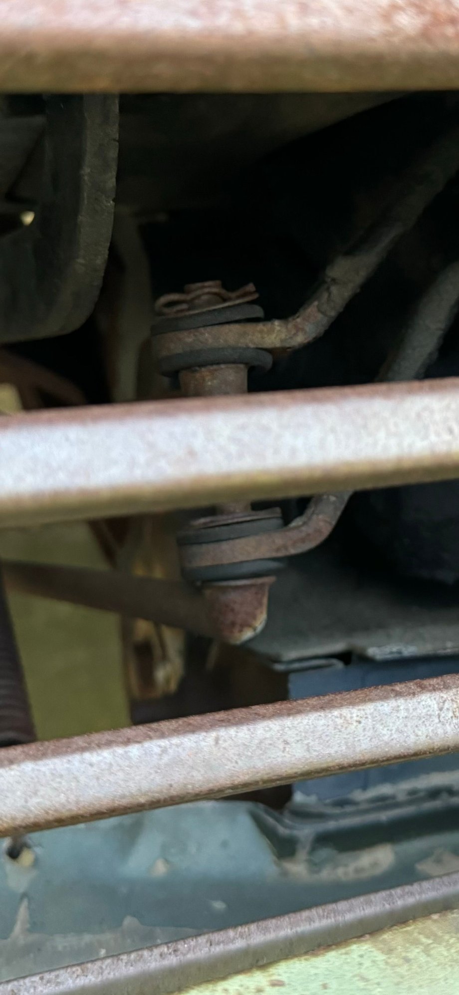

Hi guys, I’m trying to confirm the FoMoCo part#, I think C5TZ-7343-A might work but wanted to confirm with you experts!

C0DF 7343-A is what the Ford parts book says.
(0.33" - 0.34") I.D., 0.45" O.D., (0.368" - 0.372") long
I do not know if the part number you mentioned is a replacement for that.
Here is the exploded drawing for 1961-1967 Econolines with a parts list under it.
