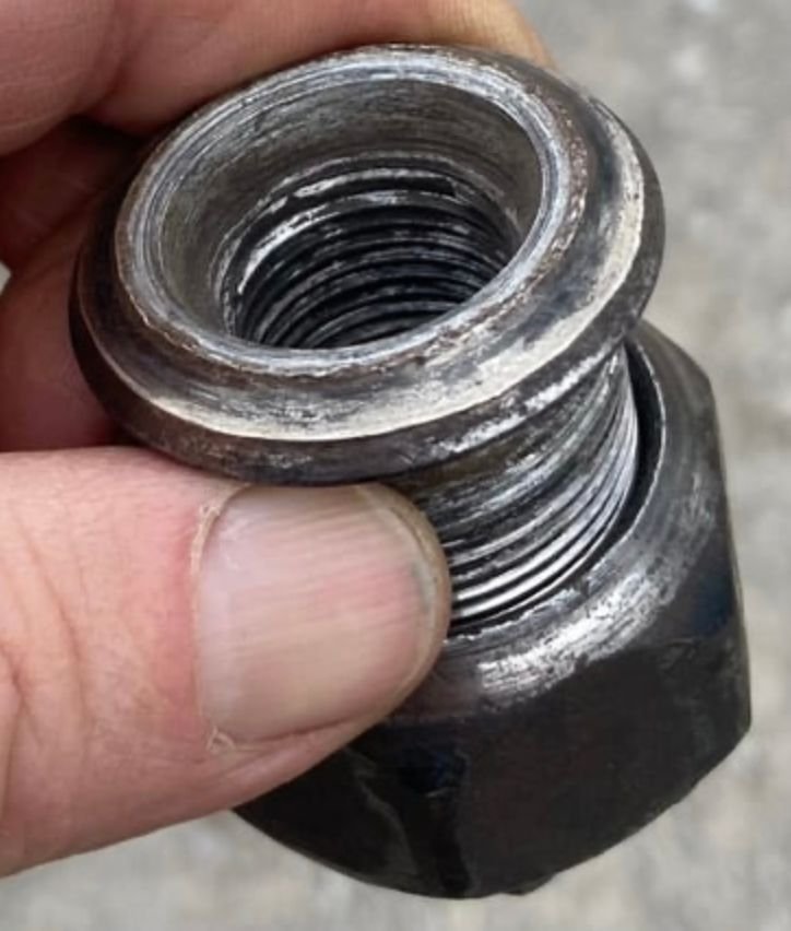

When ever is event happens replace both pieces, even if rust caused the nuts to seize together they will now have gaulded threads that will continue to cause problems in the future
Looking at the photo one can see the damaged threads in the inner nut were it spun on the main stud, trying to reuse it can result in damaging the threads on the main stud requiring it to be replaced

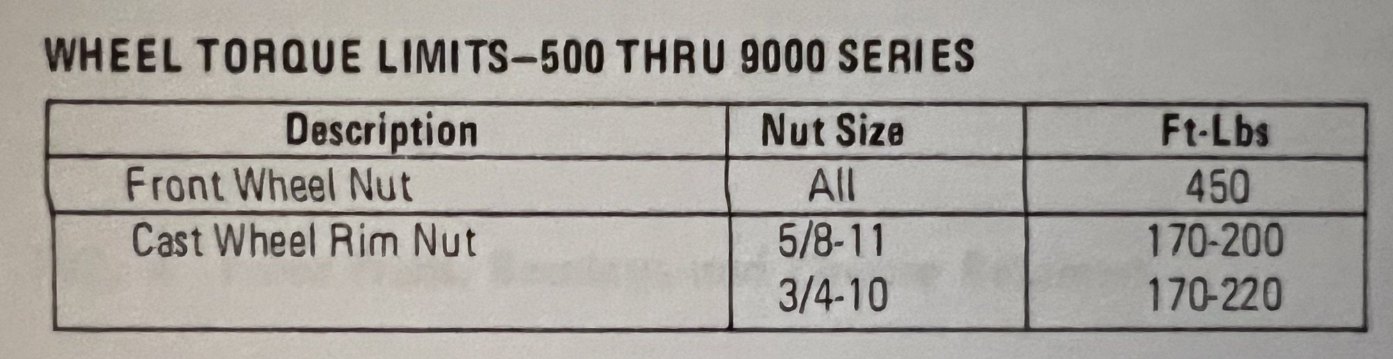

Let the arguments begin. The Budd 450 lb torque rating is dry torque. Anti-seize is not to be used. As described below. Stu

Agree that the 450 ft/lb figure is for dry threads. As one who has had a cross-wrench bend and break whilst changing a tire on a fast-traffic bridge, I'm firmly in the camp of "always use anti-sieze", "always use Lock-tite", etc.

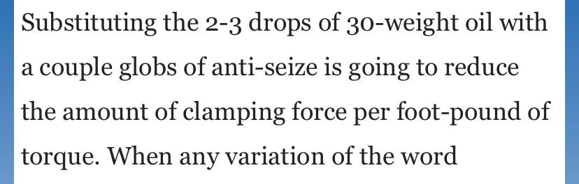

Regarding Mr. Rohlwing's article referenced, this one line has me discount the entire premise he attempts to make:
Originally Posted by Kevin Rohlwing
Substituting the 2-3 drops of 30-weight oil with a couple globs of anti-seize is going to reduce the amount of clamping force per foot-pound of torque.
In fact, the opposite occurs: reducing the thread friction means more wheel/hub clamping force is applied per unit of nut torque applied; this is why when using a thread lubricant the dry-torque spec must be reduced, to avoid over stretching the fasteners ("torque to yield") on fastener applications designed for repeat usage.
(now we can move on to the "best" oil brand and viscosity, and the "wrong" spark plugs to never use . . . etc. )

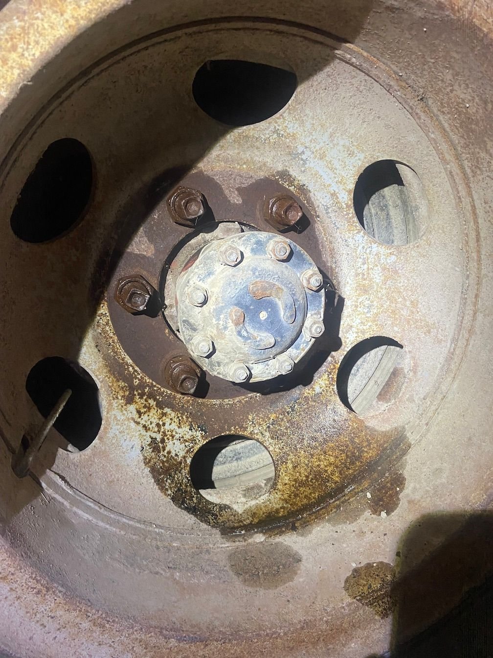

My 93 F-800 has stud mount wheels, we replaced all of the tires last year along with swapping on a set of aluminum Alcoa’s
The old wheels hadn’t been off the truck in over 8 years, had it at a neighbors shop and asked if he had a big air gun (assumed he did since he owned semi grain trucks), he handed me a Milwaukee Fuel 1/2” drive 18 volt impact with a 3/4” adapter and lug nut socket. I laughed at him, then used that battery impact to rip the lug nuts off easier than any air gun ever did, it pushed two of the studs in when the inner nut spun, now I have one.
