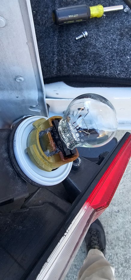

I have the dreaded fast blink in the cab of my 2019 f350. In an attempt to fix, I replaced all 4 light bulbs in my rear housings, not the reverse lights. I also used compressed air and dielectric grease on all 4 sockets. No luck.The upper blinker on my left side works and the lower blinker on my right works. In the non working blinker sockets, the tail lights still work.
I also took apart the main wiring harness next to the spare tire, blew it out and added dielectric grease. Still the same issue.All 4 of the sockets look like they may be the cause due to excessive heat. Is my next step to replace the sockets? I have the blis tail light system. I'm not sure if I just replace the sockets or get an entire socket assembly (all 3 sockets per tail light).Any advice is appreciated.
