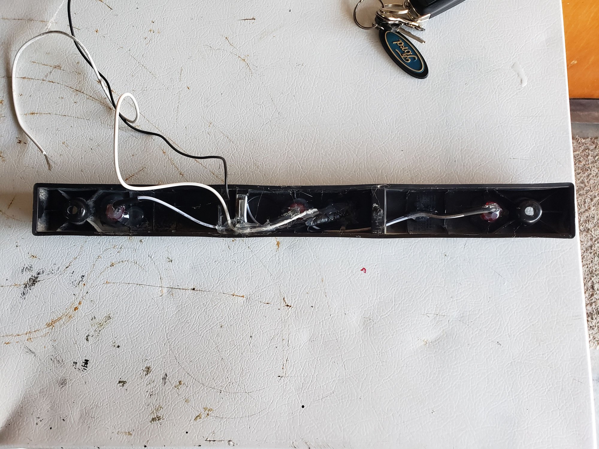

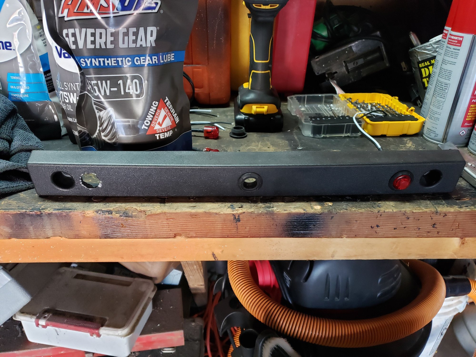

I’m doing something similar. Used the existing plastic piece under the tail gate and made running lights and brake lights out of it. My truck came with 5th wheel prep so was going to tap into that 7pin plug in the bed. Easy access and well protected in the fender. But I’m getting weird flashing with the lights. Currently have the light attached to a 7 pin plug for troubleshooting before I tap into anything. Tried using resistors and eliminated the flashing issue but then I get a trailer warning light. Could be because of only using the brake, running light and ground wires in the plug. Needless to say very frustrating for such a simple mod that would take 10 minutes on a non computer driven vehicle. May look at tapping into a brake light wire and running light wire if I can do it without cutting anything.
That's what I did, I wired it into my license plate bulb.

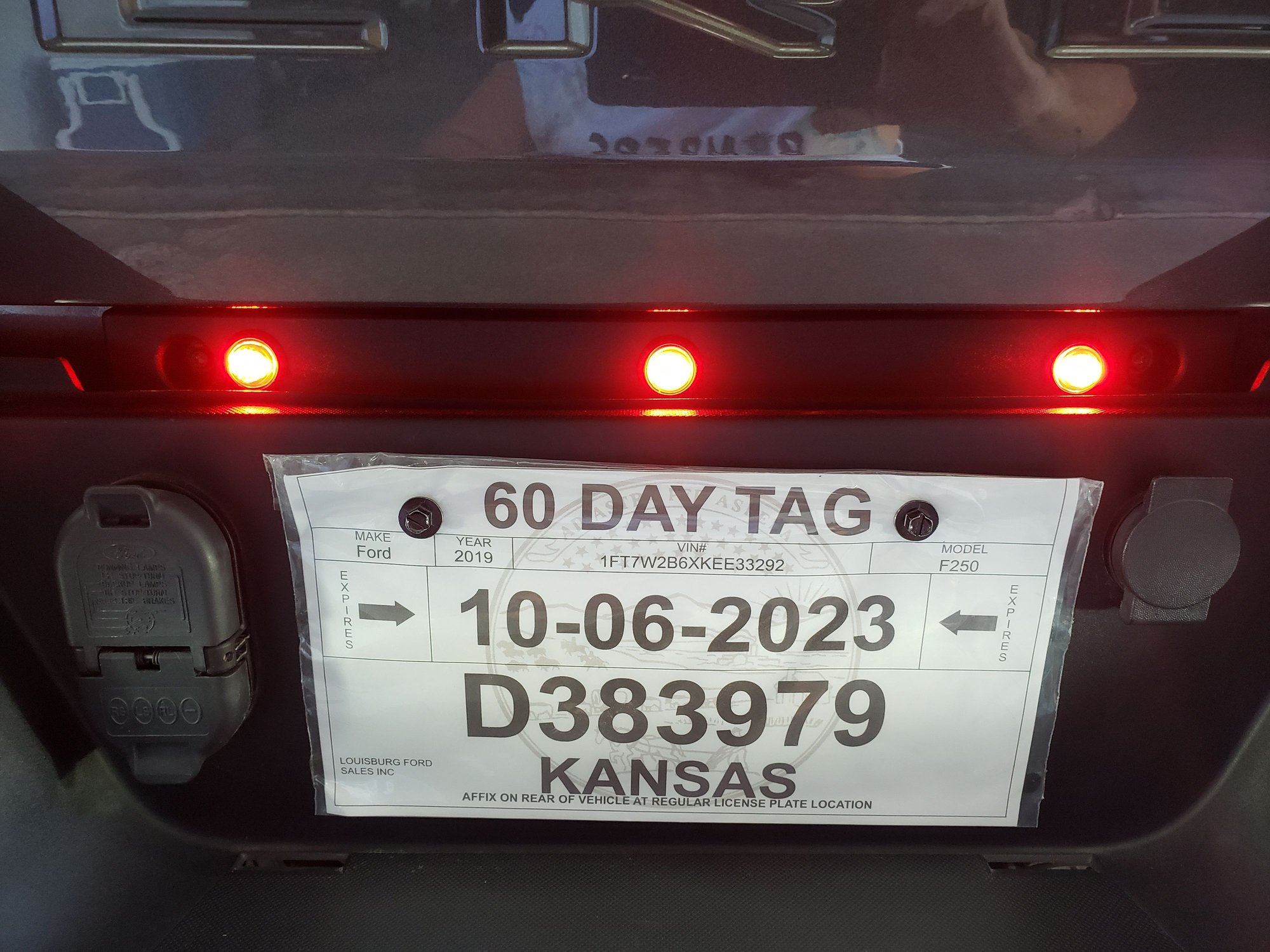

Just finished installing mine today, I bought a used oem off eBay, found the correct pigtail off of eBay that matched the oem light and ran it to the license plate light, have $50ish in it.

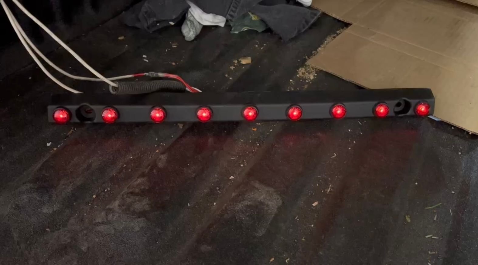

I believe I saw your post which I copied, except I have more lights and dual elements so it can act as a third (fourth) brake light. Considering the license plate for one feed. Switched those to led so the total draw should be ok.

Likes: 334
Nice job! Mine was free as the lights were sent to me a couple years ago by a fellow F150forum member. Finally had a use for them!
