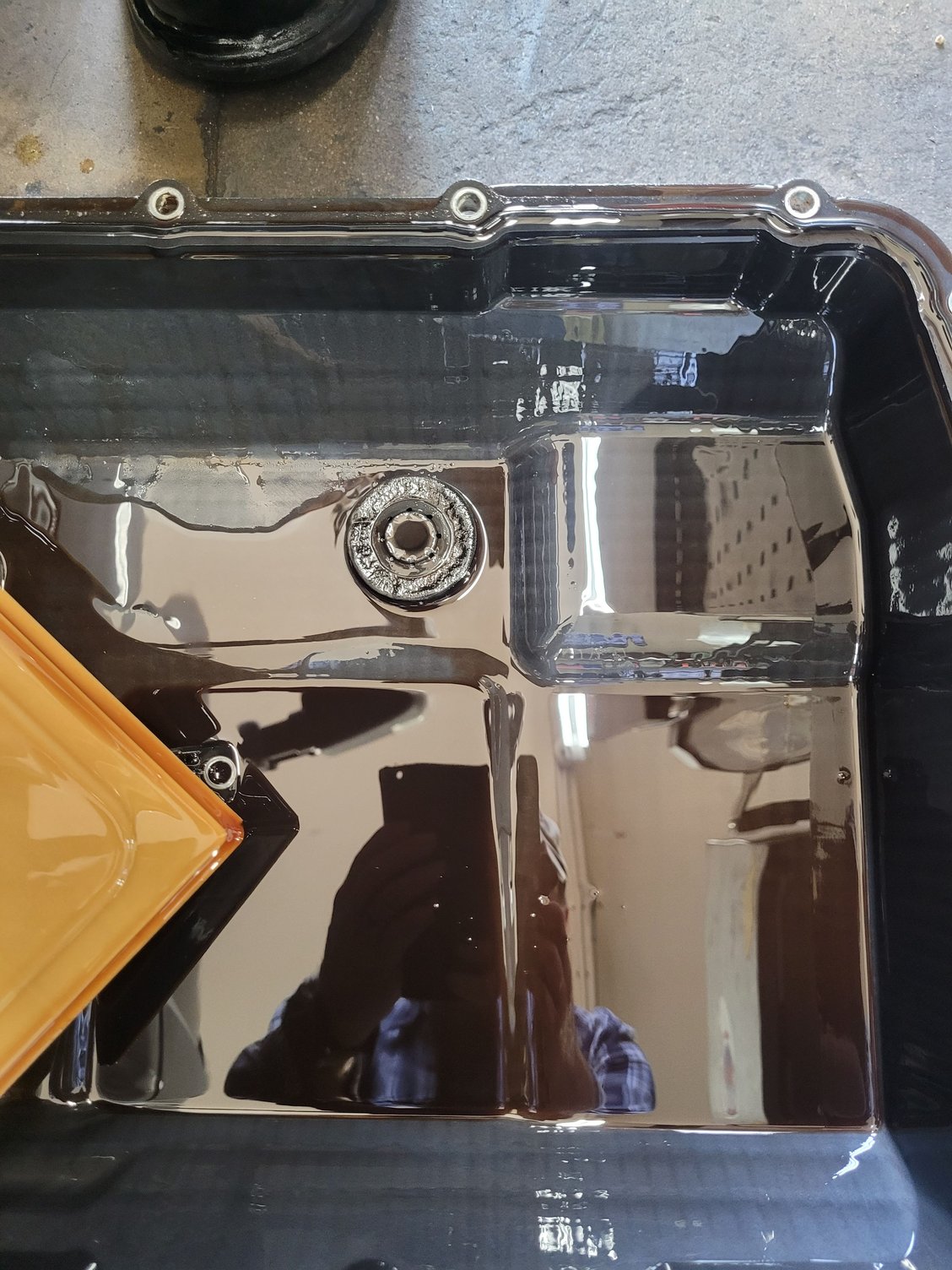

No tranny issues with heavy towing too. One tip would be to NOT follow fords recommended service interval. I changed mine recently at 62K. Here is the magnet in the pan.
you can see a layer of the break in materials on the magnet, otherwise it was fine.
