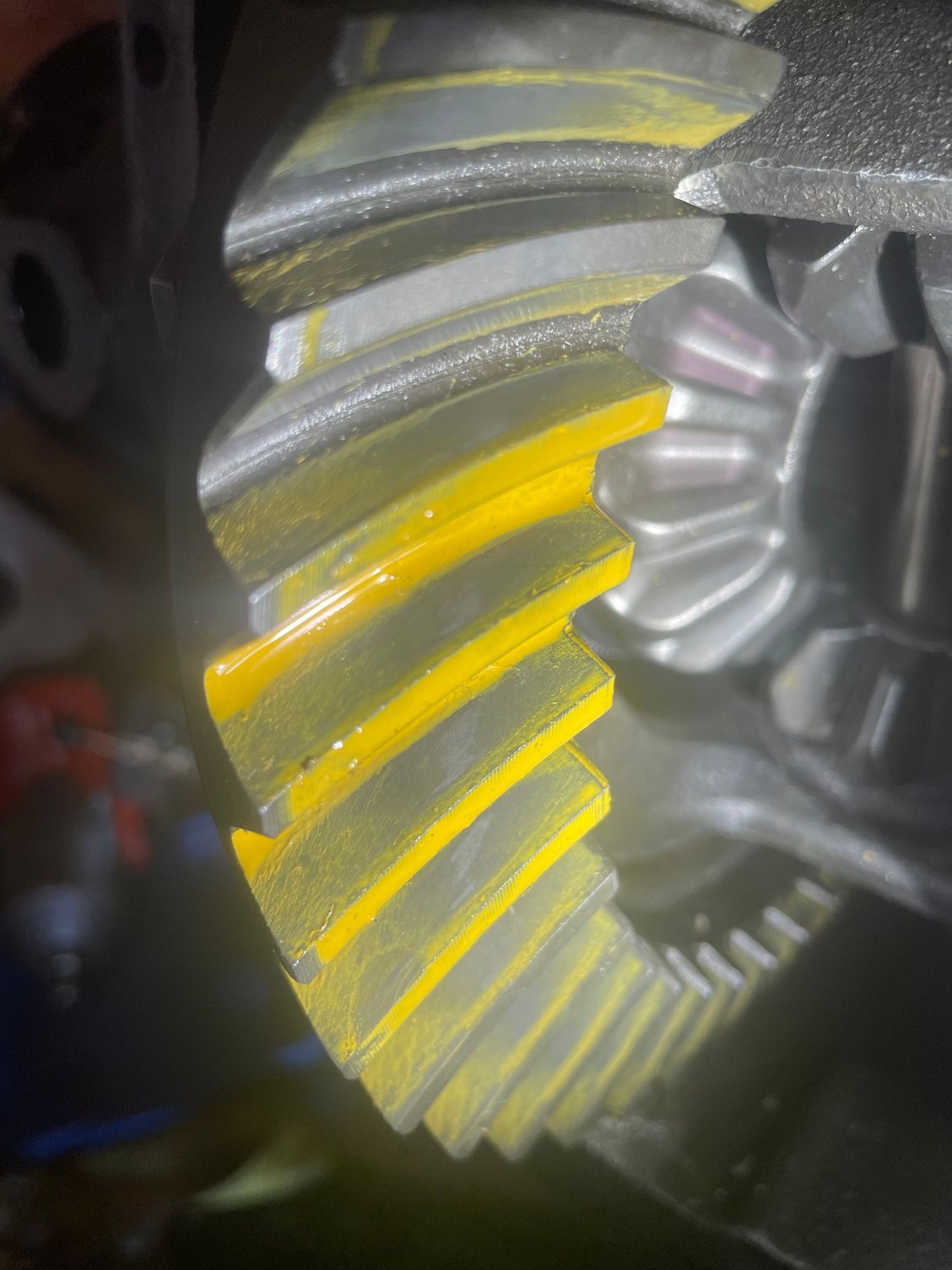

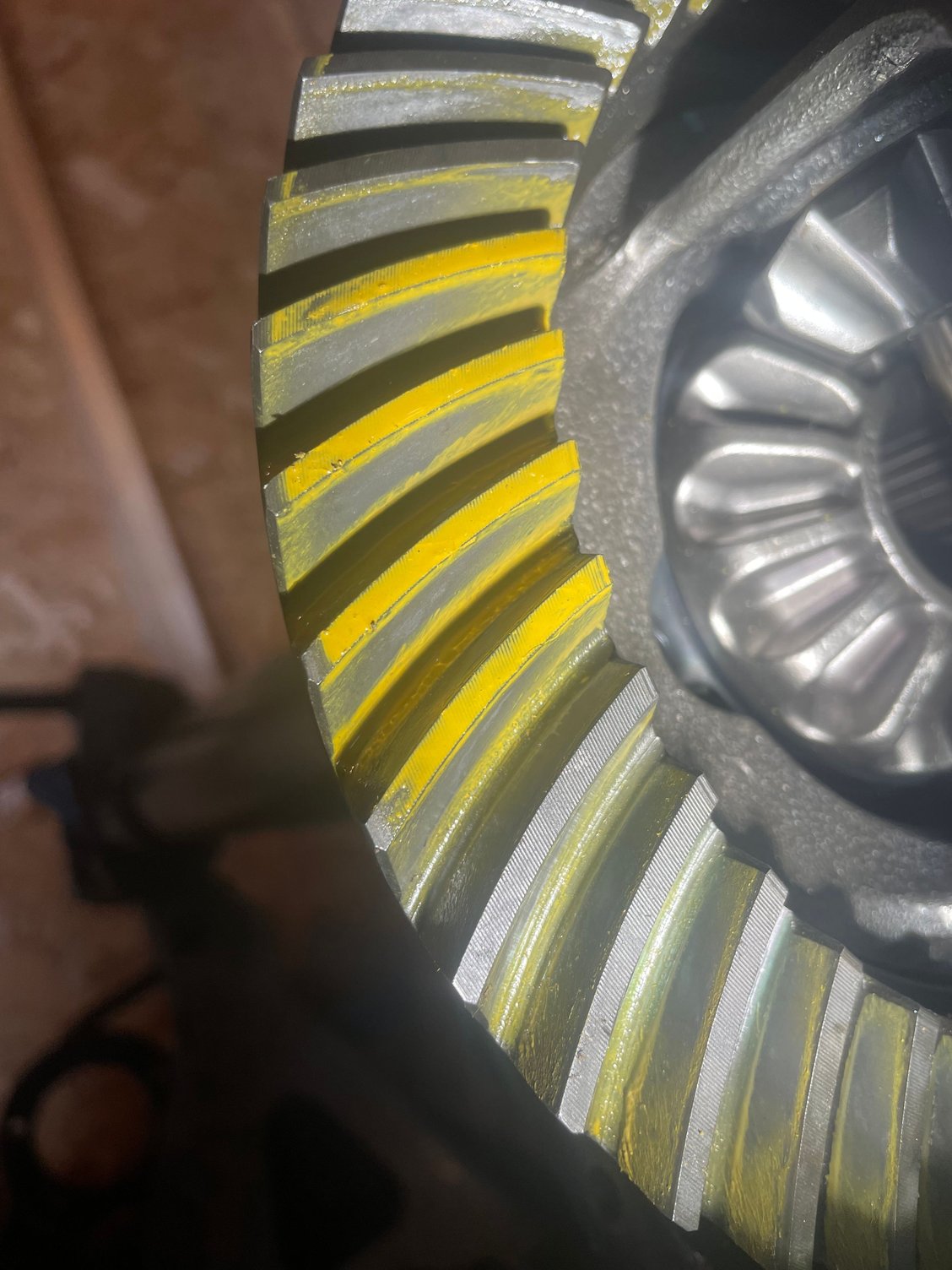

Getting going on getting a pattern for my new front Dana 44 gears. This is what I’m starting with, want to make sure I’m heading the right direction. The BL is at the lower side, .006 now. Any trained eye have some advice? I was thinking the pinion was deep so was going to pull a shim. But the coast side is so wide I wanted to make sure I wasn’t missing some other adjustment like trying the BL closer to .010
